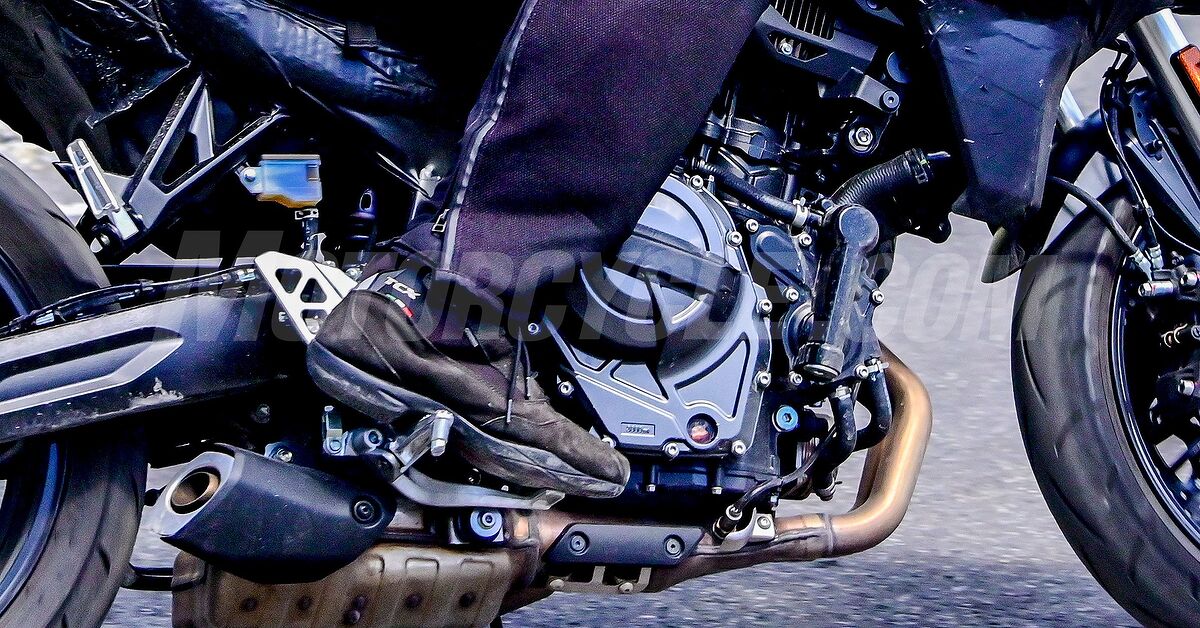

Parallel-Twin Suzuki V-Strom and SV650 Successors Spied
It's been a while since Suzuki introduced an all-new engine, but spy photos suggest the V-Strom and SV650 successors will get a parallel-Twin motor.

Last night on You Tube I saw the new twin, all taped up for concealment, being ridden in Europe, speaker was British. 700cc's with only 70 hp.
