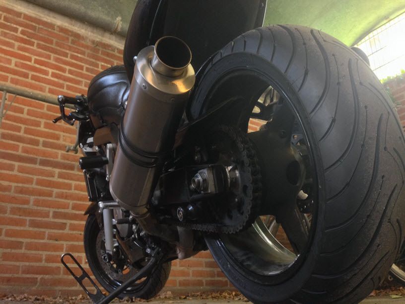

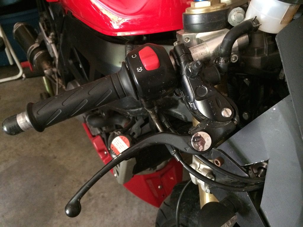

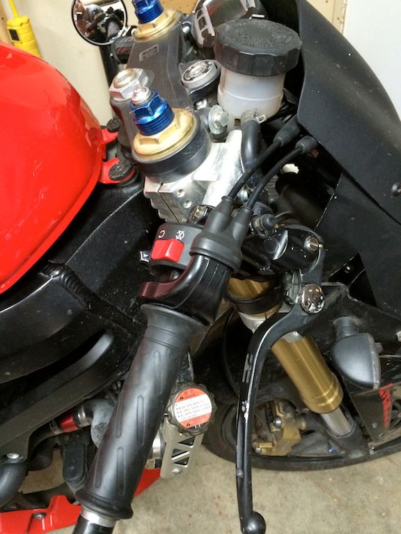

I hacked 6.5" off my Leo Vince and ordered some Chinese shorty levers. I'm all about making parts shorter apparently...
Is there a write up for that? I want to shorten the stock can and need to rebaffle while I'm at it...
