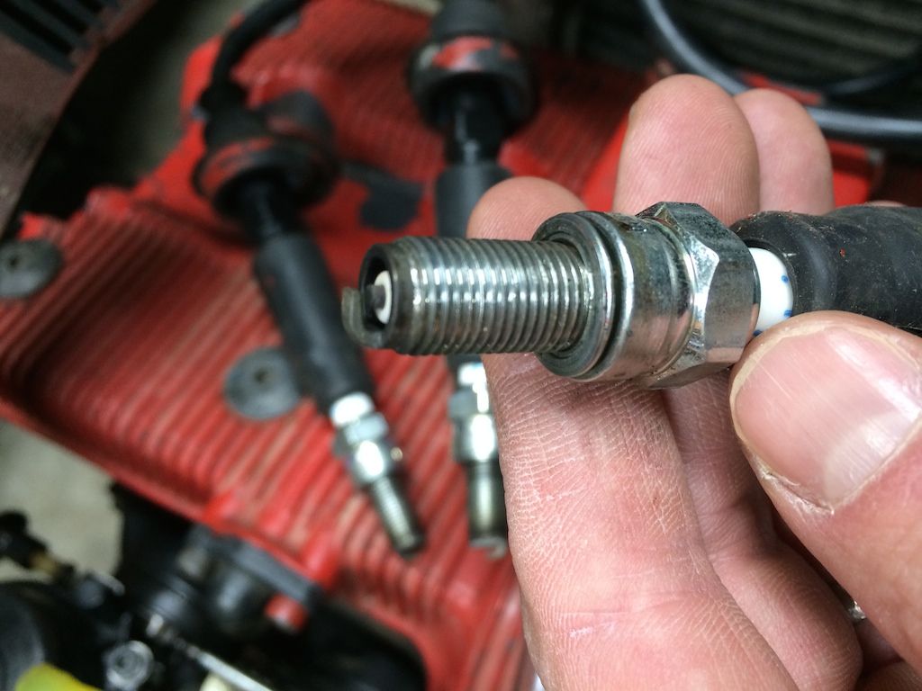

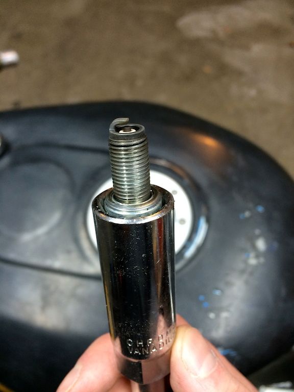

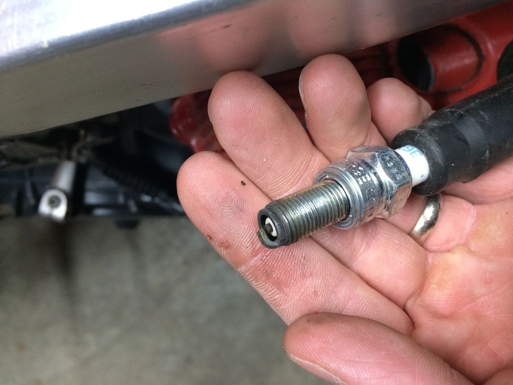

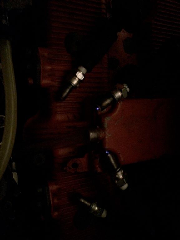

A friend of mine said he'd loan me a battery, and I picked up some NGK plugs for it also. Since the plugs are buried in the head, the plugs need the best insulation, and the NGK plugs have it. CR9E plugs for this vintage GSXR. Ran into an issue at the car parts stores getting the right size plugs. I went to two stores, and both of them had the incorrect size for the GSXR. I needed help from a friend to get the right part number.

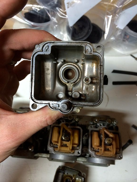

I got into the carbs, and yes, they are a mess. But first, a little backstory related to the carbs.

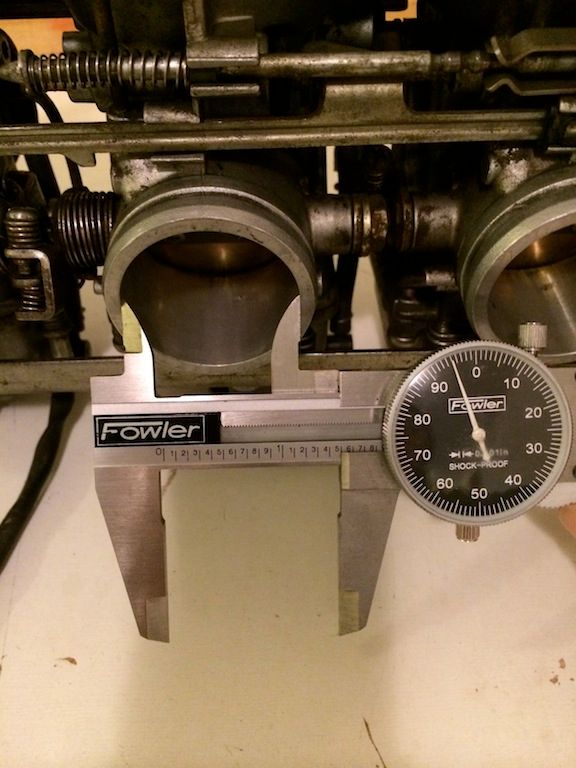

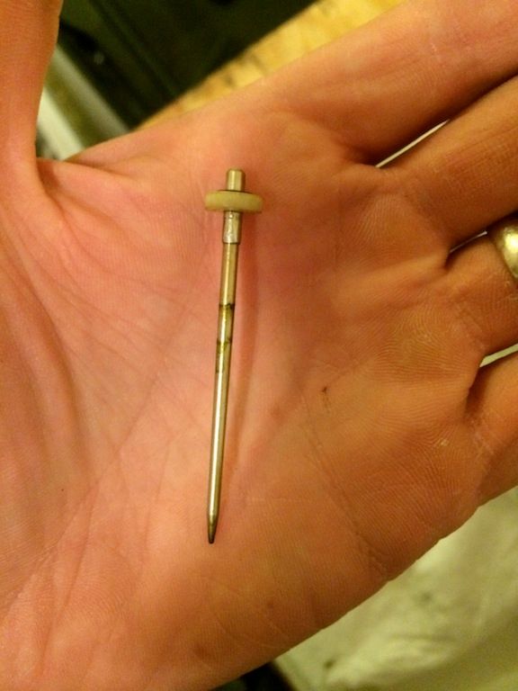

The previous owner thought the Boiler was an RR version from '89 because the guy he bought it from said it was. The RR is supposed to have a braced swing arm, shortened subframe, longer stroke in the engine, and 40mm carbs. Looking at the CL pics, it didn't have the braced swing arm or different subframe. Anyway, while it would have been pretty cool to get my hands on a RR, for the price I didn't care if it was the regular '89 750.
Needless to say, I was pretty curious, so the first thing I did when I took the carbs off was measure them. This is what I found:
An inch and a half translates to 38mm. I measured it several times to make sure that is what it was, since a regular '89 750 has 36mm carbs. No matter how many times I measured, it was still 38mm. A quick google search showed 38mm carbs started being used on '90 gsxr 750's until FI came into play. WTF! I was very confused at this point. So, I checked the frame serial number and the engine serial, and you guessed it, the frame is a '89, and the engine is a '90. So at some point in it's past, another motor was put into the Boiler. Well, a year newer engine ain't so bad :)

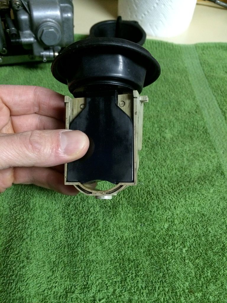

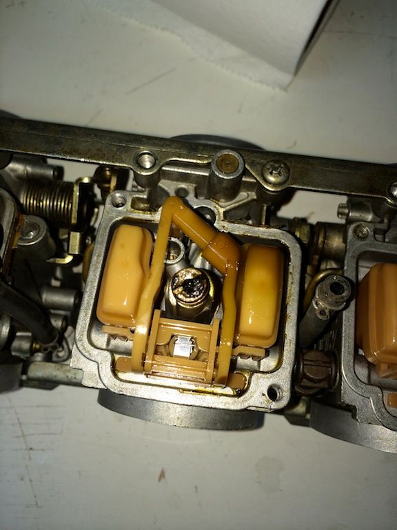

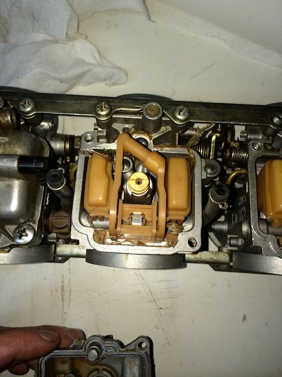

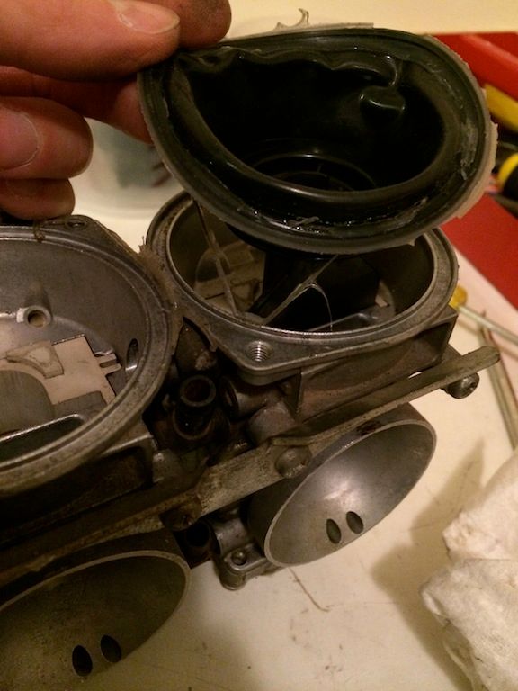

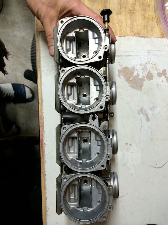

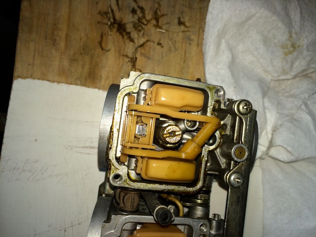

Onto the carbs. I just wanted to open up the caps to check the diaphragms and jet needles, and the bowls to check for gelled fuel and see how the main jets were.
I pulled off the first cap, and this is what I found.

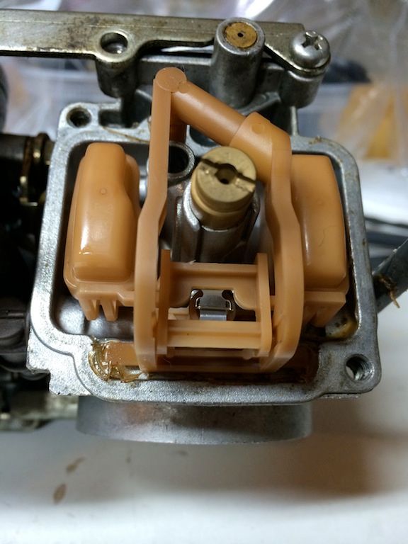

Another WTF moment. Looks like someone siliconed around the diaphragms to make sure they had good vacuum, I guess. All of them were like that. Not sure yet if I'll have to replace the diaphragms. The needles look OK, but all of them do have some crud around them. This is the needle out of carb #3, which was the worst looking needle.
At this point, I'm thinking I'm getting off pretty easy for a 25 yr old bike that's been sitting for 3 year. Then I opened the bowls.

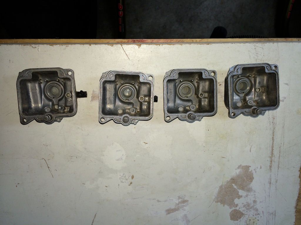

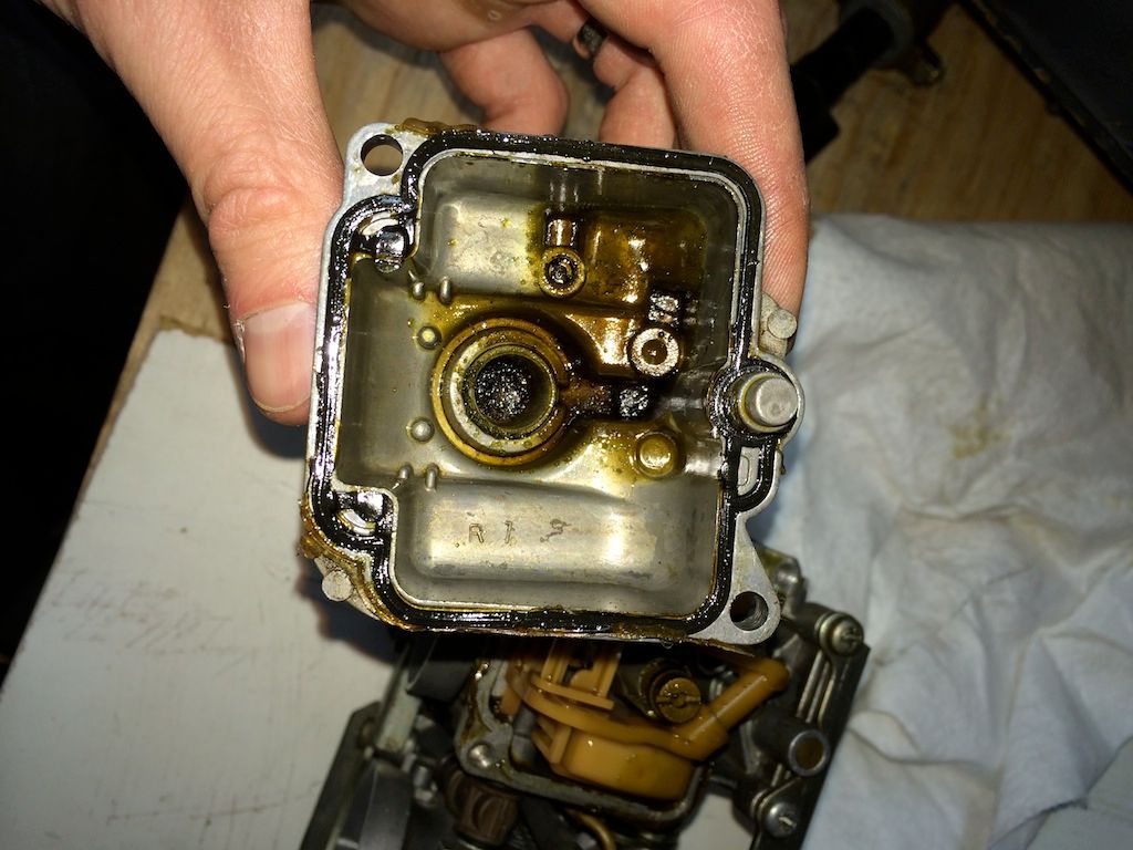

Bowl and Jet #1
Not too bad. How about #2?

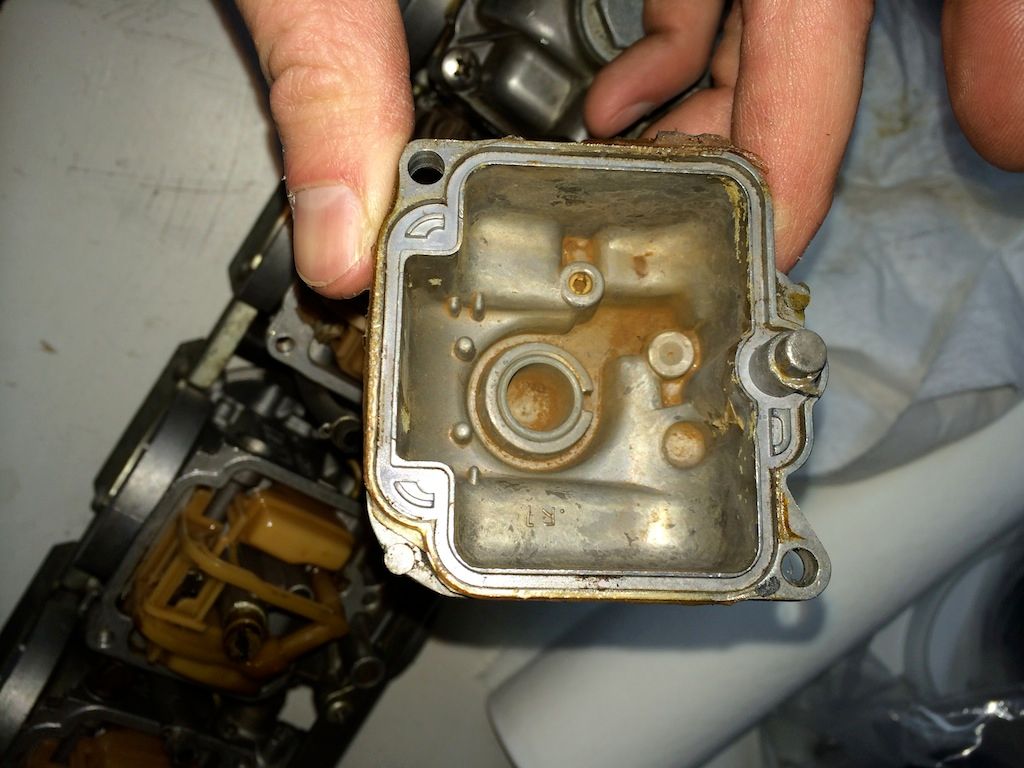

Pretty F-ing gross! Luckily, that was the worst one.
Bowl and Jet #3

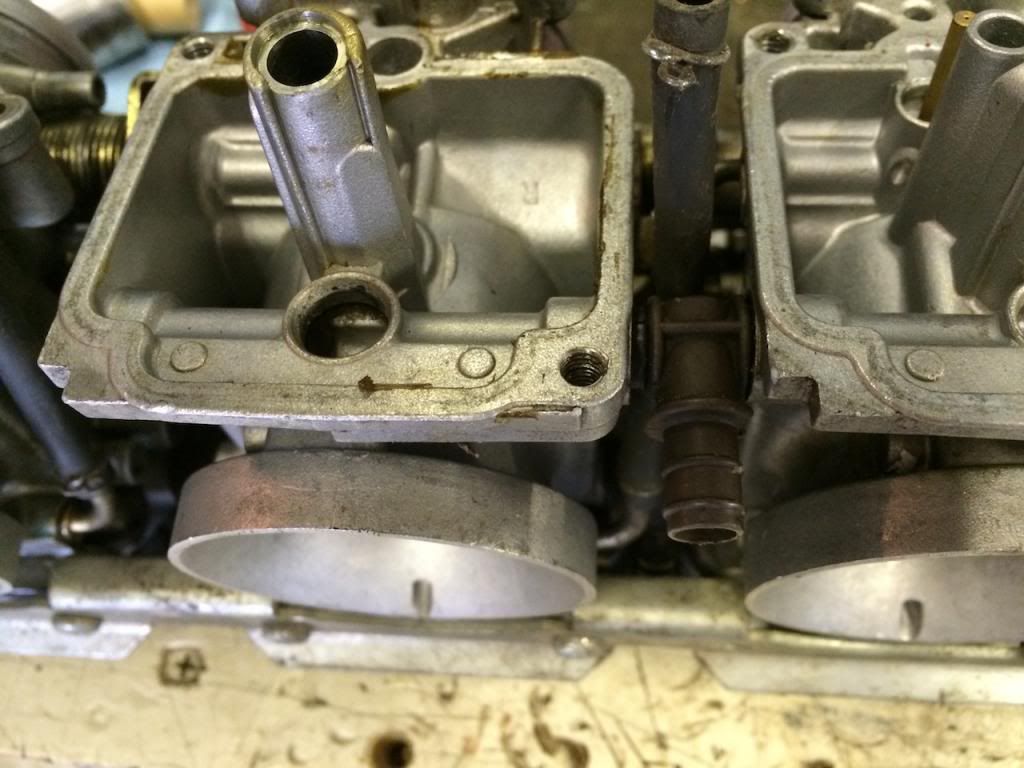

Bowl and Jet #4
And I'm sure you noticed all the crap around the edges of the bowls. Yep, someone siliconed around the rubber bowl seals also. Here's the pile of silicone I pulled off of the bowl edges.
Wow, I've got my work cut out for me! In the meantime, yesterday I brought the carbs down to my friend who runs a shop, and he's going to check them out and see what needs to be ordered.

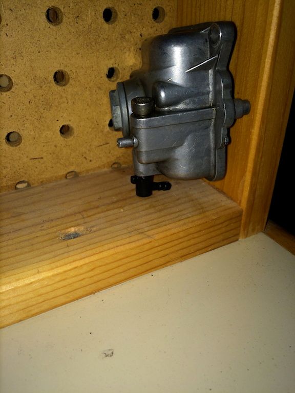

Also went down to my friend's shop and he helped me tear down the carbs, since this was my first time tearing carbs down. First, he determined the diaphragms are still good, so dodged that bullet. But, ran into 2 other issues.
First, the emulsion tubes are slightly egg shaped. But, figured if I run the stock airbox, they won't be a problem now, since the priority right now is just to get it running. But, I want to put pods on eventually, so when I do that, I'll have to drop the extra coin to replace the emulsion tubes. Here's a crappy cell phone pic of one of the emulsion tubes. You can kind of tell it's ovaled.

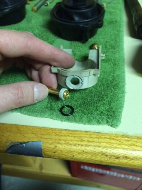

Second, we did a pressure check on the fuel intakes into the bowls. We just put a tube on the brown intake where the fuel tube goes, plugged the ports in the carb bowls where the needle float valve goes, and pumped up the pressure. Sure enough, the pressure dropped. That means the O rings where the fuel intake goes into each carb is shot. I could also see a crack in the O ring going into the #3 carb.
Unfortunately, that means I'm going to have to split the carbs to replace those O rings. No idea when I'm going to get that done, since I've been working hard on the wife's honey-do list. Anyway, going to order the carb rebuilt kits and O rings tomorrow, so hopefully have them by next weekend in case I have a couple free hours.

I decided not to split the carbs. If it starts leaking when I run some gas through it, I'll figure it out then.

So this was the Summer of the Carbs for me. In what little spare time I did have, I spent cleaning those things. First up was the bowls. Remember all the silicon and gelled gas?

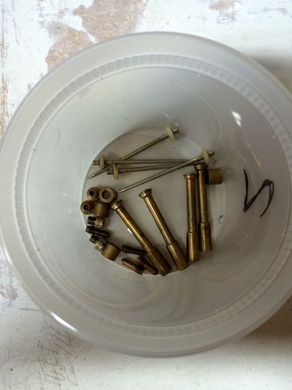

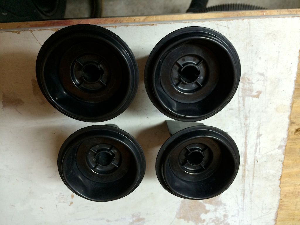

Then all the jets, needles and tubes. Clean!
I went after the top sides after that.
I spent 4 nights in a row picking all that f-ing silicon off the diaphragms. But, Tada!

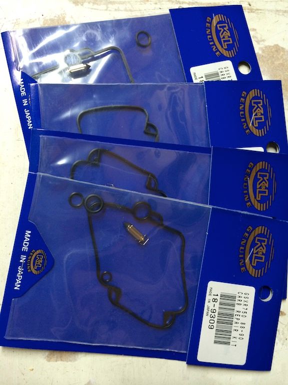

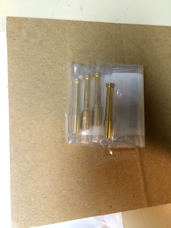

Then I got a special delivery...
...and put those suckers back together. I don't think I've spent that much time cleaning anything before in my life.

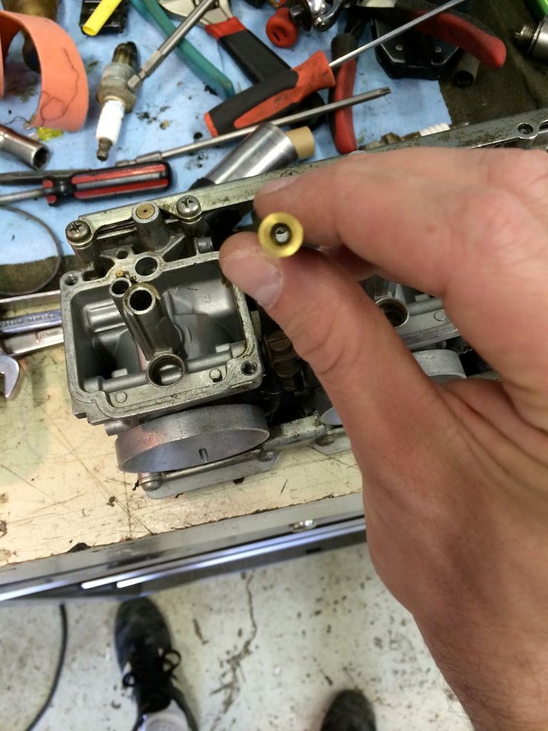

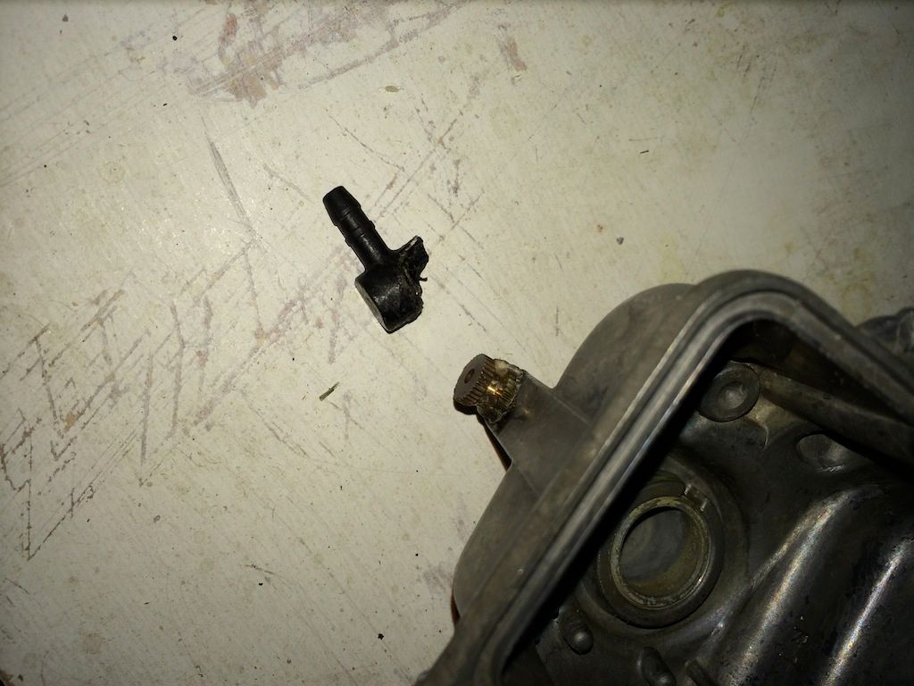

I also learned another little tidbit about this bike. Remember it's a '89 frame with a '90 motor with the 38mm carbs. The 38mm carbs that year came with the power jet circuit that has a small little jet in the bowl, leading out to a 90 degree plastic fitting and a rubber tube. The function is to suck a little extra gas up into the air flow above roughly 11,000 rpm. Anyway, one of the 90 degree fittings is broken.

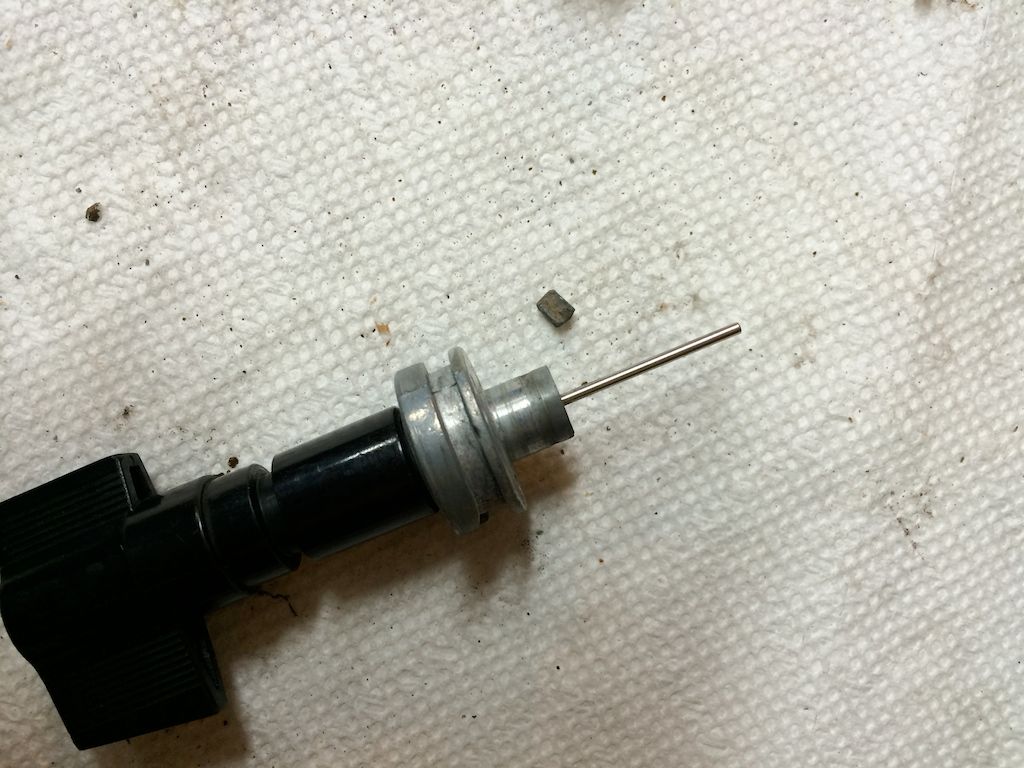

I spent way to much time trying to find a new 90 degree fitting, with no luck. But, it ended up not mattering. I pulled that jet out of the bowl to get it clean, and no matter how hard I tried, I couldn't get the jet open. Well duh, the closer I looked at it, the more I realized the jet didn't have a hole. After a ton more research, I finally came across the fact that in 1990, the power jet circuit on the US models was fitted with a size zero jet, meaning no hole. But, for some reason, the Canadians had an activated power jet. No idea why.
Pic of the "size zero" jet.

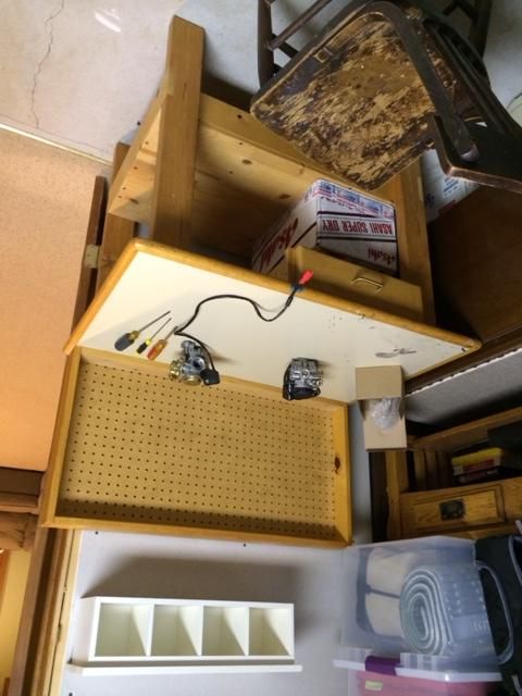

My Father-in-Law and I got that door in, and well, I guess I do have to say my wife has good taste. I still have to insulate around the sides and top, but it's still Summer, so I've got time, and more important things to do :)

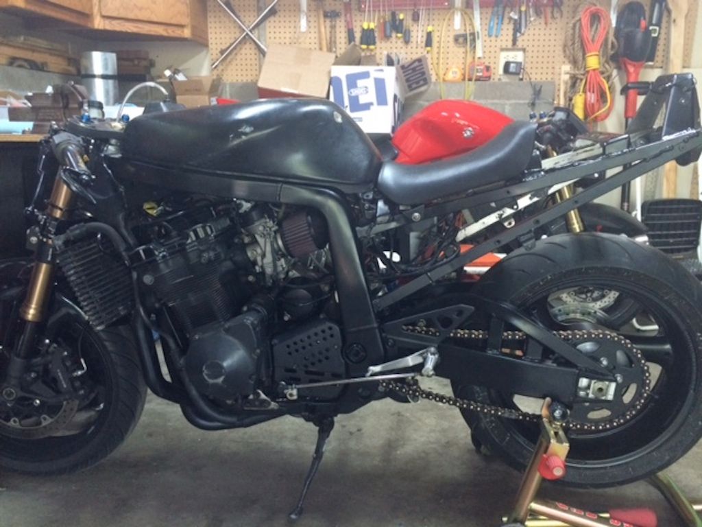

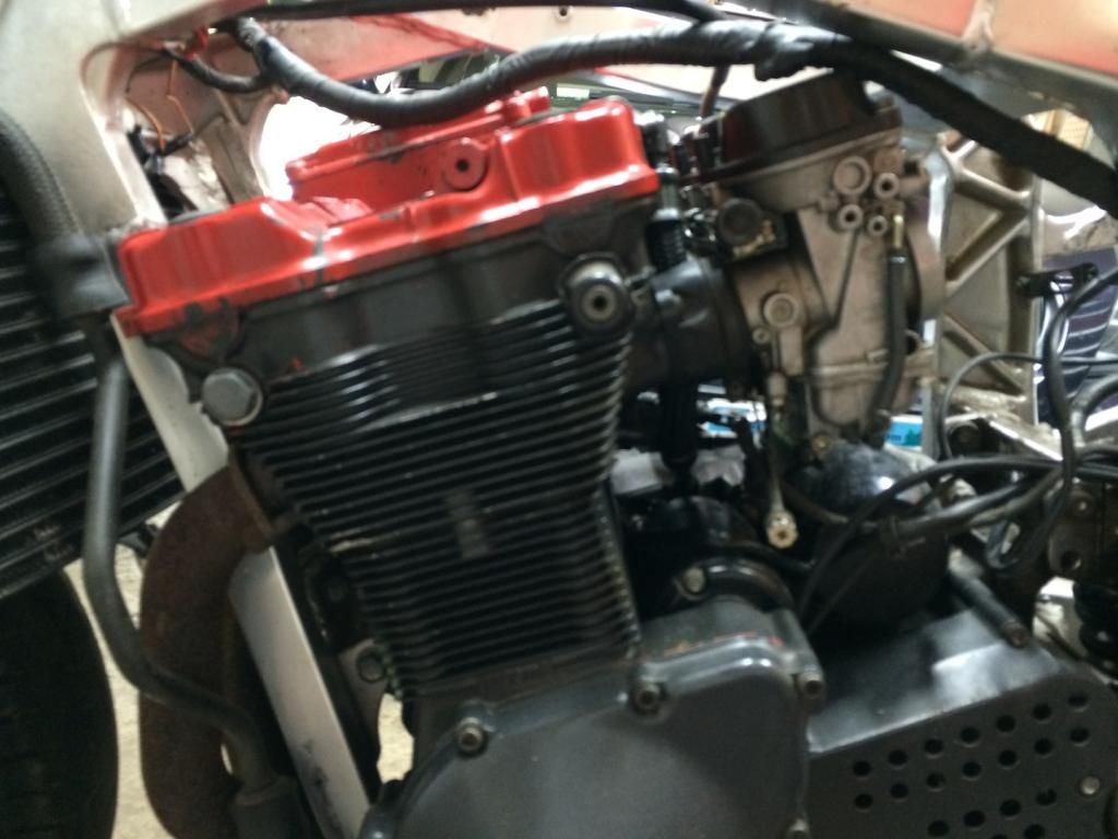

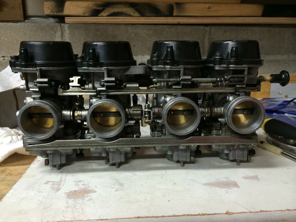

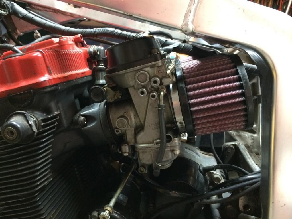

First things first, those sparkling clean carbs needed a home, so I put them there. Remember everyone, it is a ton easier to hook up that throttle cable at the handle than the carb! So undo the handle connection before hooking it to the carb.

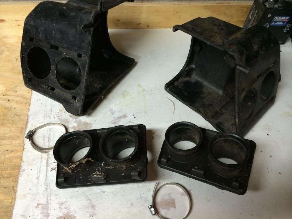

I debated about using the stock air box. Seems there's as much polarization b/t air box users and aftermarket filter users as there is b/t the Democrats and Republicans. But, the air box did come with the bike, so I thought I'd give it a shot. But, no filter was in it, and this is what it looked like.
Like hell if I was going to futz around with getting those 2 halves back together with an air tight seal, buy a new filter for it, and then have to deal with getting the carbs in and out of that tight space while getting it tuned right. Also, it just happened to be my birthday recently, and I gotta love my mom. She still gives me money on my birthday, bless her. That money just happened to be enough for a set of dual K&N's. I know I'll have a bit more tuning to do with the carbs, but the ease of getting the carbs out now is more than worth it.

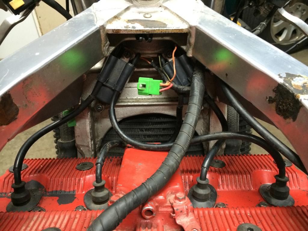

I started looking around for the next thing to do to the Boiler, and what caught my eye? Up on my shelf, those coils I bought a few months ago. Well crap, time to put those things in. At this point I printed off the wiring diagram so I made the connections correctly.

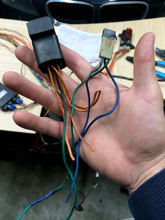

Since I had a fresh copy of the Schematic, I decided to go through the harness and look for potential shorts. Also, you've seen the front of the harness hanging off the bike. I thought it would be a good time to start identifying the connections by wire color. Well, judging by the condition of a few of the connections, along with a broken off steering stop, it was pretty evident this bike had been in a front end collision. I checked the fork tubes and wheel, and there's no evidence of damage to them, so I'm assuming a new front end has been put on it also.

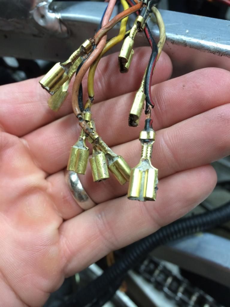

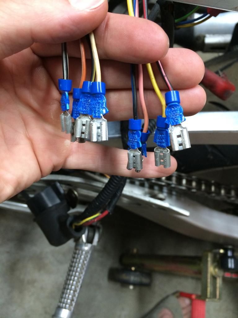

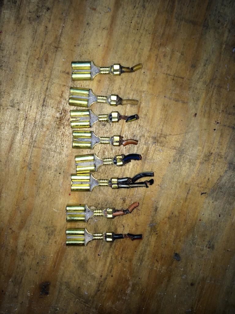

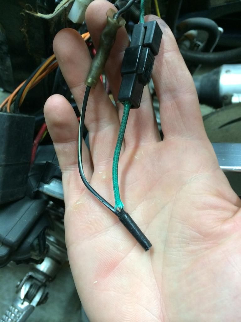

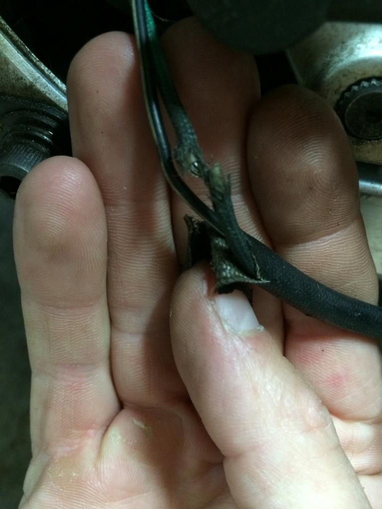

Back to the wiring. Aside from the wrecked connections, the harness was looking in pretty good shape! That is, until I got back to the CDI box. The wires in the plugs seemed pretty flimsy, so I took the wires out of the plugs for a closer look. Man, looking like it's 25 years old.
I decided to cut back the wires to good insulation and put new terminals on. Here's a closer look at the old terminals cut off. Many cracks in the insulation.
And the new terminals.

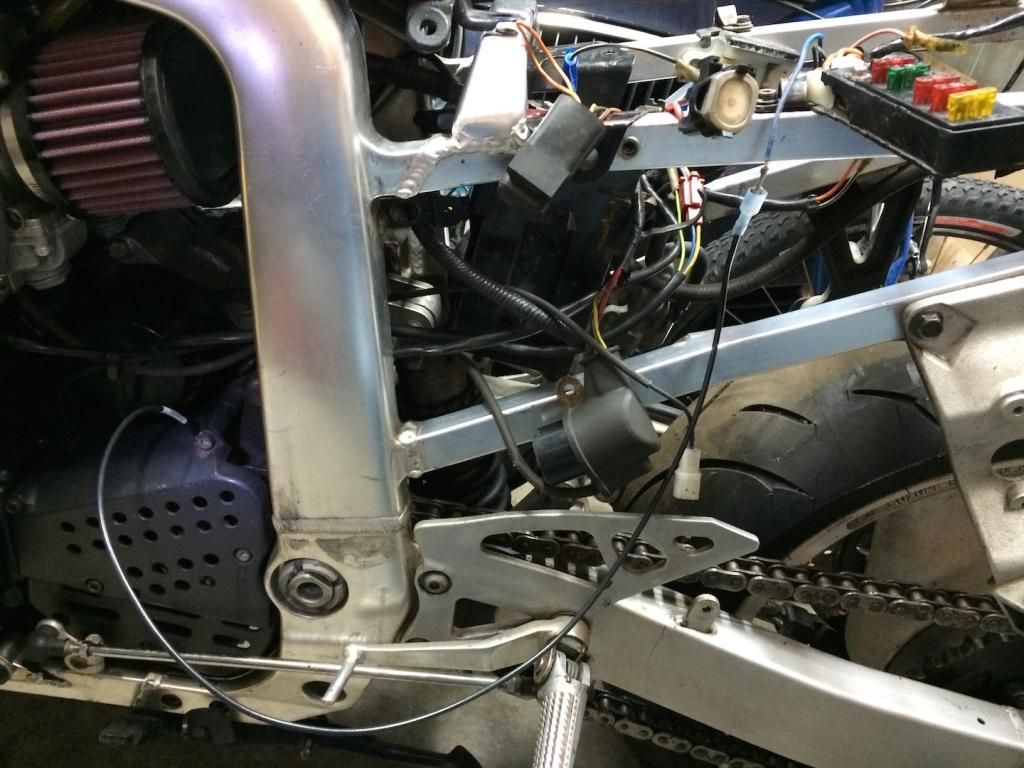

I also installed the new to me CDI box. I'll have to figure out a weather proof option for the new terminals since they don't really fit in the old plugs well. But, for now, I just wanted to make sure I didn't have any shorts that would prevent it from starting.

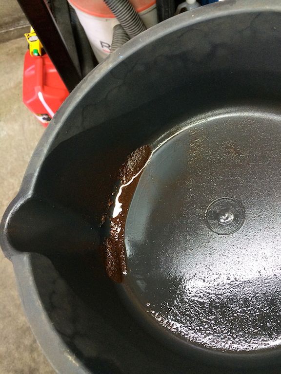

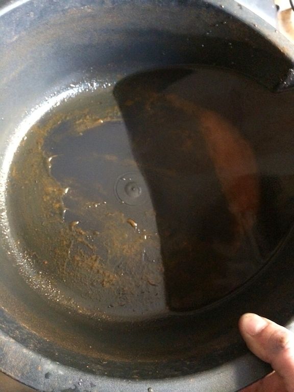

Now it was time for an oil change and new oil filter. I drained the oil into my drain pan, and had to do a double take. It looked like glitter in the drain pan! I always try to keep the pan clean so I can look for this type of thing at oil changes. I don't know, maybe the motorcycle fairies were having a glitter fight inside my engine??

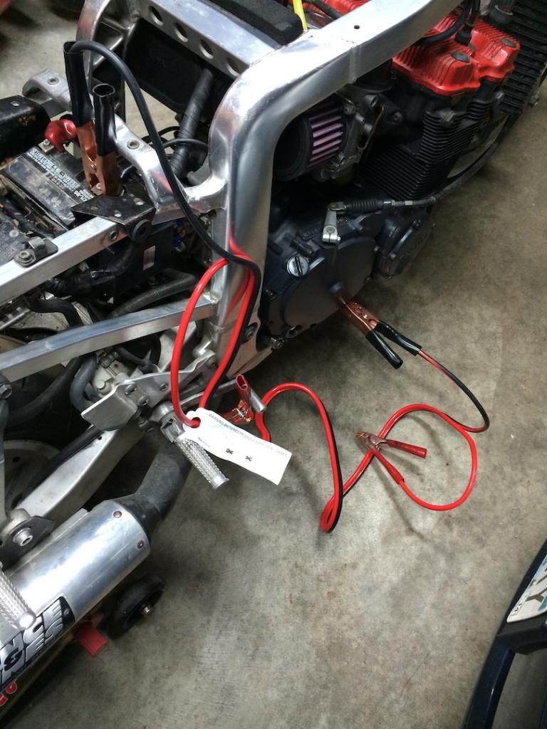

Good thing I changed the oil. Anyway, so now I was getting excited. I'd been slowly marching towards trying to start this thing since the beginning of Summer. I couldn't believe I was so close now. First I wanted to make sure the electrical was good, so I hooked up the battery, and since I didn't have a key, made my own key :)
So, with the battery in, and my "key" hooked up, verified I had power to the system by the instrument lights, and I gave the starter a push.
NOTHING :(
Absolutely nothing happened. I was expecting the starter to roll, but nothing. I got a little frustrated at this point and walked away from it, came back a couple hours later and sat down next to it, and started checking through the wiring again. I missed something the first check, but found it this time. The side stand switch harness had a kink in it right where it goes between the sprocket cover an the engine. Didn't look good.

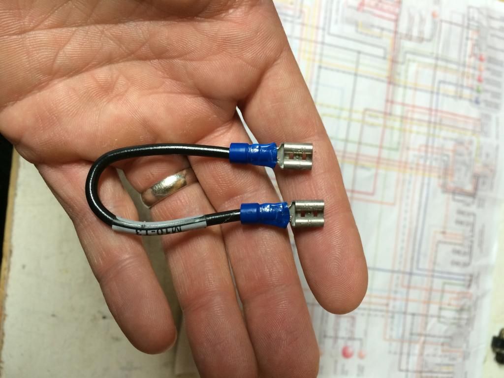

I didn't what to f around with the side stand switch, so, I bypassed it :thumbsup:
Gave the starter another try, and NOTHING. Damn!
At this point I was thinking the starter solenoid might be bad. But, with the power on, I could jump the solenoid terminals with a screw driver. So I checked the voltage across the small plugs on the solenoid while I had the starter pressed.
Guess what? The starter rolled! WTF! How could the Multimeter be helping the starter to work? Anyway, I talked with my mechanic friend and right away he told me the battery ground was bad. I wanted to verify that, so I got the jumper cables out of my trusty minivan and made a ground bypass.
And the starter rolled! OK, so I was narrowing it down. About this time I noticed the battery ground had a lead out of it very close to the terminal that connects to the battery, with a plug and wire that went into the harness. It looks like it had been messed with, and the wire color doesn't match from one side of the plug to the other. Anyway, on a whim I unplugged it, and with my ground bypass jumper cables off, gave the starter a push, and BAM, the starter rolled! Hot Damn! I know that wire out of the battery ground is stock, but I'm thinking whatever it connected to through the harness is toast, possibly one of those wrecked connections at the front.
In the meantime, I was pulling in the clutch every time I pushed the starter. Every once in a while, the starter wouldn't roll when I knew it should have. I'd let the clutch out, pull it back in, and then the starter would roll. Didn't want to F around with that switch either, so adios! Clutch switch bypass!
Damn, so much sh!t going bad on this thing! I finally decided to put the fuel lines on (bought new fuel line), hook up the gas tank and give it a go since the starter button was working reliably now.
Wouldn't you know, the damn thing started!!

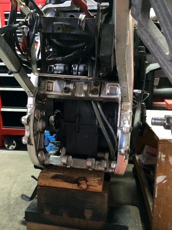

I've been plugging away at this thing. On that test ride around the block, besides there being no umph in the bottom end, she was pulling to the left like an SOB. Here's why.

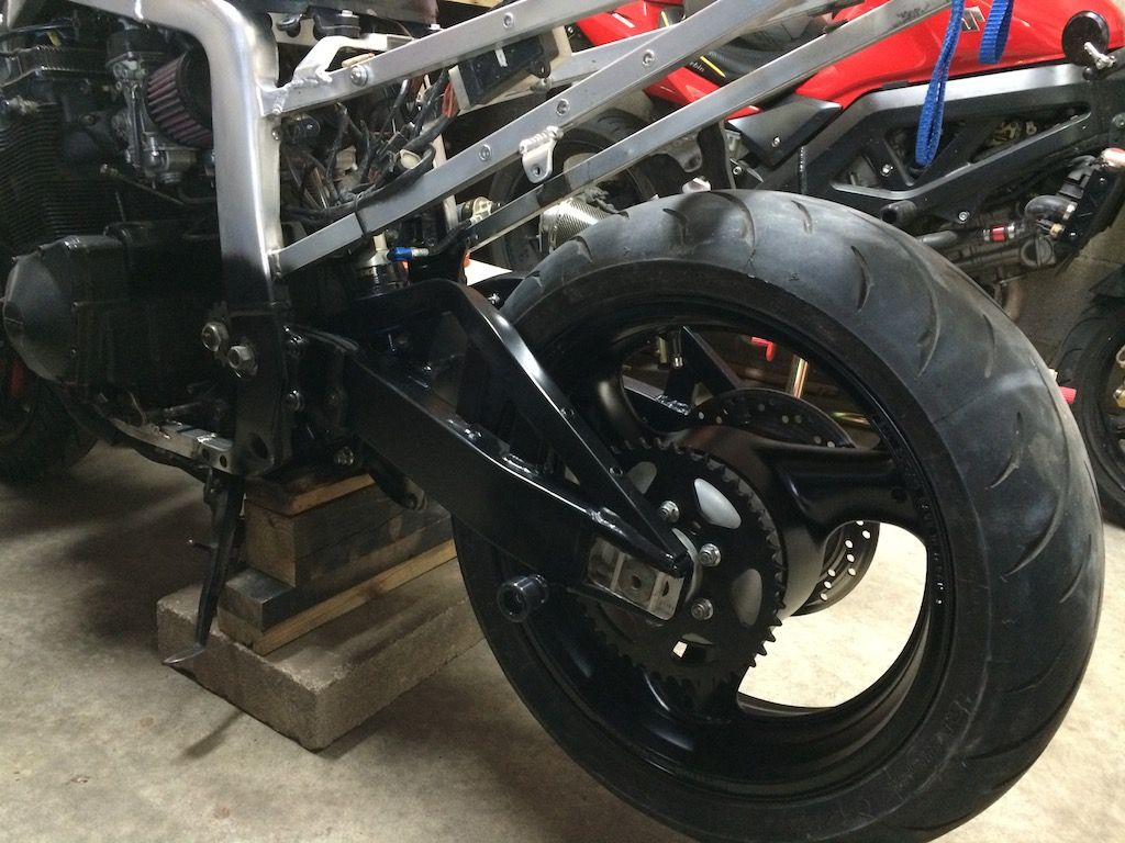

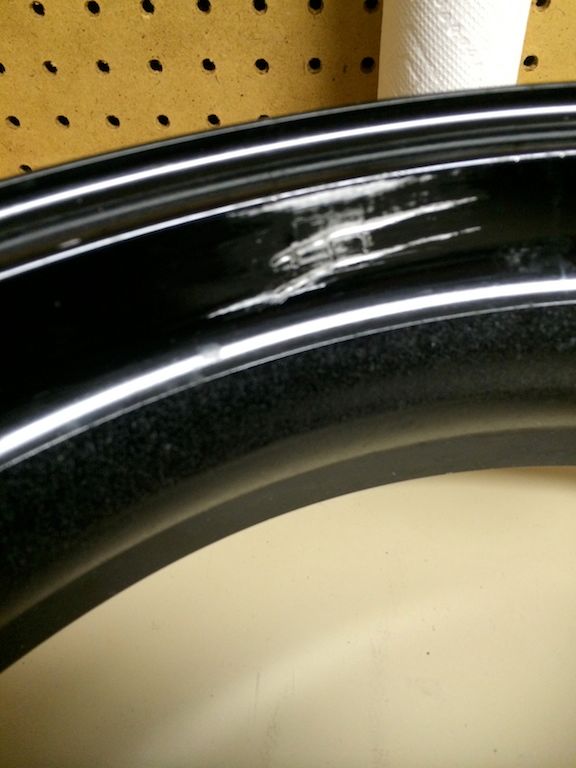

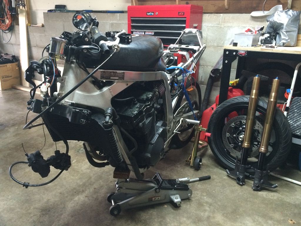

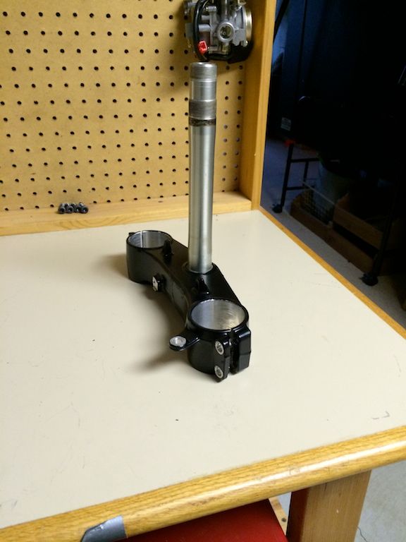

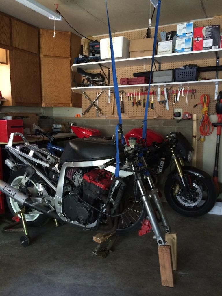

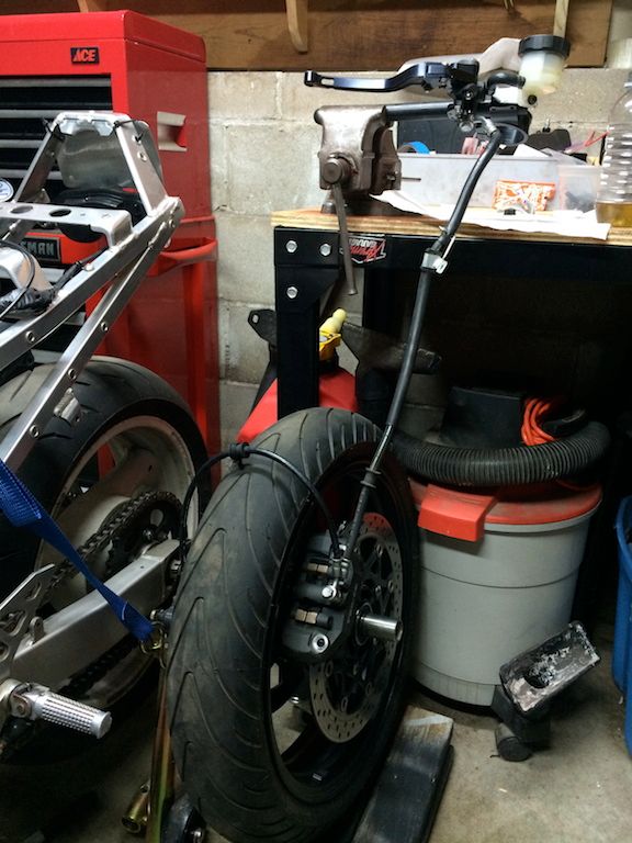

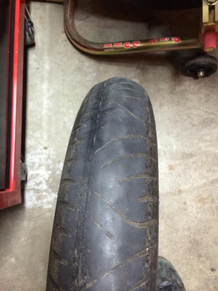

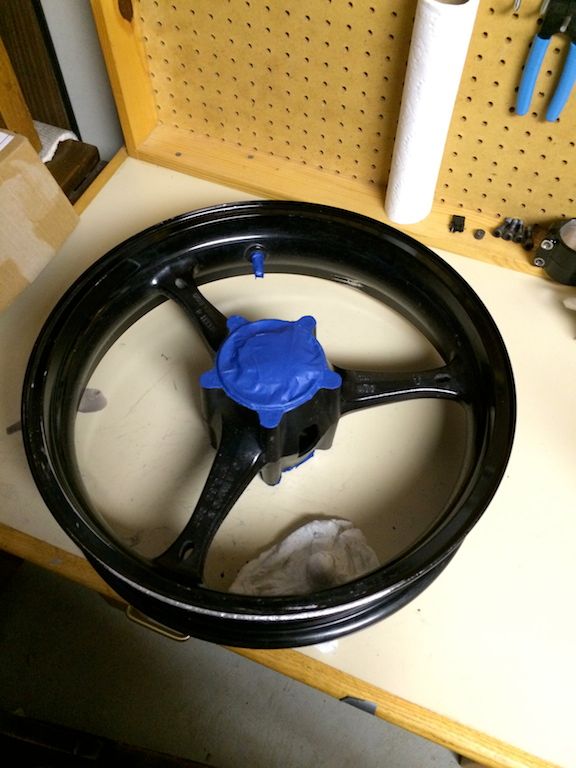

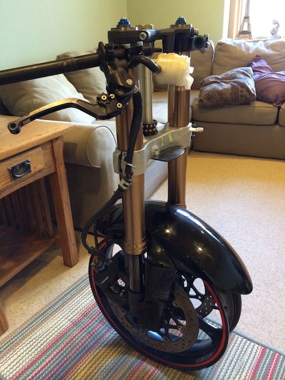

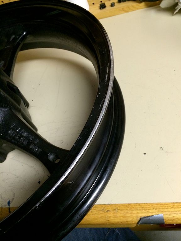

I have no idea how the PO got the front tire like that, but anyway, it had to go. I've been pretty much converted to Michelin with the SV, so Michelin it is for the Boiler. I ordered the cheapest Pilot Road for it, a PR2. Still a good tire, but minimal invested in case I do a front end swap in the near future.
I knew I should have gotten a front stand at the beginning of Summer! Jacking up the front of the Boiler turned out to not be as easy as the SV, mainly because the center of gravity is a little further forward on the Boiler, and the exhaust is right in the way. So, instead of pulling the exhaust off, I got a little creative with some 2x4s and tie down straps.
Luckily the thing didn't fall over, although getting it off the 2x4s was a little tricky. But here she is with new rubber on the front, and safely on the ground. My garage faces East, so here's a nice sunrise pic :)

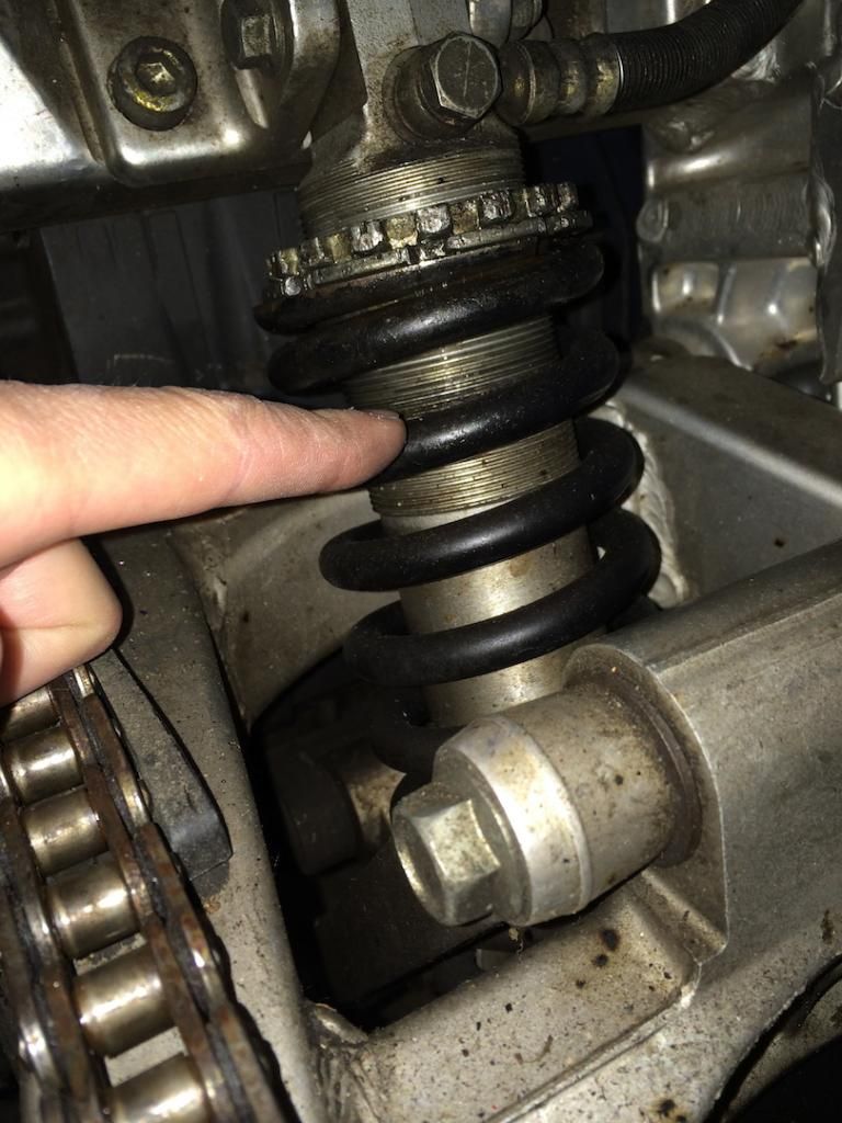

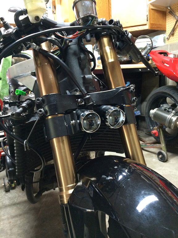

One thing that was bugging me since I brought it home, amongst the many things bugging me about this thing, was that the rear suspension was rock hard. I couldn't get the rear to sag a millimeter, even when jumping up and down on the pegs. The PO was a skinny guy, maybe 160, so unless he was carrying a few extra people, I have no idea why he had the shock cranked down so much. Heres a pic after I adjusted it to my weight (heavier than the PO), and where I'm pointing, at the smutz on the threads, is where the PO had it cranked down to.

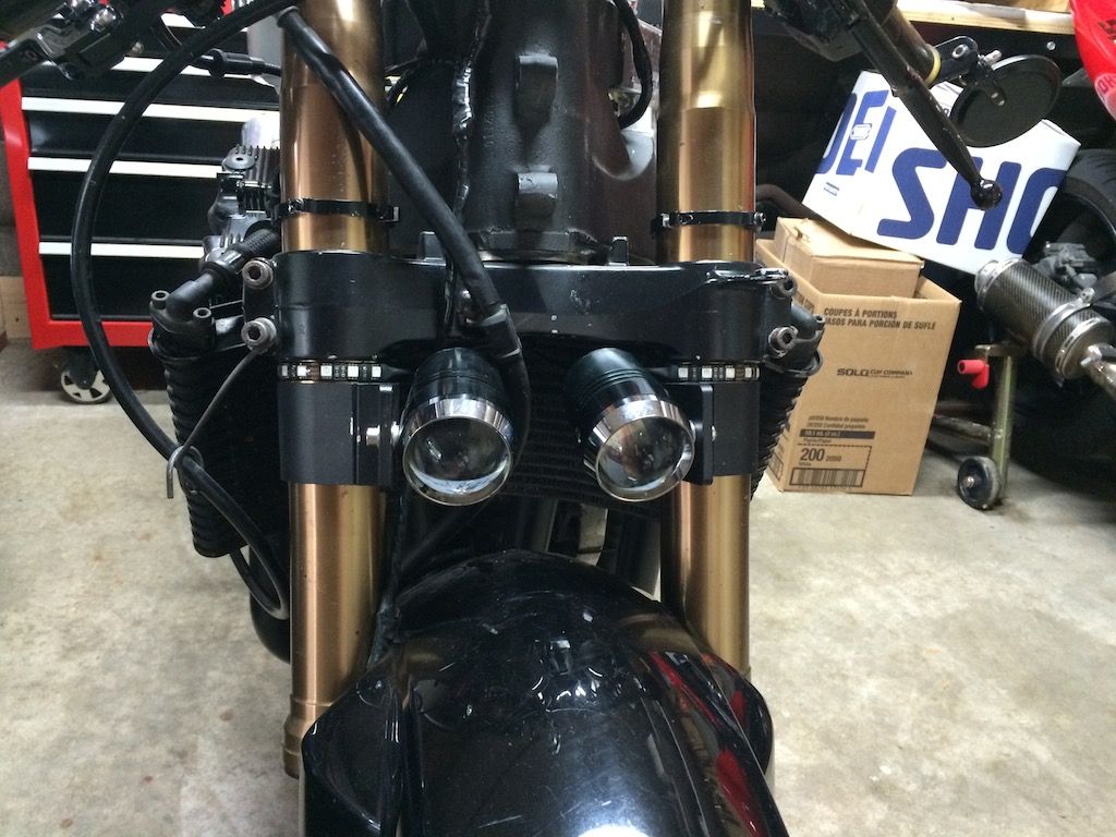

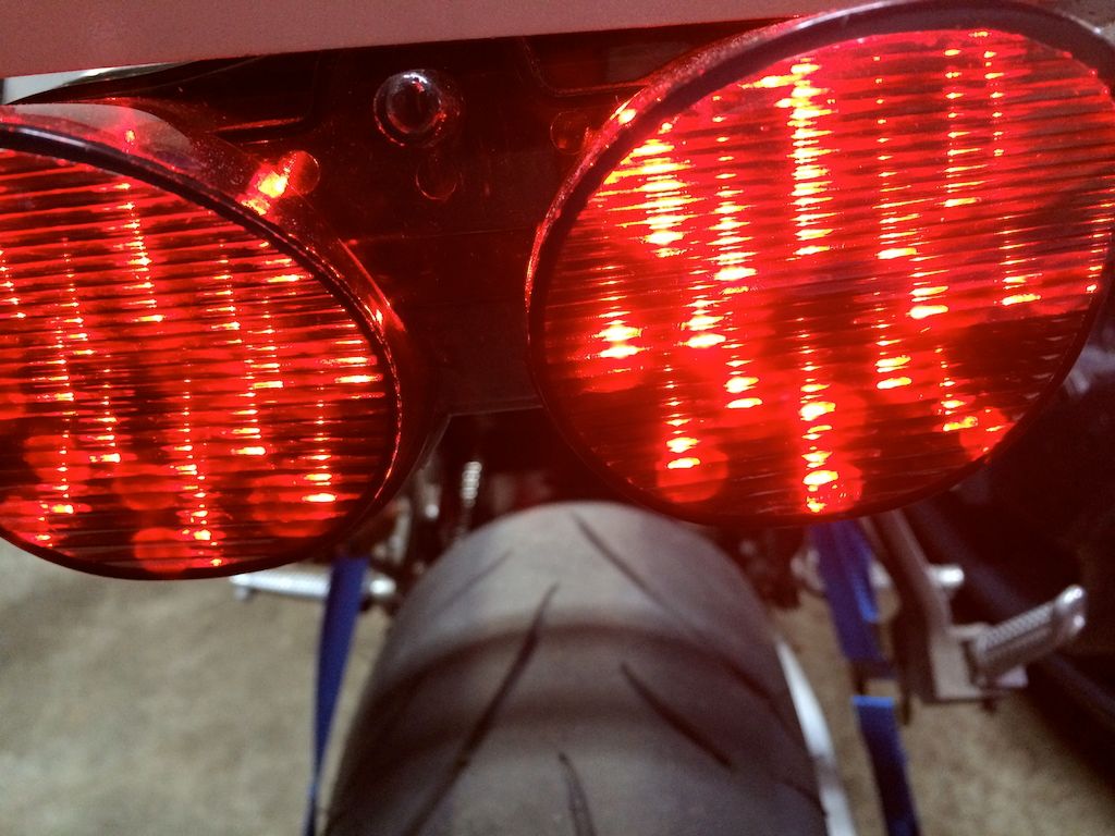

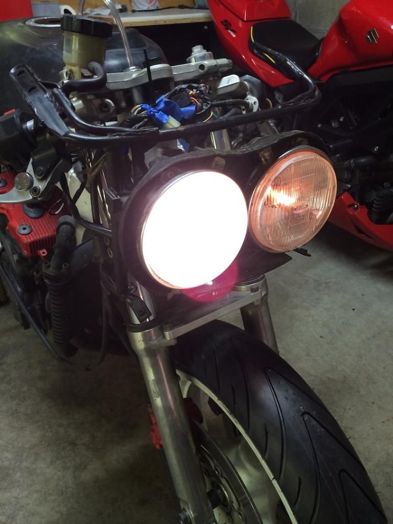

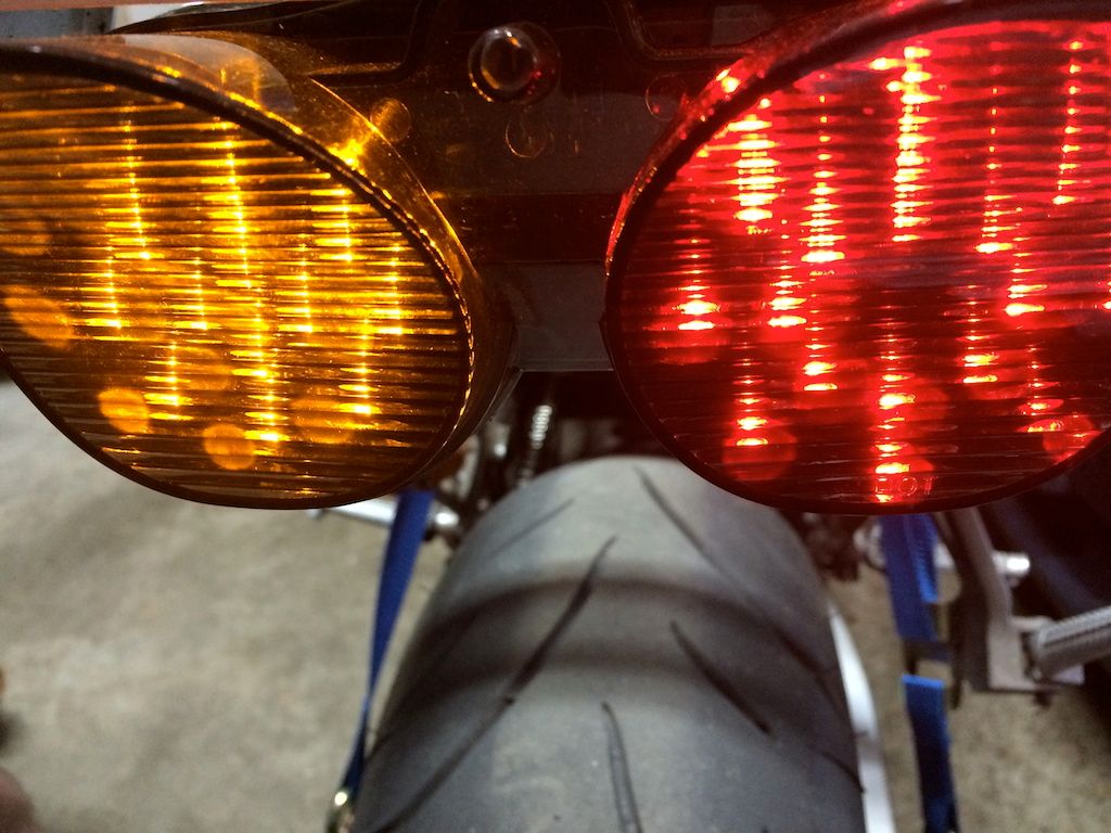

At this point I figured I should get it legal for the road. I did get the headlights, along with the fairing stay/headlight mount with the bike, so I bolted those up. Here's where I figured out one of the bulbs was burned out.

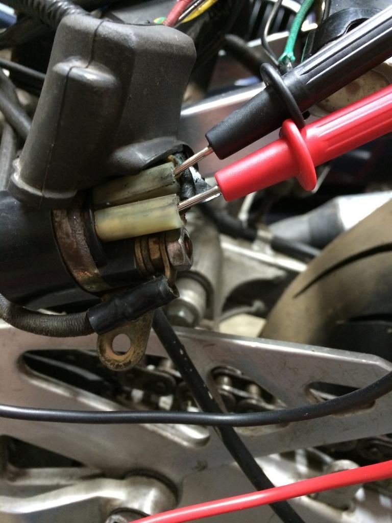

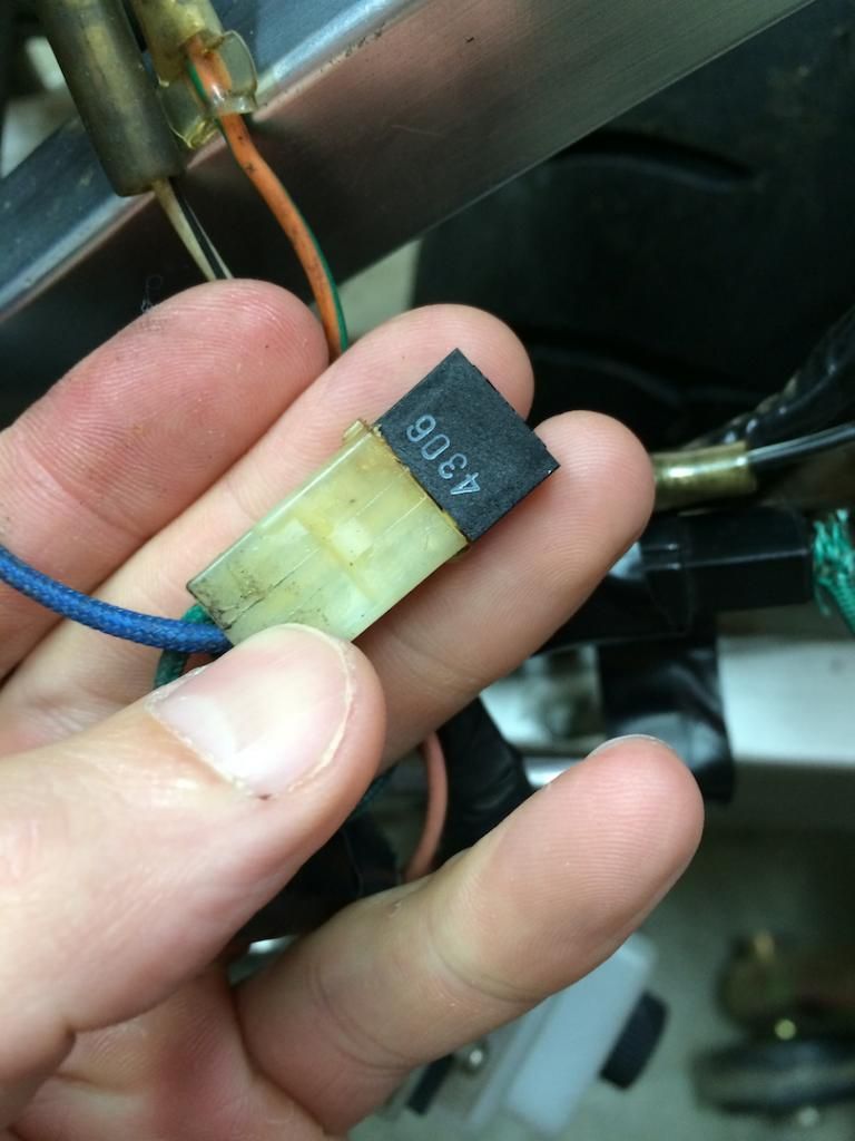

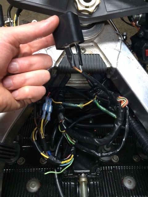

Now, I've been running this thing a ton since I've been able to reliably start it, and haven't had any issues, other than I think the kill switch is going out. After I bolted on the headlights was a different story. Soon after I mounted them, I had it running for about a minute, and I noticed some smoke coming up from next to the battery. The thing still smokes a bit after it warms up, so I've learned not to get to excited about some smoke coming out when it's running. I should have gotten a clue with it coming from the battery area. Anyway, after about 15 seconds of this smoke, the bike shut down like that. And here's why it shut down.
That's the side stand diode. Somehow with the lights hooked up, that power is getting transferred to the ground wire from the side stand switch. With the lights hooked up and the ignition on, the negative terminal on the battery is reading a bit over 12 Volts. I've been pretty lucky so far with the 25 year old harness, so I suppose it's about time the wiring bit me in the arse. I have yet to track down that short, but I'm guessing it's going to be fun.
I had a pretty good week after that with stuff showing up in the mail. First, the title for the Boiler.
Then a little box of goodies.

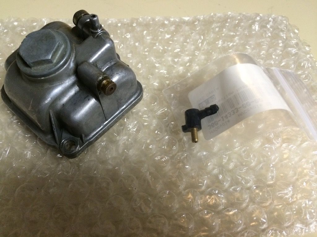

And then last, but not least, a new side stand diode.

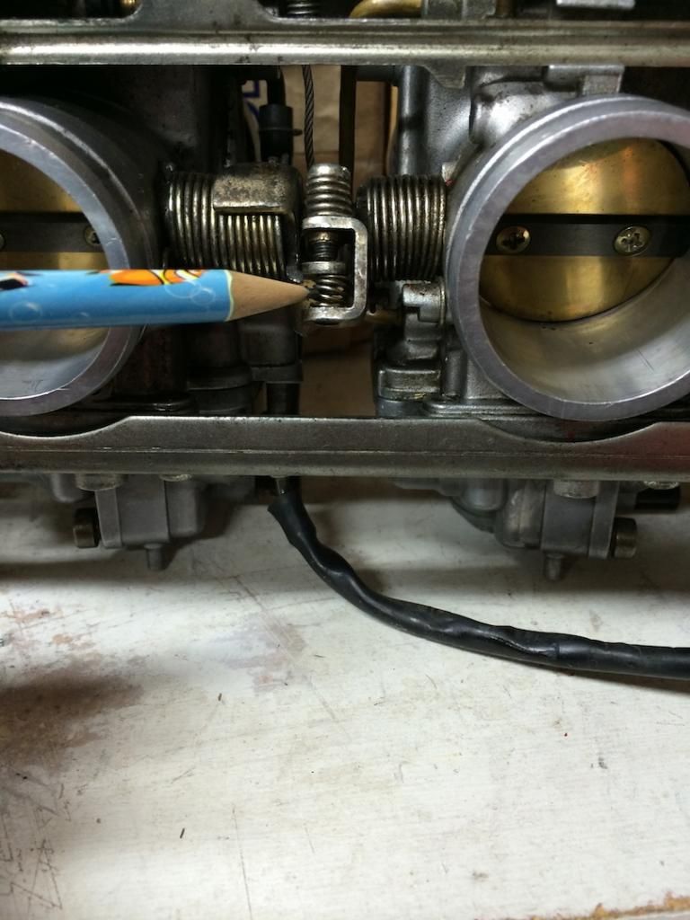

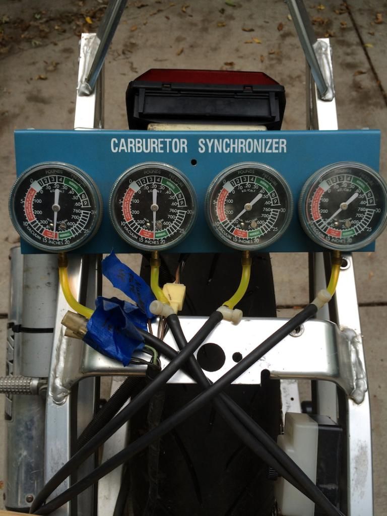

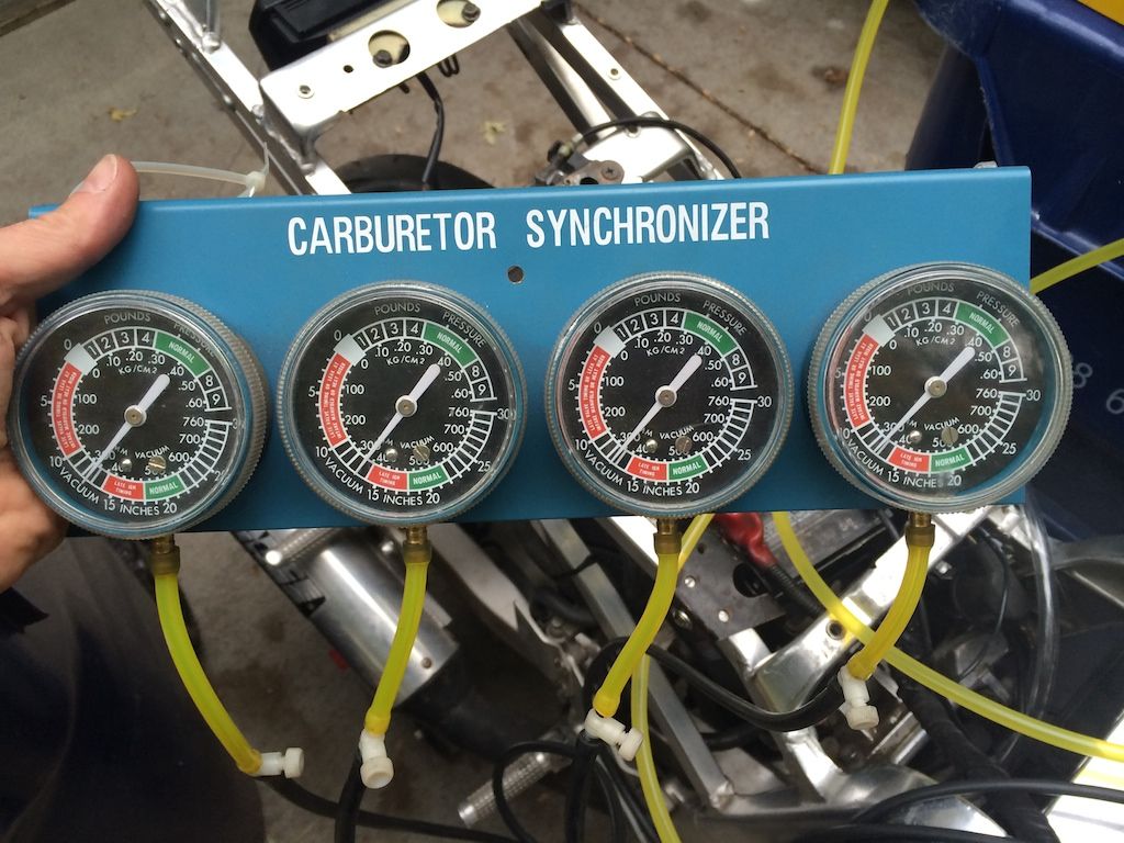

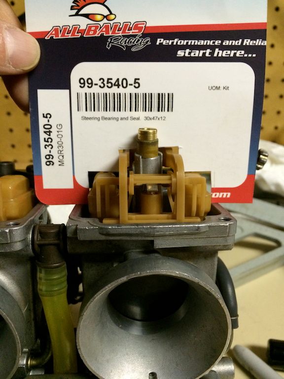

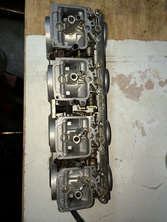

Around this time I picked up my friend's vacuum carb sync tool. I figured syncing the carbs might fix that lack of power in the bottom end. I didn't mention before that I bench synced the carbs before putting them on. Well, I figured out I suck at bench syncing when I hooked the tool up and started the engine.
I bench synced the carbs by zip tying the butter flies, or throttle, wide open and measured how far open the #3 carb was (that the throttle wire is connected to) and adjusted the other carbs to match that measurement. While each side is matched, it was to far out to adjust the sides to come together. So I pulled the carbs back off and tried syncing them by eye. I'm a little better with this method apparently.
Hard as I tried, I could not get that #3 carb to come in line with the others. I'm pretty sure I won't be able to because of 2 things. 1st - the butter fly on #3 is buggered up at the bottom edge for some reason.
And the spring connection between the 2 sides (that I'm pointing at with the pencil) just isn't so springy anymore.
But, I did get to take it out around the block a few times, and with the balancing as close as I got it, I have power back in the bottom end, and it has good solid acceleration from down low. I'm hoping to get it out on a country road soon to check the upper revs. I haven't installed the Factory Pro kit yet because I want to iron out all the bugs first. In the meantime, I just took the carbs off again yesterday and am giving another go at syncing them by eye. Hopefully I'll have better luck getting them all in line tomorrow.

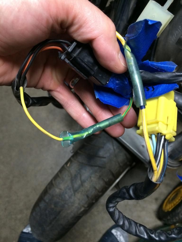

So, the balancing of the carbs was just putting off the inevitable. The short in the harness. Now that I had the carbs balanced, I didn't have a good reason to put off finding the short any longer. First of all, might as well take a good look at what I have. Luckily some left over 1/8 inch board from my bench and lockers project came in handy!
All the wires actually looked really good. There were a couple spots of nicked wires at the front (probably due to the mysterious collision). I taped them up to be sure, but that didn't fix the issue of the diode over heating. I put myself to sleep more than a few nights staring at the wiring diagram, trying to figure out why the diode might be getting all that power. I finally had enough of it, and decided to just take out the side stand relay and diode, and hopefully that would fix the issue. It was surprisingly easy to bypass the relay and diode - just cut the kill switch wire going into the relay, and attach it to the switched wire coming out of the relay. The red butt connector is my connection, and the next pic showing what I could get rid of.
But damn! Wouldn't you know it, I still had the ground to take care of, and when I tried to attach it to the same ground I used for the Neutral switch bypass, that connection still got hot when I turned the bike on with the lights on. I was at a loss at that point, so I went back to the wiring diagram, and started tracing the ground circuit. I don't know why I didn't realize it before, but that circuit has every light on the motorcycle on it, so there's a lot of power on that circuit. Then I was struck by that proverbial lightning bolt. All those lights needed a beefy ground! I started tracing where that ground circuit was grounded to.
Guess what?
The beefy ground for that circuit is the Neutral Switch itself! That switch is the only place on the circuit that goes to ground, since it's attached directly to the motor, the best place to ground something on a motorcycle. The circuit just needed a big enough heat sink for that power, and the motor is it! Holy balls it felt good to get that figured out! Since the motor and the frame are connected, I ran a short length of wire over to the nearest screw hole, which happened to be on the frame, attached it, and problem solved.

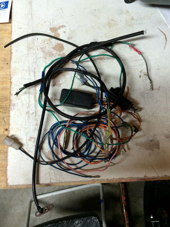

And here's a shot of all the wiring I've taken off this thing so far. At least I'm getting some weight savings out of all these issues I'm running into!

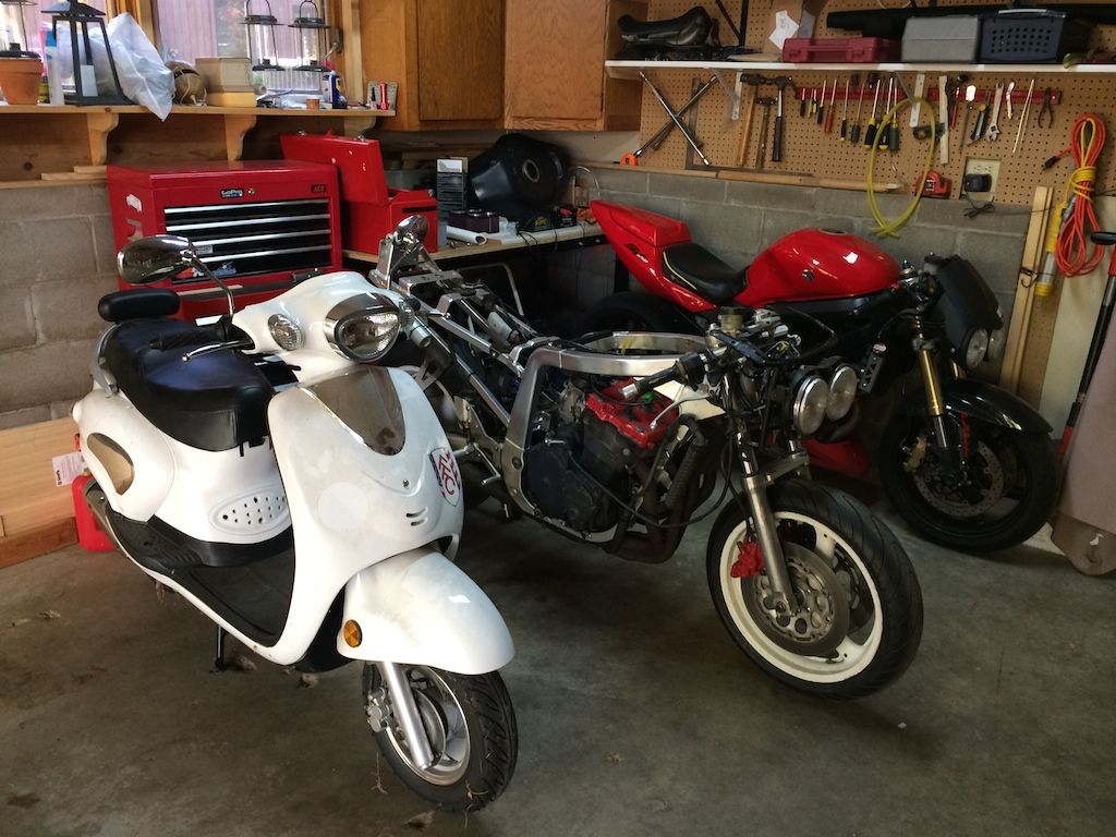

Then I had a little diversion. Hey, it's good shift your focus sometimes :)

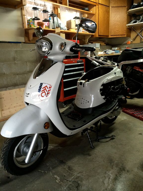

Look what I brought home in the minivan :thumbsup:
I got it from a friend of mine for 4 cases of beer. Carb is messed up, my friend is not mechanically inclined at all, so I pulled up with 4 cases of beer and left with the scooter :)
All my moto 2 wheeled vehicles.
Not sure yet what I'm going to do with the scooter. Fix it and sell for cash to put back into the boiler, or fix and use it as my new commuter. Anyway, new carb gets here in a couple days, so we'll see how I like riding it soon enough.

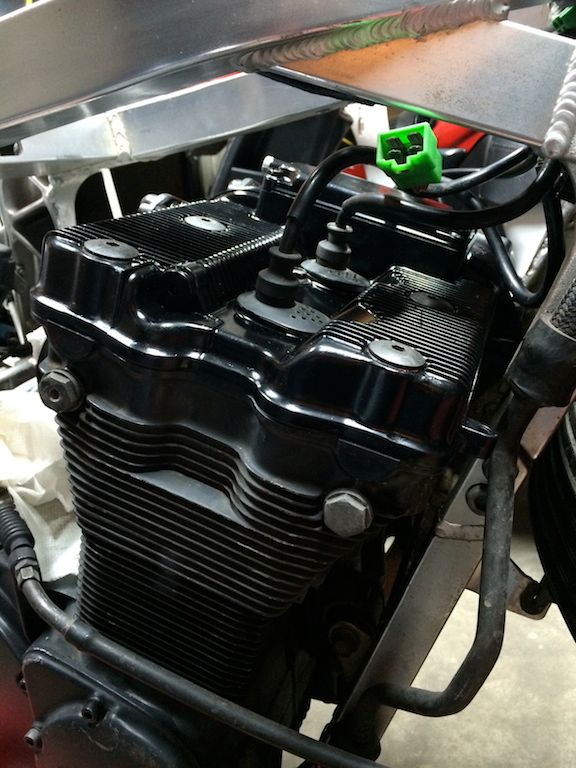

Back to the Boiler. With the bike running, going into gear, carbs balanced, and able to run lights without melting down part of the harness, I could finally take it out further than just around the block to open it up!

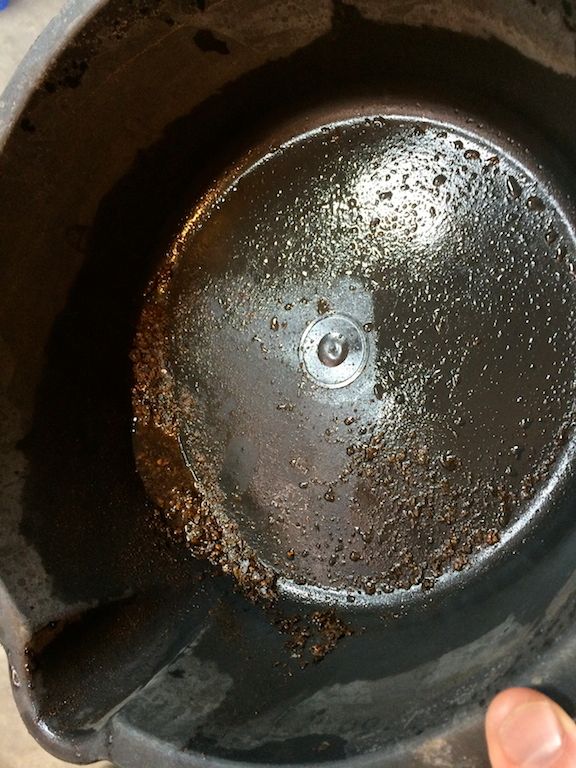

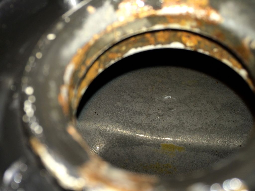

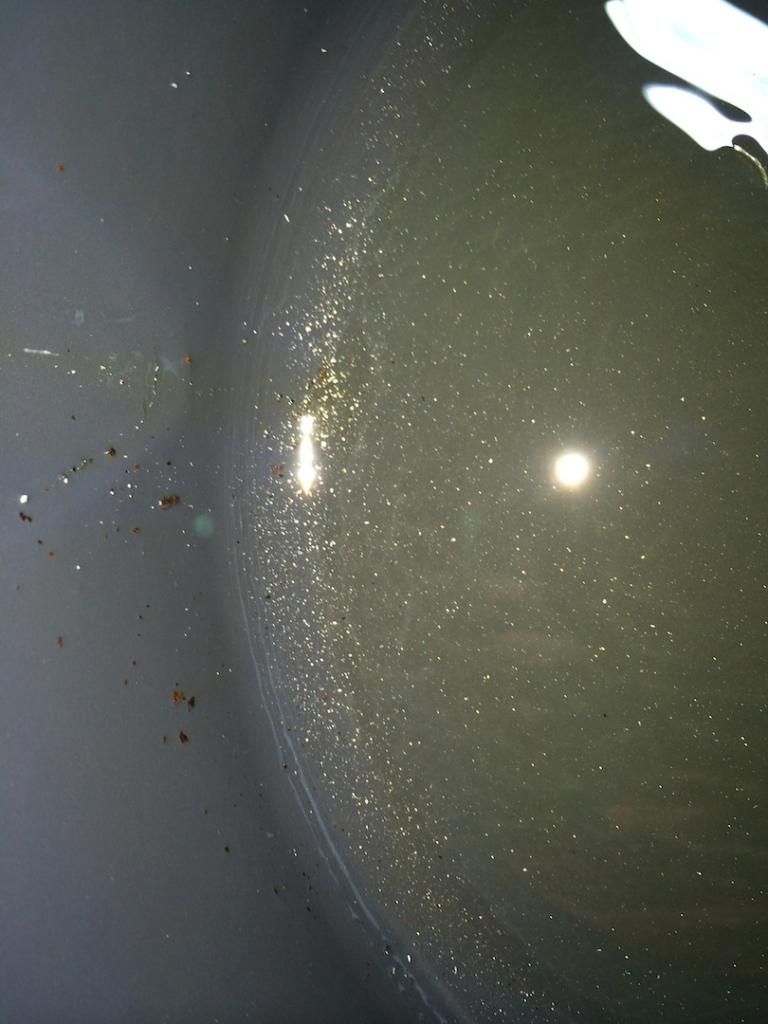

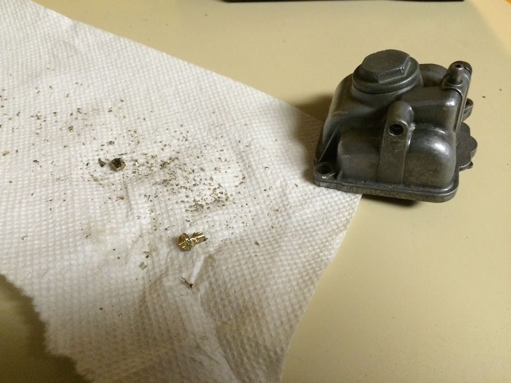

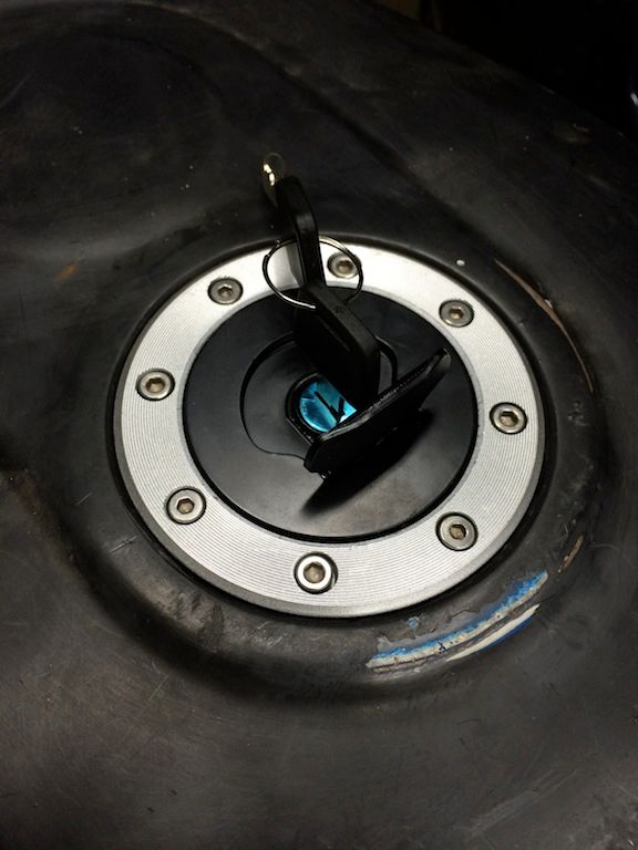

I took the carbs off last weekend to do that, and noticed little rusty bits in the bowls! WTF! The inside of the tank is not in the best of shape, but I haven't had an issue until now. Having gas in the tank for the last month or so finally loosened up the rust I guess, and it started floating. So, yet another cleaning of the carb, followed by the install of the Factory Pro parts, and now I had to do something about the tank. I have read about the Apple Cider Vinegar rust removal trick, so early last week I picked up 5 gallons of the stuff at the local grocery store and had the tank soaking all this last week.
Yesterday I emptied the vinegar and rinsed the tank out many many many times, first with hot water, then gas. The process actually did work pretty well, and I did get a ton of rust flakes out. Here's a cool pic, showing some of the crude I got out, but also showing the separation of gas and rusty water. That's clear gas on the top, and the rusty water underneath it.
But, as I was letting it dry after all the rinses, the inside of the tank got a light layer of surface rust after about 3 hours! Damn! I wasn't about to go through the vinegar process again, so I filled it up to the brim with gas (91 nonoxy). That should keep the rust from proceeding. Eventually, I think the light rust will disappear all together, but, one more thing to keep an eye on.

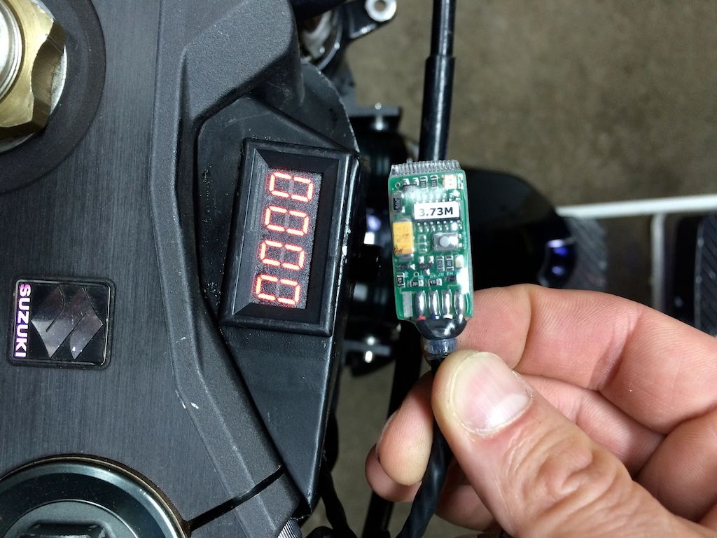

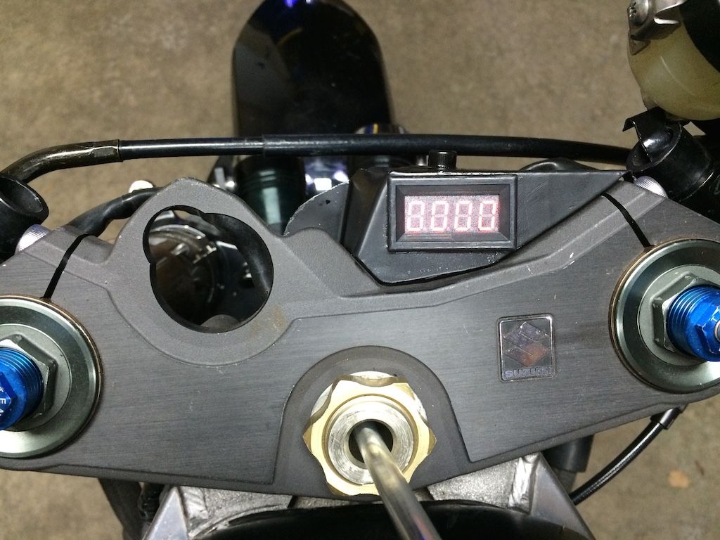

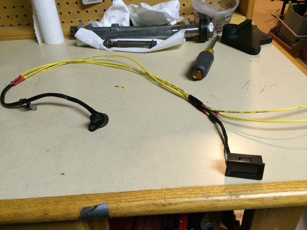

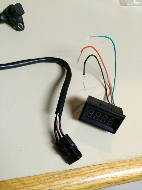

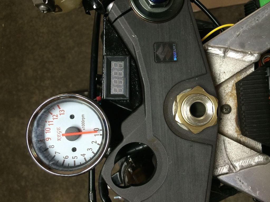

And, I almost forgot to mention, I finally picked up a tach for it. I was hoping for a bigger one b/c I love the swing of the tach needle, but I couldn't find one I liked, and this one was $18 shipped. As a plus, it fits in pretty nicely on either side of the ignition to the stock mounting point for the stock gauge bracket.
I just got the bike all put back together a couple hours ago. I was going to take it for a test ride to see if I could get over 40 with the Factory Pro kit, but the thing wouldn't start. I drained the battery in the attempt as well. I charged the battery over dinnertime, and went back out an hour ago and it finally did start for me. And, it revs over 4000rpm! Wow, I was reminded how f-ing loud this bike is!
So, that's were I'm at. I didn't take it out tonight, so hopefully I'll get to take it out after I get home from work tomorrow. With any luck I may have enough power to go faster than that scooter I just bought!

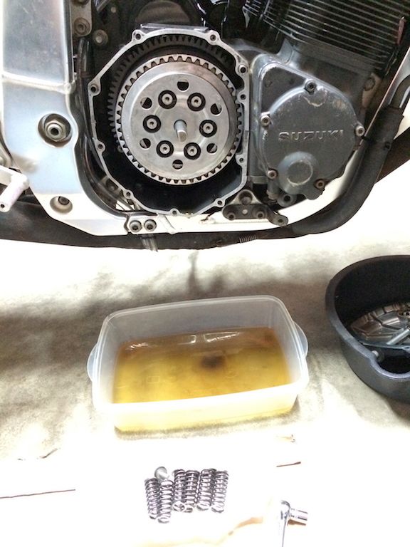

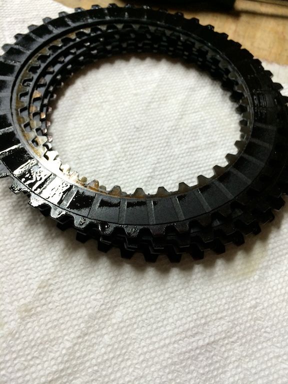

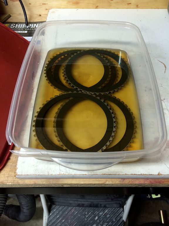

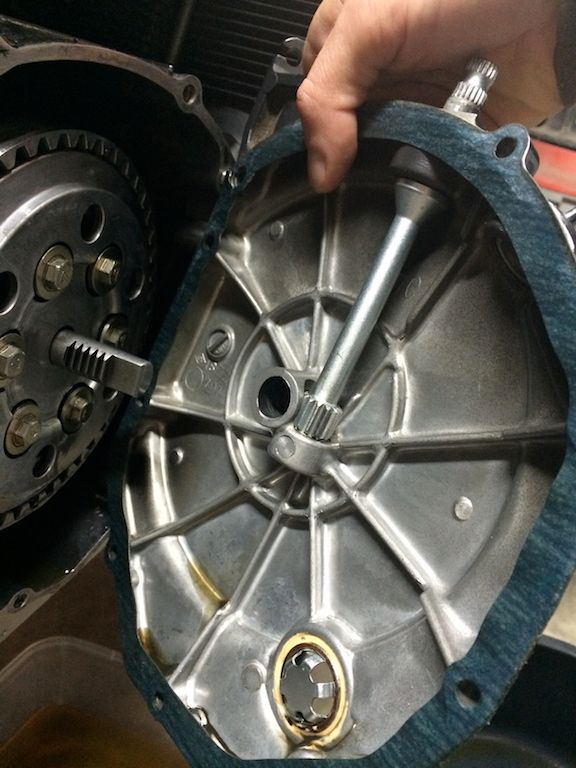

So this thing keeps kicking me square in the ass. But, replacing the clutch plates is a pretty easy process, and I had no issues with that at all.
First of all, here's the old plates, looking pretty worn and black.
Even got away with using some tupperware for soaking the new plates.

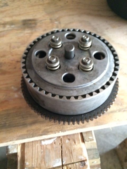

Put the new plates in, no issues. Here it is with the cover plate on ready for the springs.

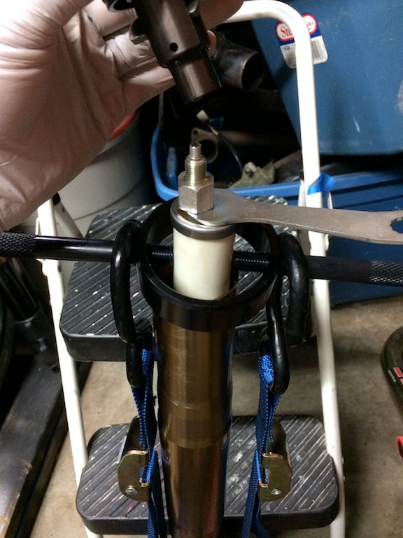

Even took a pause to show a little how-to pic - the gear at the end of the clutch pinion meshes with, for lack of a better term, the teeth on the clutch push rod. So, to get the cover on and off, you should use a pliers to move the top of the pinion back and forth until the cover moves off, or on, depending on assembly or disassembly. Here's a pic showing how the rod sticking out of the clutch plate, what I call the push rod, fits into the cover plate, so the teeth mesh with the pinion gear.
Put the new oil in. Even had the forethought to put the battery tender on the battery so I knew I'd have plenty of power to start it. And it did start, and was idling great.

Turned out some of the flash surface rust that happened right after the vinegar clean got into the carbs. I did a little more reading up of the vinegar clean, and found that the surface rust does indeed happen pretty fast afterwards. So if you happen to use the vinegar clean method, make sure you have the time to wash it out afterwards, and use baking soda mixed with water to neutralize the vinegar acid right away.

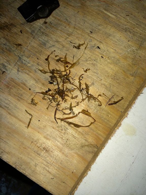

Anyway, spent Saturday afternoon doing a full tear down and clean of the carbs, and siphoned the gas out of the tank and didn't want to waste it, so I put it in the minivan. Washed out the tank again, and let it air dry for the next couple days. I didn't want to do another soaking method on the tank, so I put a couple handfuls of screws in the tank and periodically shook it for the couple days after that. The screws actually worked pretty well, and from what I could see through the filler hole, removed pretty much all of the crud down to metal. Here's a pic of the screws after I dumped them out of the tank. They were a bright shiny gold color when I put them in.
Washed the tank out again multiple times with water and then gas to make sure all the crud was out, then filled it with 5 gallons of fresh gas. I didn't put the tank back on the bike yet b/c I wanted to see if the fresh gas would loosen up any more crud, so I have it propped up on on some 2x4s. At that point, I got kicked again and the petcock started leaking.

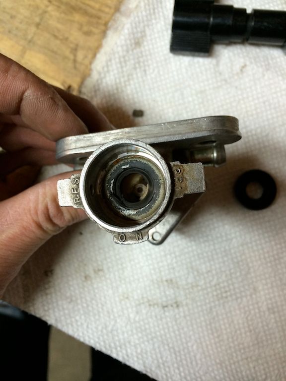

So, a pretty frustrating week with this thing. A petcock rebuild kit is on the way, and I'm sure the minivan will be happy to get another donation of gas from the Boiler.

Had a productive day yesterday. After I siphoned the gas out of the tank, decided to use all of it to rinse out the tank. So, poured a 1/2 gallon in at a time, shook the hell out of it at all angles, and dumped the gas out. It worked pretty well at getting a little crud out each time, and by the time I was out of gas on the last rinse, just about a little toe nail sized spot of gunk came out with the gas I'll keep it full of fuel over the Winter, then repeat the rinse process in the Spring to see what comes out.
While I was doing the rinsing, the Postman came by with my petcock rebuild kit, thankfully. Finished up with the tank, then started dismantling the petcock. Now, the petcock tear down procedure is pretty straight forward and easy, until you get to that fooking press in seal! Putzed with that seal for 45 min, took one of those cool down breaks, made hamburgers for the kids an I, then went back out after dinner. I finally grabbed my nail set and pounded down on one side of the seal, which raised the other side, and then I was able to pry it out with a screw driver. Here's a pic of that seal.

Second, pulled the carbs and put the 150 main jets in. As long as I had them off and was into them, I did a no no and changed one more thing. I dropped the needle jets one notch, as in I moved the cir clip up one notch. I know I should have checked how it ran with putting the 150's in, but my window of time, with the sun setting by 5pm, and the temp dropping like a rock after that, was very short. Also, today is most likely the last day to ride in MN until Spring, so went ahead and changed the needles as well.
Took the Boiler out this afternoon. I can't say there is a huge difference compared to last time I took it out(with the 147.5's), but I definitely had a bit more umph up to half throttle. I got out on a straight country road and opened it up to full throttle a few times, but the response was not good. Just a vague acceleration. So, as long as I was out, I stopped by my friends place (still need to buy him some beer) and right away he picked out the sound of a missing cylinder. Since this is my first I4, I had no clue what a missing cylinder sounds like. Anyway, we narrowed it down to #1 with the exhaust temps. #1 was still hot, but not as hot as the others, so don't know if it's just not firing at all or misfiring every once in awhile.
So, one more electrical issue to track down. Kind of sucks because I bought supposedly functioning coils and a supposedly functioning CDI for this thing.

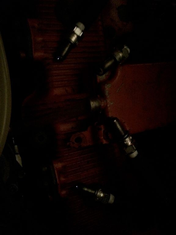

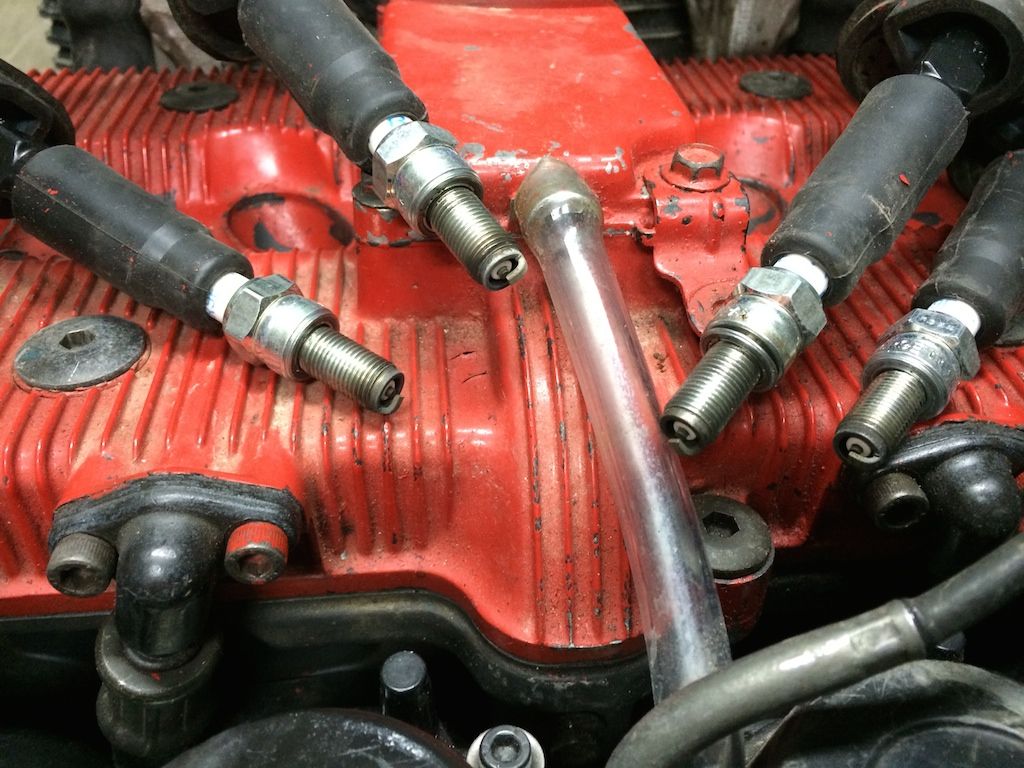

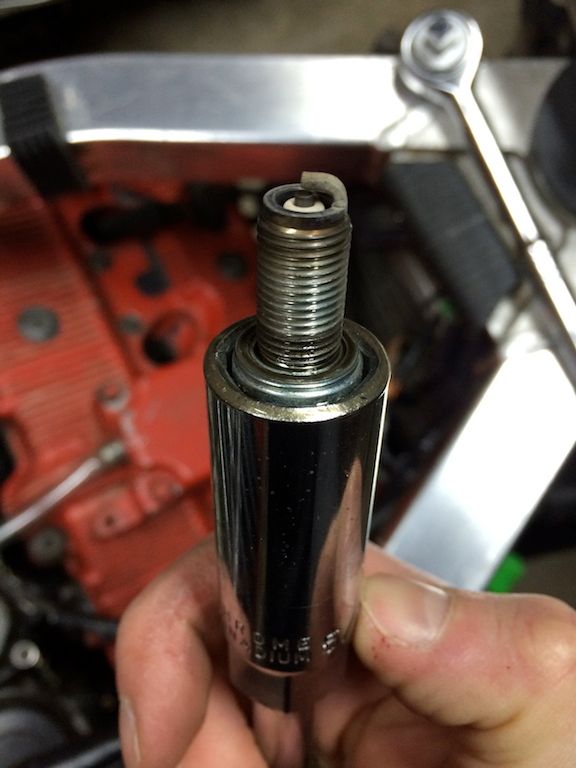

Finally had to time to pull the plugs and take a look. Here they are. Keep in mind there's only about 50 miles on them, plus maybe an hour and a half of idle.
Plug #1
Plug #2
Plug #3
Plug #4
So once I had them pulled, I wanted to verify they were all firing. Long and the short of it is that they are.
Here they are in the light.
Turned off the lights in the garage and hit the starter button.
Here's 2 and 3 firing.
And here's 1 and 4 firing.
This is all the further I got with the testing, but it looks like I've ruled out my electrical as the issue based on the spark plugs doing what they should.
One other thing - I have no experience reading plugs. To me, it looks like #1 and #3 aren't firing since they're pretty clean, #2 is looking like it is firing correctly due to the ashy type residue, and #4 looks like it might be a little rich with a little darker stuff on the end.
So everyone, let me know what you think.

Alright, I spent this last month piecing together a new front end for the Boiler. I decided to go with a '07-'08 GSXR 1000 front end with stiffer springs because the Boiler's weight is pretty heavy, comparatively. I also was able to get top and bottom bearings from All Ballz to make it fit to the '89 frame, and the current tire on the Boiler will be going on this rim. Also need to install a new reservoir and get a few bolts.

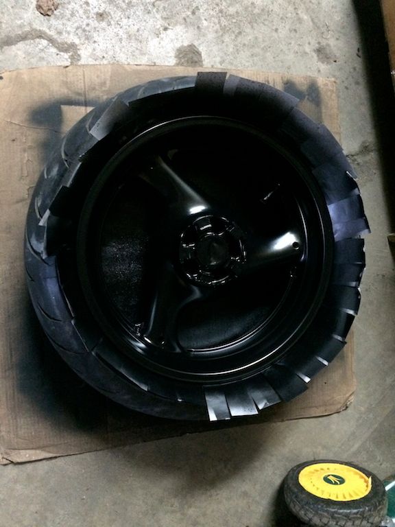

Slow but steady work on the Boiler for the past month. First things first, I was tired of freezing my fingers working out in the garage, so I got off my a$$ and cleaned up our storage room enough to uncover an old work bench that was meant for my boys, a chair and a cubby shelf, and set them up.
Then I got to work on the triple. First got it sanded, cleaned and taped up.
And 4 coats of flat black and 3 coats of clear later.

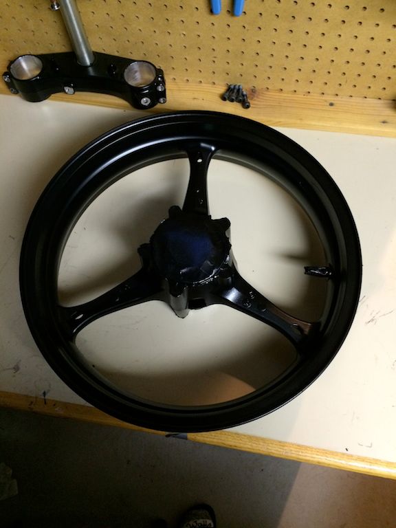

The triple came out looking so good, I decided to go after the front rim. But first, that rim tape had to go! The stickers came off easy enough, but the rim tape adhesive is pretty f-ing terrible. Enter Goo Gone! And the goo was indeed gone.
Smoothed out the jagged edges of all the scrapes and scratches with some light file work.
Sanded, cleaned, and taped it up.
And that's what I'm in the middle of right now. I have a few coats of satin black on, and I think one more coat of black, then a few coats of clear and it'll be ready for a tire.
It was above freezing here this weekend, I got a bug up my butt about the scooter, so I pulled it out, put the new carb in it (that's it on the left sitting on the bench in the first pic), put the body panels back on, fired it up, and took it around the block. The 50cc motor is a little under-whelming, but at least the new carb's fueling is right on, so one less carb I'll have to putz with. And it will be a fun little toy around town. Here she is mid-reassembly.
#18 ·
Finally got the front wheel finished up. 5 coats of black, and 4 coats of clear. I learned the important lesson of light coats due to some wrinkling in the paint that I had to sand out. Here it is.
With the front wheel done, I went to work on the carbs. That broken power jet nozzle was bugging me still, so I bought that similar oil jet nozzle that goes to an old yamaha to replace it with.
Had to drill the old one out.
Then used some loctite to set the new one in, and propped it up so that the loctite wouldn't run down and plug the hole.
Another thing that was bugging me about the carbs was the emulsion tubes. They didn't look too oval, but I thought I'd replace them just to take that question out of the equation.
So took the carbs the rest of the way apart.
Remember how this thing kicks me in the a$$ every once in a while? Well this time it got me square in the balls. I was reassembling the bottom end of the carbs with the new emulsion tubes, and was on the third carb, tightening the main jet into the emulsion tube, when I heard a "SNAP!"
This is what happened.
Can't believe it. I didn't even have it very tight when it broke.
So, if anyone knows of where to get a slide, or has one, let me know.

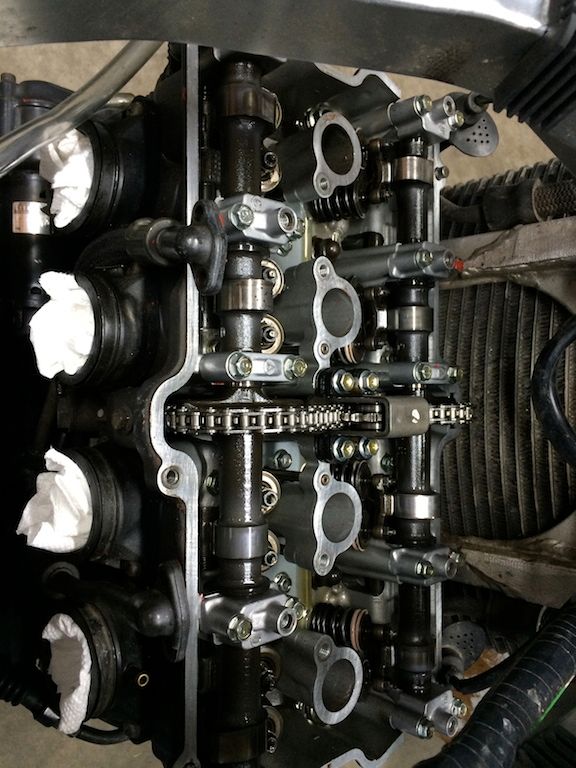

So, with the carbs fully back together, I finally listened to the advice I've been getting and checked the valves.

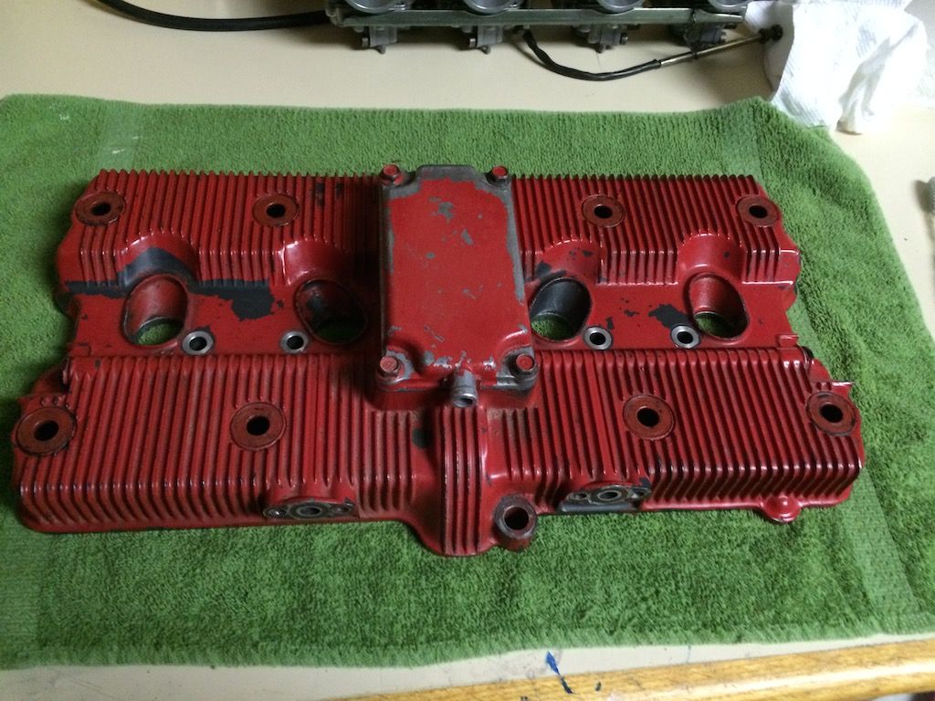

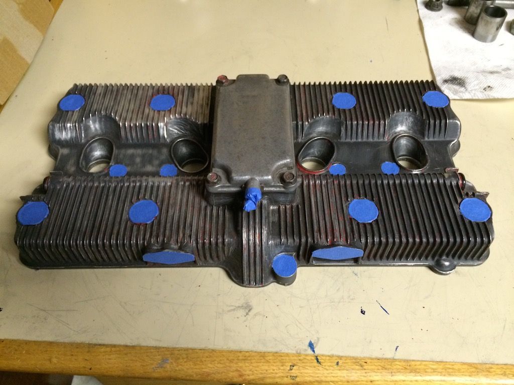

On my bike, the spec for Intakes is .004 - .006, and the Exhaust spec is .007 - .009. My intakes were alright, but ranged from .003 to .007. I reset all of them to .006. My Exhaust was another matter. All of them were tight, with the lowest reading on #1 of .0025 and .003. This makes sense with my friend noticing #1 wasn't firing and a low exhaust temp. With such a tight gap, once it warmed up, the valve would be hanging open, and I wouldn't be getting the pressure needed for the bang. I reset all the exhaust valves to .009. I just hope the tight exhaust valves were the reason I wasn't getting any response over half throttle.

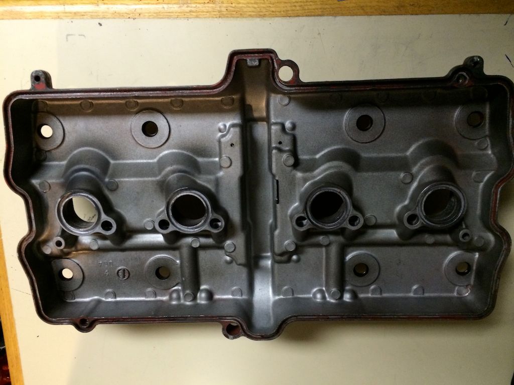

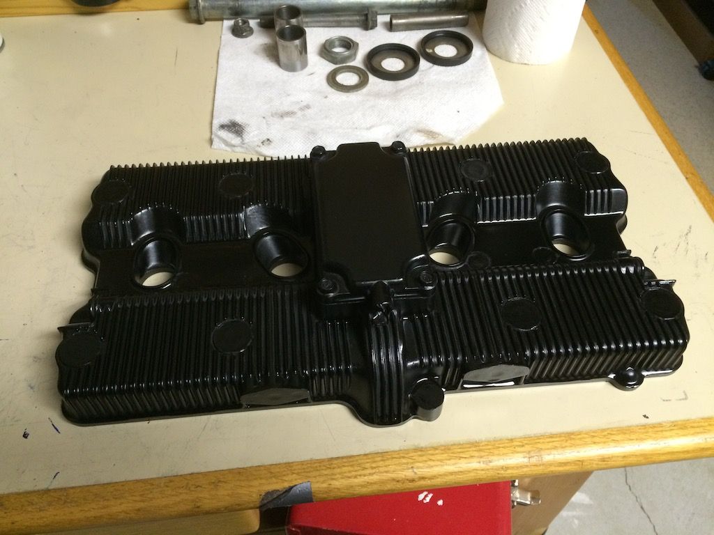

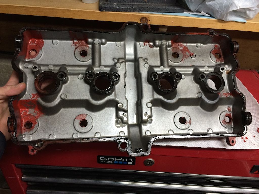

Since I had the valve/cam cover off, I decided to paint that as well. Take a look at the inside of the cover. I think the person who painted it red was drunk and used a brush.
And cleaned up.
One last look at this crappy paint job on the cover.
Spent a couple nights scraping the paint off, then prepped it for paint. I'll have to admit I thought a lot about leaving it bare metal with a clear coat over it, but in the end decided on paint.
Picked up some high temp grill paint at the local hardware store, and put a couple of coats on. As much as I like flat black, I went with the shiny version of the paint to make it stand out a little more.
Much better!

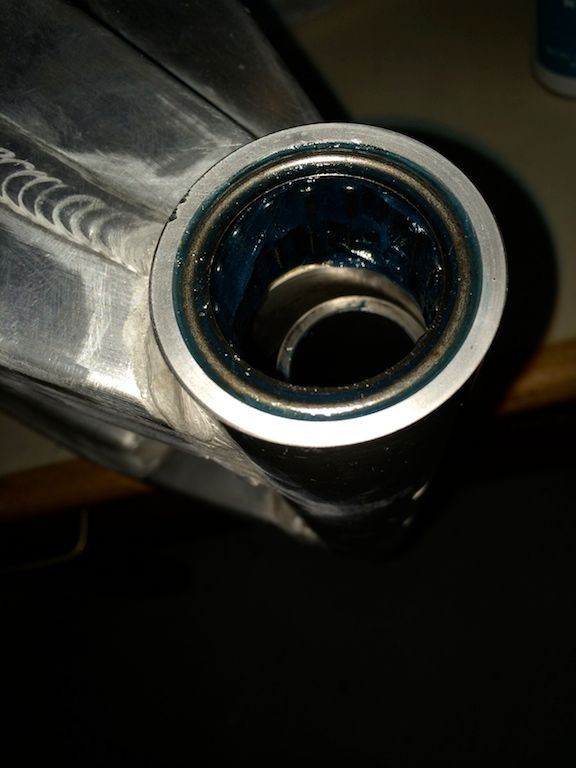

One of the things I learned over on gixxer.com is that the stock swinger flexes a bit during cornering. In '94 Suzuki introduced the braced swinger on the 750's to help with that issue. It just so happens you can retro fit the braced swinger onto OC 750's with very little trouble. So, the same gixxer member that got me the carb slide guide just happened to have a braced swinger for sale as well. I couldn't pass it up :)
You may have sensed a black motif with this bike by now. So guess what color the swinger is going to be? Yep, black. Here it is all cleaned up, sanded down, and taped up.
Before I taped it up tho, I made sure to clean out the pivot and doggone bearings as best I could and regrease them.
Currently I'm in the middle of painting the swinger. I've read that aluminum is a bit touchy to paint. So, beyond the good sanding I gave it, I've put on two coats of primer. I now have 2 coats of black on it, and will put some clear on it after that, and hope it sticks well.

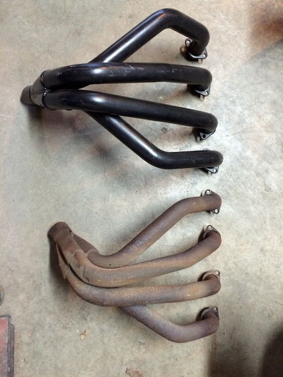

So the exhaust header on the Boiler is stock, but the midpipe/muffler is V&H. I guess I just assumed that the outlet of the header and inlet of the midpipe was a good fit. Wow, I was wrong. I measured a good 1/4 inch difference. I'm surprised I never saw exhaust gas coming out of that junction. I did see exhaust gas coming out of the 4 into 1 junction tho. Definitely time for a new header. I got pretty lucky on this one, because I found an old build thread on gixxer.com where a member randomly mentioned to the builder that he had a V&H header if he wanted it. I PM'd the guy and he happened to still have it, and he sold it to me. It's the perfect fit for my mid pipe/muffler!
Which header would you rather have on your bike?
Incidentally, let me know if you want the stock header. Considering the exhaust leak and dents, I'll let it go for pretty cheap.

So, at the beginning of this week I went to grocery store and picked up another 5 gallons of Apple Cider Vinegar and poured all of it into the tank. I also picked up a couple of boxes of Baking Soda so I can have a mixture of that ready to pour in as soon as I dump the vinegar.
I really hope it works this time.
#20 ·
I'll let the pics speak for themselves.
Dang! Didn't think it would get that clean. I ended up leaving the Apple Cider Vinegar in the tank for 2 weeks. When it came time to take the Vinegar out, I made up 5 gallons of Baking Soda mixture. I split 2 boxes of Arm and Hammer into the 5 gallons.
Then I siphoned out the Vinegar, periodically shaking it to make sure all the rust came off the walls. Here are the vinegar bottles, in order from left to right how it came out of the tank. Grungier and grungier as the level went down.
As soon as I siphoned all of the Vinegar out, I poured the Baking Soda mixture in, giving it a good shake after each gallon went in. Then I let it sit for about 1/2 hour, periodically sloshing it back and forth, just to make sure all the Vinegar was neutralized by the Baking Soda. I even tipped the back end up and let the Baking Soda solution run out of the breather vent on the front of the tank. I then siphoned most of the Baking Soda solution out, leaving about a gallon left in the tank. I shook the hell out of the tank, took the petcock off and poured the last gallon into my oil pan. I poured off the liquid, and this is what was left.
I then washed it out with gas several times, putting about 1/2 gallon in, shaking the hell out of it, and letting it pour out of the petcock hole after taking the petcock off. I did this 7 times before I didn't see any trace of the water from the Baking Soda solution, and only 2 tiny specks of rust came out. At one point I even sprayed WD-40 in it to help with the water removal.
About the time I put the Vinegar in the tank I had ordered a new petcock. I decided I really needed the Reserve function back. It ended up being a good thing since the old petcock was dripping from every hole and the diaphragm by the end of the 2 weeks. So, a good note if you plan to do the Apple Cider Vinegar rust removal procedure, have a new petcock ready or make a block off plate so you don't ruin your petcock. Here's the new petcock in the box, fresh out of the shipping box, specific for this vintage of GSXR.

Made some good progress over the last couple weeks! First of all I had to get the bottom bearing on the stem. So I put the bearing in the oven at 220F (recommended for bearings) and the bottom triple in the freezer. Well, didn't go so well for me.
So, had to take it down to my friend's shop and he pounded it the rest of the way on with the bearing install tools he has. As long as I was there, he let me borrow his tools to take out the old races and put in new ones.
The old races out, looking a bit corroded.
Then the new races went in. Here's the bottom pressed all the way in.
And here's the top pressed in.
Lubed up the bearings with the marine grease I used for the swing arm bearings.
Then about 10 minutes later this is what I had :)
Wish I would have been thinking harder when I brought the triple down to my friend's shop and I would have brought the new rim and old wheel with me to get the tire switched over. Oh well, I had to go back down to the shop to return his bearing tools anyway, so I had the tire switched over then.
In my daily trolling of the moto forums, I picked up a cool trick to set the float heights in the carbs. Pretty simple really. Just get a piece of card stock and cut out "steps" in it at 14.6mm, and a higher one in the middle to clear the top of the float, like this. I made good use of the All Balls packaging :)
Using that template, I found that 3 of the floats were pretty far off, probably about 11-12mm, meaning, first of all, I suck at setting the float heights using my caliper and my eyeball, and second, the fuel level was high. I'm not sure, but maybe that might be the cause of the no response over half throttle, if it was getting flooded with fuel. Well, I reset those 3 floats to 14.6mm. I also had ordered a Motion Pro throttle cable, so I put that on the carb as well
Carbs buttoned up, tire switched over, gas tank clean and not leaking fuel - I guess it was time to put it back together and get that new V&H header on!
Of course, I'll have to do something with the rat's nest of wiring. There's a lot of excess at the front, and I was thinking of either coiling up the excess under the tank by the coils, or unwrapping the harness again and shorting all the wires I need, and taking out the ones I don't need. If anyone has advice, let me know.
Hopefully tomorrow I can get it started after it's long hibernation and take it for a ride!

With it being so close to streetable, I figured I should make it legal for MN. So I picked up a pair of cheap bar end mirrors for it. They actually work almost as well as the CRG's I have on the SV.
Also, I had to get headlights and solve the lack of steering stops problem I created with putting the new front end on. So, I solved the 2 problems at the same time by picking out some eBay fork clamps where the back would hit the frame. I ended up having to mount them pretty high to get a fuller motion side to side, but they work for now. I think I'll grind the clamps down by the screw holes to get a little more motion.
Then I picked out some eBay lights that were pretty cheap.
I'm not really liking how far apart the lights are, but that's where the clamps have to be, and it's road legal now!

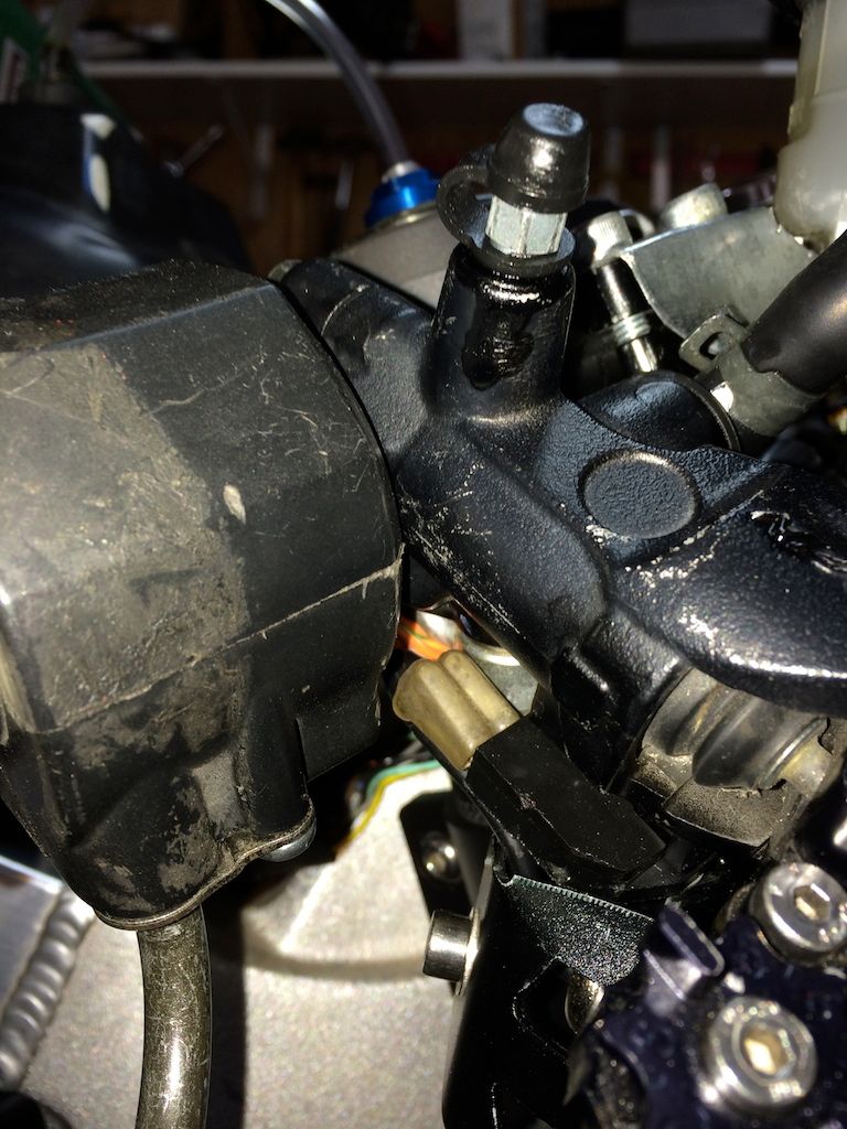

So, remember that recurring theme about this thing kicking me in the a$$? Came out into the garage the other morning and found the following.
Luckily I have an extra brake master that came with the clip ons I bought for this thing so I'll be putting that on pretty soon. And I ordered a fork seal kit which should be here in about a week.
Just keeping my cool for the time being :)

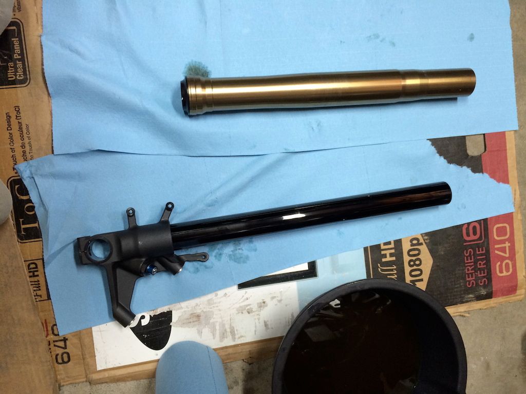

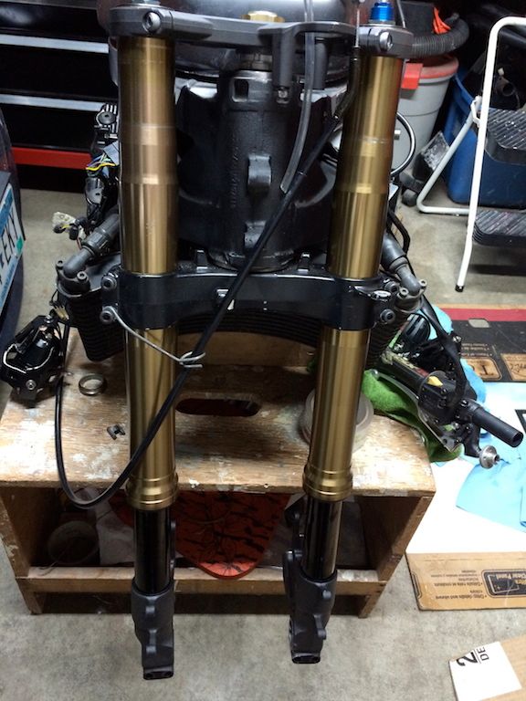

I thought about the fork set up quite a bit considering the '89 GSXR750 is 40-50 lbs heavier than the '08 GSXR1000, not to mention the weight bias toward the front is probably bigger on the older bike as well due to the heavier engine. But, with very little riding time on the new front end, I'd just be shooting in the dark if I made any changes now. So, I decided to stay stock with the front and get more time on it before I made any changes, if needed.
So the front end came off and I took the tubes and parts down to my friend's shop and he's going to fit it in when he's done with all the lawn mowers that are flooding his shop now that the grass is growing.

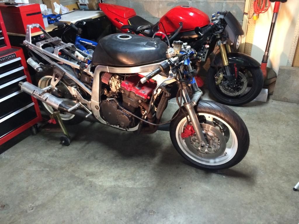

As long as the Boiler is on a jack, I guess it's time to wrap up some details. I did put that other brake master on. Guess what? That one leaked in the same spot also. At that point I was tired of Dot 4 brake fluid all over my hands, so I moved on. I'll get back to it when my frustration wears off.

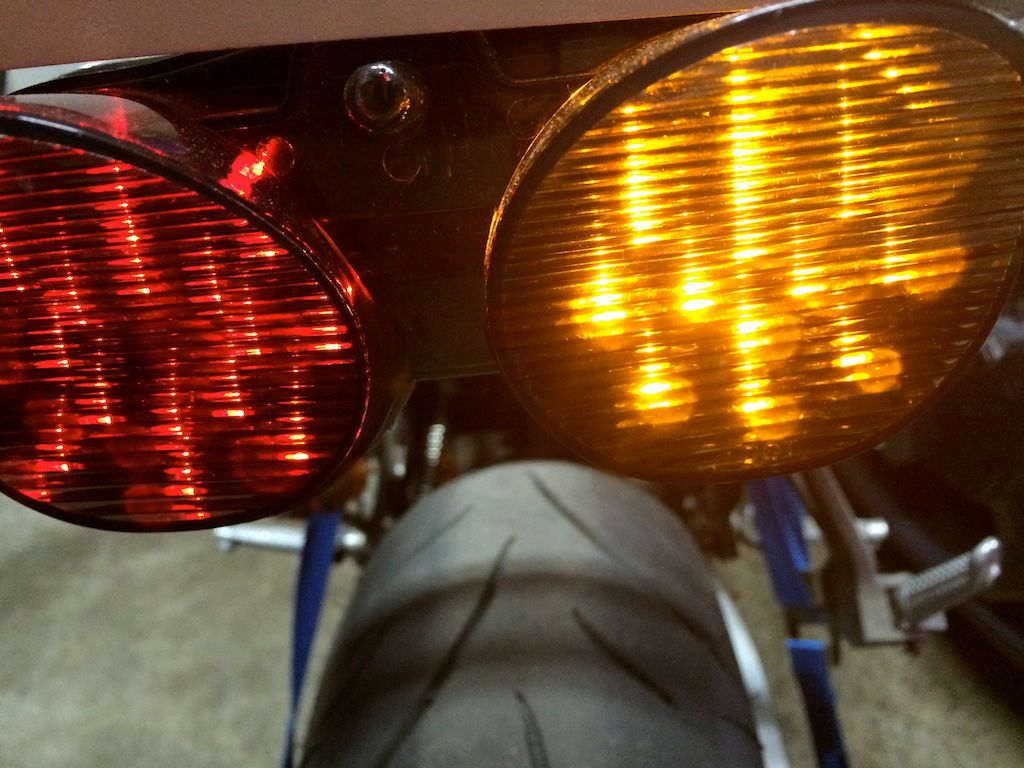

So, when I brought the Boiler home in the back of my minivan a year ago, it was missing a lot of things. One of those things was any semblance of a turn signal set up. Well, the wiring in the harness was all there, but the signals and relay were gone. I've been looking for awhile and had my eye on the early 2000's R6 tail light. I like the dual tail light, and the round lights with the upward radius look pretty cool. So, I finally ordered an LED R6 tail light off of Ebay with integrated turn signals. Also, something I didn't know, but they now have relays that are made specifically for LED lights to slow down the blink rate. Damn! I've had LED turn signals on the SV for a few years, but I installed those resistors that get hot. I might have to upgrade the SV with a new relay to get rid of those resistors.
Anyway, here's the new LED relay (2 pin version) wired and taped up.
The final spot for it is in the nook behind the steering head. I figured that would be the driest spot on the bike. And here's the tail light working as it should.
That's where I'm at now. Hoping to get into the carbs soon to verify the float height and possibly put the the 150's in. I don't even want to think about the brakes yet. Anyway, mainly I'm just biding my time until the forks are done.

Alright, first of all I took the carbs off to verify the float height. When I used the template the first time I had the carbs completely upside down. This time I checked with the carbs at an angle so that the float needles were just barely touching the float seat. There must have been some compression of the rubber part of the float needle, because there was roughly a mm of difference. This meant that I had the fuel level in the bowls a little lower.
Lesson learned.
I reset the float heights to the 14.6mm, with the carbs at an angle, and put them back together. Since I changed the float height, I kept the 147.5 jets in.

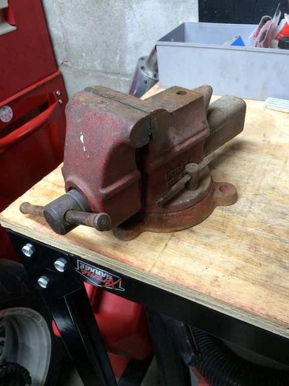

I also had a little fun with the wire brush on my drill.

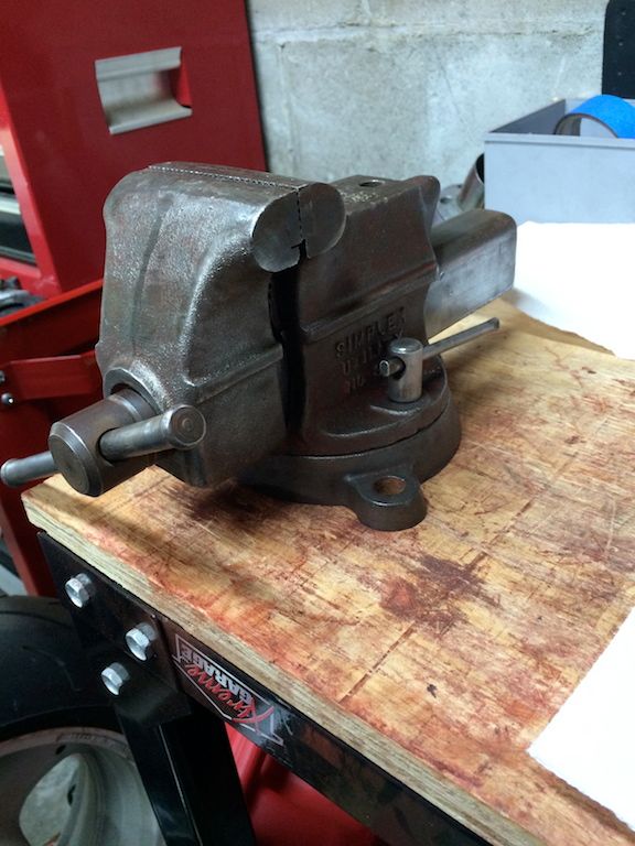

This vice was my grandpa's vice that he had in his woodworking shop in his basement.
And after about half hour with the wire wheel.
My bud was still busy down at the shop and my front wasn't done yet, so I got over my dot 4 aversion, and also took advantage of my newly refinished vice, and bled the brakes on the bench.
I did get a pretty firm feel with the lever after zip tying the lever to the handle for a day, and bleeding them a few times to make sure all the air was out. But, I'm wondering if I'm fighting that recall issue that Suzuki put out about the brake masters corroding on the inside, since my master is off of a 07 GSXR 1000. I guess if the feel fades, I'll end up getting a master from a year that is outside of the recall.

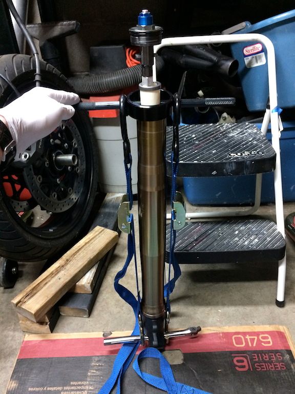

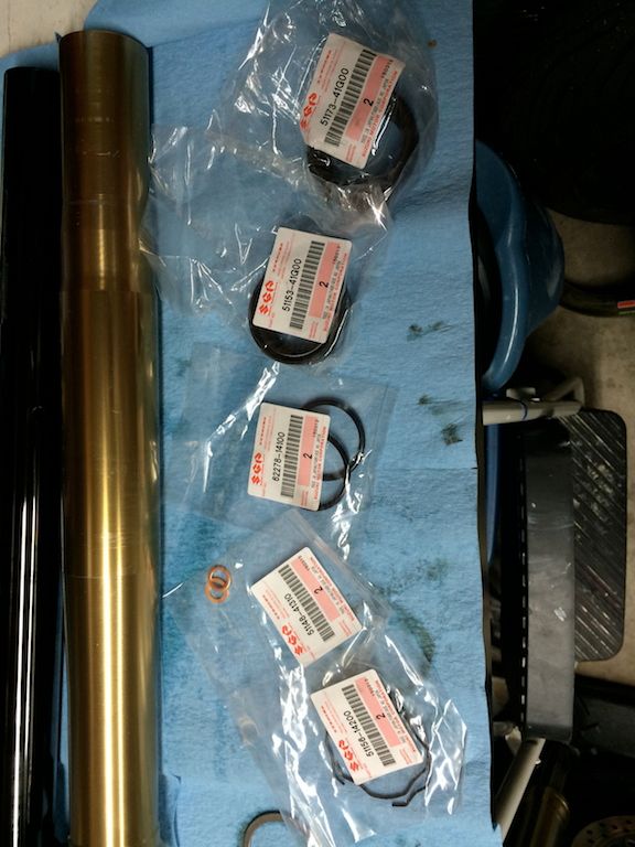

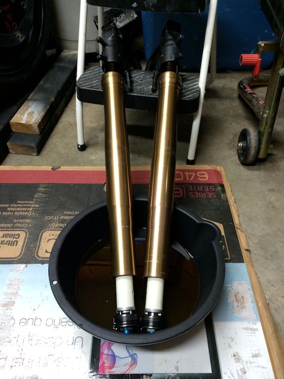

A couple weeks ago I went down to my bud's shop, and while I was waiting I did a quick count of the mowers in his shop. I counted 25. Dang, my friend was still getting slammed with mowers! Great for him, but my forks weren't done yet. So, I took my forks and parts home, along with his spring compressing tool. I also spent a few hours looking at youtube videos and threads about redoing forks. My wife left town for the weekend, so I had free reign of my time and got to work on the forks.
First of all, I drained most of the oil.
Compress the spring and remove the fork cap.
Drop the damper rod back in, pull out the spacer and spring and take the tubes apart.
Make sure you have your parts on hand.
After installing the new seals, put the new oil in. I used a wire to pull the damper rod up and down to get the bubbles out of the cartridge. Make sure to get the oil level to the specified height for your particular forks.
Put the spring and spacer back in, compress the spring again, install fork cap, making sure the lock nut is at the right height. Then repeat the whole process with the other fork. Of course the second fork will take a lot less time! Then reinstall.

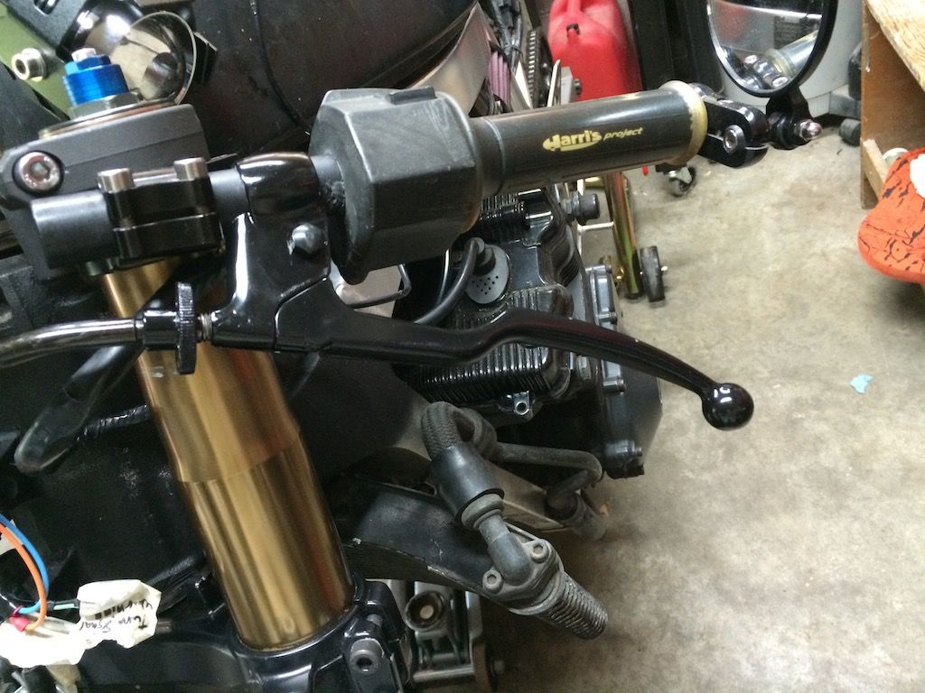

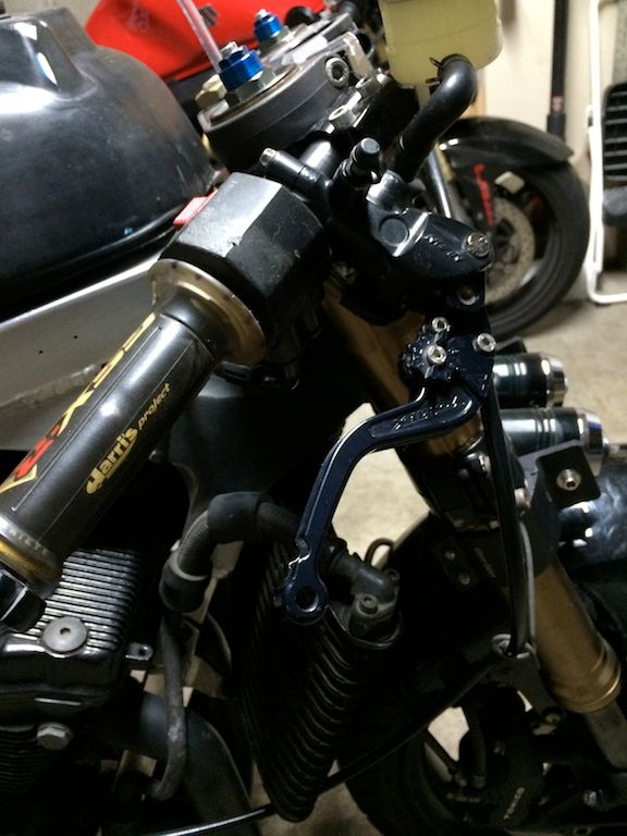

I also caught up on a little finish work now that I was putting the front back together. Pictured are my homemade brake reservoir bracket, clutch cable adjuster, and two new fork clamps I bought to use as my steering stops, since the headlight brackets I bought earlier were just not working well for that.
I also painted the clutch handle and mount, and used the high temp paint I used on the valve cover. Put them in the oven at 300 degrees for about an hour, and they look pretty good. I'll see how they wear over the long term.
Here's the clutch handle now.
And my homemade brake reservoir bracket. I love how it blends in with the clip on.

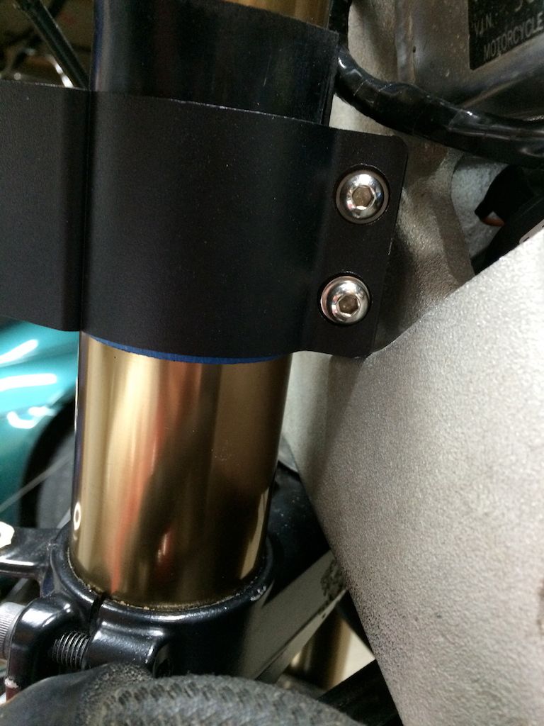

Now it was time to put the lights back on, and I decided that I just couldn't do the widely spaced lights, and went a totally different direction. I had found the other brackets by that time that I'm going to use for steering stops, so I was free to mount them however. I tried several configurations, but ended up liking the below the best, with the light cages removed. Also reminds me of the Confederate Fighter cycle.
Those lights are spots, so I'd still like to mount some floods to light up the ditches, so I'm thinking about a thin light bar to mount above them, above the bottom triple. Also, I'll have some work to do to clean up the wiring, and at some point I'd like to switch to stainless braided brake lines, which will help clean up the front.

Should probably update you on a little side project I've been working on here and there since late Winter that is finally coming to fruition. I neglected to post about it because I didn’t know if it would work or not. Anyway, last Winter I had been looking for a speedo solution, but nothing out there was looking good to me. I was dang close to buying another Vapor for this bike, but ended up thinking while it worked well for the SV, it just wasn't right for the GSXR. So, I decided to make my own speedo. First off, I ended up thinking a simple digital readout for speed would be perfect, and picked up a small 4 place digital display off of eBay. I also got a speed sensor from a 08 GSXR.
Both are 3 wire, so I wired them up, used the GSXR battery for power, taped a magnet on the end of my drill, held the sensor next to the magnet on the drill and turned the drill on. Well, the display didn't work. Long story short, I had been talking with 12 O'Clock Labs by this point b/c I was planning to use their SpeedoDRD to get the display to read actual speed instead of revolutions. The 12 O’Clock Labs guy then had me wire in a resistor between the signal wire and positive wire, and it worked! No idea how it worked, but it did.
And here it is at the right length, ready to be taped up and installed.
In order to mount the sensor close to the wheel to pick up the magnet passing by, I fabbed up a little holder that fits around the lower fender mount, and is held in place by the fender and the fender mounting bolt. The magnet I salvaged out of a pair of old earphones. In this pic the magnet is just taped on to the rotor to make sure the clearances are good. I have since epoxied it on.
The next part of this side project was mounting the display up on the triple. I started with some cereal box card board to narrow down a good design, then transferred that to the sheet metal. Then after a ton of fine tuning with the tin snips and a ton of test fits, I ended up with the below. I tied into the top triple pinch bolt and two of the tach mount bolts.
In order to get the SpeedoDRD to make your speedo read correctly, you have to program it with the percentage that the speedo is off compared to actual speed. This meant that I had to make a chart of MPH compared to actual revolutions. So I downloaded a speedo app onto my phone, mounted the phone on the gas tank, taped a piece of paper next to the phone, and went for a ride. Here’s the chart. It works out to roughly 17.5 revolutions for every 1 mph. I emailed the chart to the 12 O’Clock Labs guy, and he’s going to program it for me, and since it’s a 4 place display, he’s also going to multiply it by 10% so that the first digit on the right is a decimal.
I just have to say that 12 O’Clock Labs is an awesome company. I’m working with a guy named Brooks, who’s been working with me almost since the beginning of this side project, 8 months ago. He not only helped me with the resistor, he also verified the wiring of the speed sensor to the display for me, and also helped me chase down a wiring issue (that was my fault), all without me spending a dollar at his company. I rarely run across such great customer service. At the very least, if you haven't, you all should check out their website just to see what cool products they have.

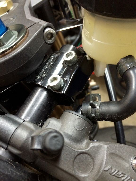

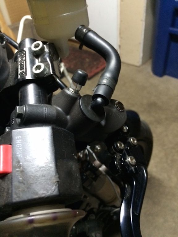

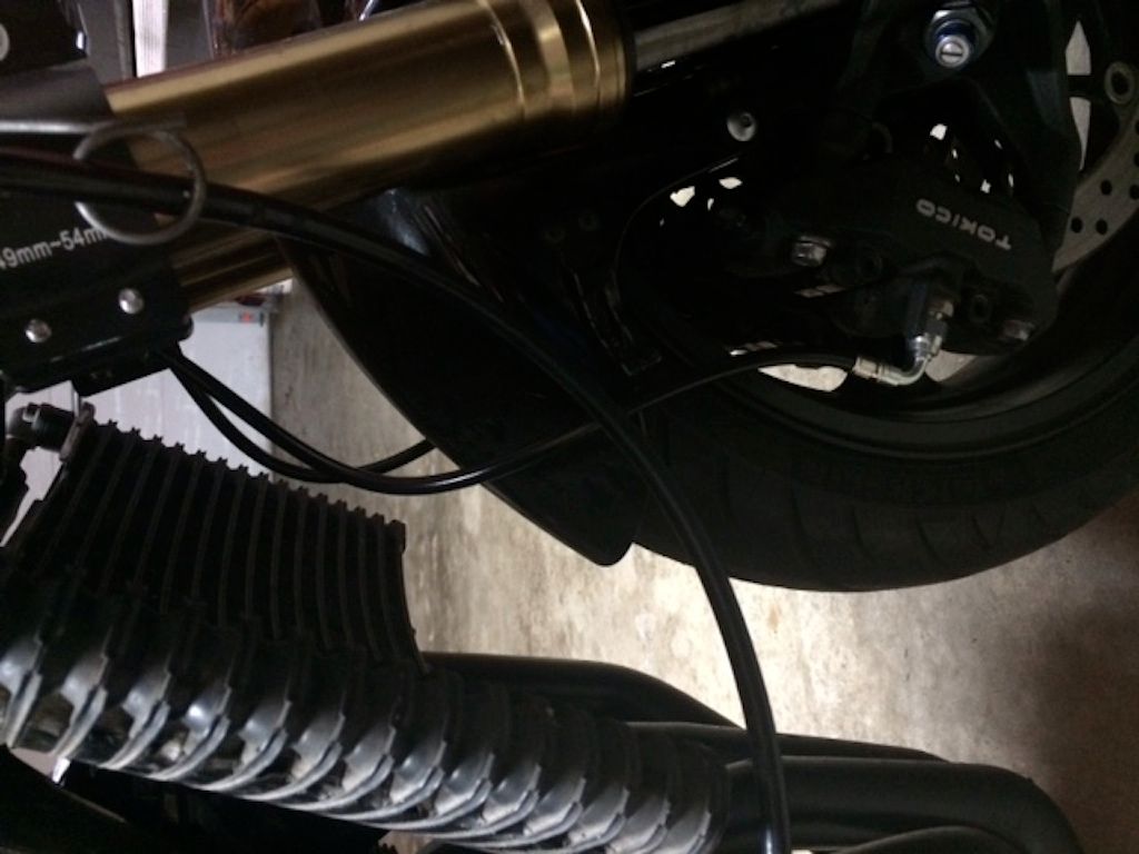

So, moving on the rest of the bike. That brake master kept losing pressure and I got tired of having to bleed the front every week. I have a 04-05 GSXR600 master on my SV that has been perfect, so I picked up another one for the Boiler. It even came with a shorty lever and has been holding pressure since I installed it :thumbsup:
Since I had turn signals on the back, I figured I'd put them on the front. Couldn't find anything that looked good, so I just got some stick-on LED strips and they happened to fit perfectly in the space between the lower triple and the headlight clamps. Not sure I like them much, and the front looks like it's getting too much stuff, but oh well.
And speaking of the front having too much stuff, the tach wasn't giving me very consistent readings, with the needle swinging back and forth. The higher it revved the higher the needle would go, but it wouldn't stay at the revs, and would keep swinging back and forth. I've been getting pretty used to the sound of the engine so I decided to ditch the tach.

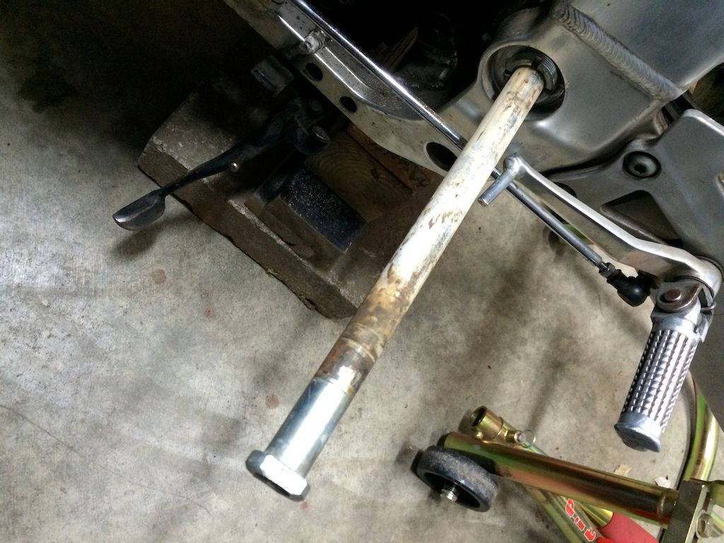

Wasn't as productive over the Winter as I wanted, but still got a bunch of stuff done. First, the SpeedoDRD came in last Fall and I got it installed. The speedo display has been working perfect since then.
Then I went on a 4 month hiatus, but once we started getting warmer weather, I got to work again. It was about time to get the rear end upgraded. First I had to get the old swing arm off which required making the tools to get the castle nuts off. I got a 32mm and a 22mm socket and cut out the parts so they would fit into the slots on the castle nuts. Here's the 32mm.
So, no wonder I had to pound the swing arm pivot bolt out.
And old swing arm off!
Had a heck of a lot of clean up to get this area clean.

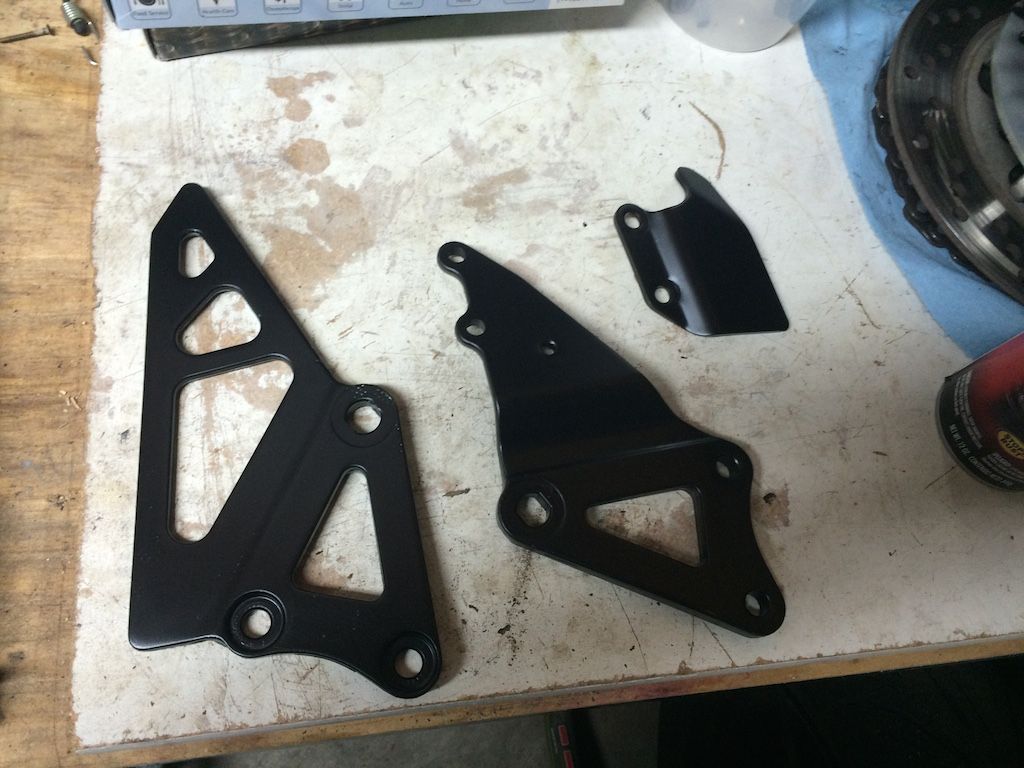

Then I got some painting done. I'm not happy with the high temp paint I used last year because it seems to chip easier, so I found some auto paint that I'm trying out now.

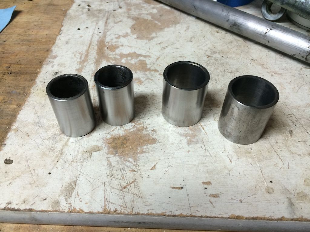

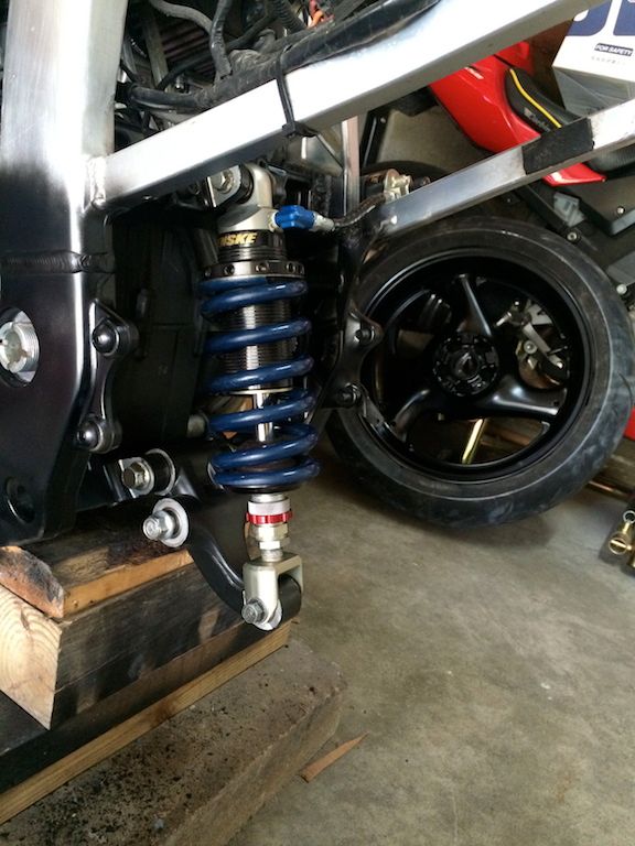

Then I had to get the fit right for my new Penske shock. The shock is a double clicker I picked up off of Ebay. It was for a older Yamaha, but I got it for a sweet price, so I had to buy new spacers for the top mount from Penske. I would have had to get a new clevis (bottom mount) because the holes were too big, but Penske wanted $126 for it. I ended up sending my clevis and mounting bolt to Zoran at TWF Racing and he had some bushings made for $40 total that pressed into the clevis mounting holes for a perfect fit on the GSXR. I also got some painting done in that area.

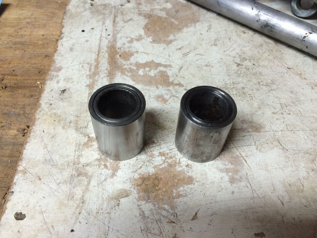

The key to fitting the '94-'95 GSXR swing arm on the '89 frame is with the bearing spacers. You have to slide the '89 bearing spacers into the '94-'95 bearing spacers so you can use the '89 swing arm pivot bolt. Here are the bearing spacers, '89 on the left and '94-'95 spacers on the right.
And here they are put together.
Then you just slide them into the '94-'95 swinger and it's good to go. Here it is with swinger and wheel installed. I was able to use the same axle as well.

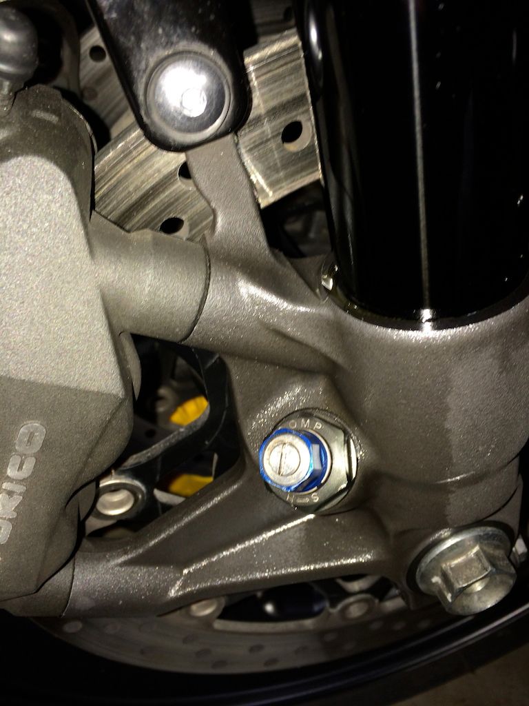

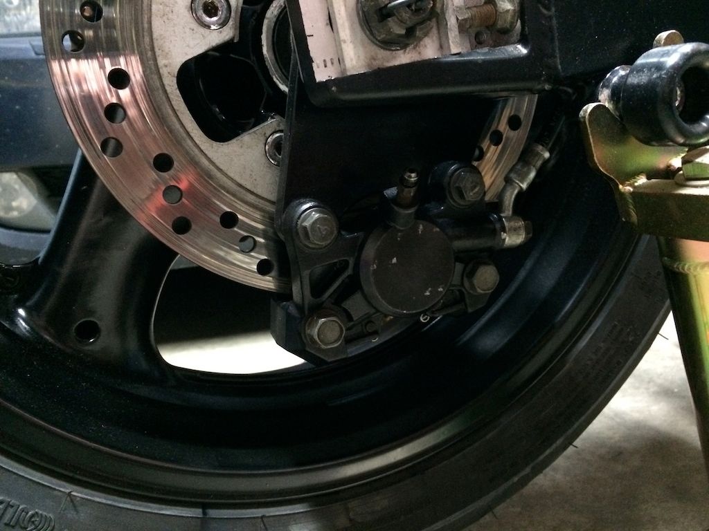

And picked up a new caliper to fit the new swing arm. The cool part about this, if you can see the stainless line, is that I was able to use the crossover brake line from the stock front brake setup for the back brake line.
I also ran into the problem of the '04-'05 brake master I bought last year crapping out, so I bought a new master that is the post-recall design with the bleed nipple and reservoir connection both sticking up. I just installed it this week and the brake lever feel is pretty good now.
