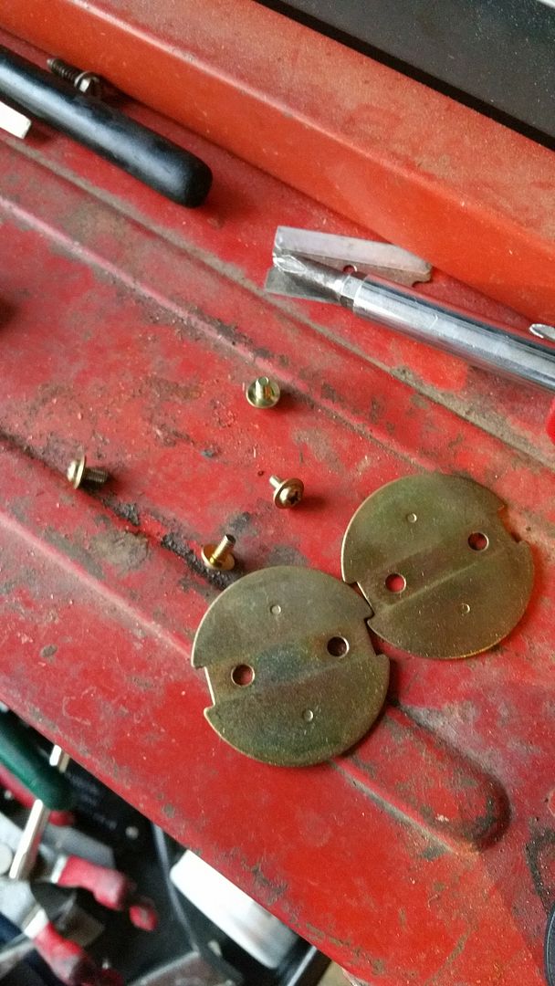

Also, I did my own version of the TRE without buying any resistors....
I broke the tiny resistors (yellow dots) for 1st, 2nd, and 3rd and then jumped them all to the 5th gear contact.
[/URL][/IMG]

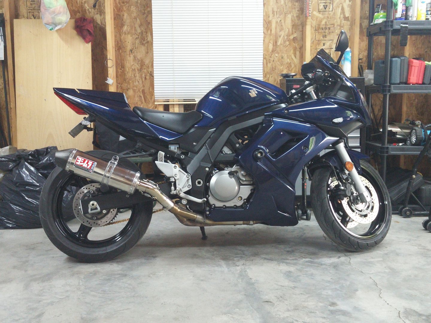

Finished my gsxr front end swap! woo hoo! well, mostly finished. I couldn't wait until monday for the clamps for the headlight and gauge cluster so I zip tied them on and went out for a shakedown ride :D
complete '08 gsxr1000 front, also fresh rubber front and back, and plasti-dipped the rear wheel to match the new black front.
(before)
