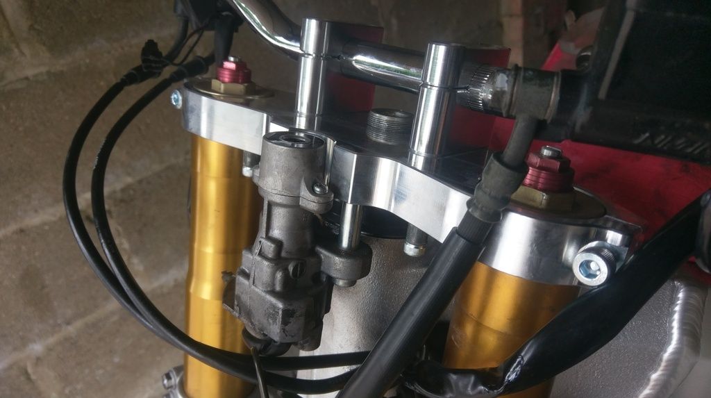

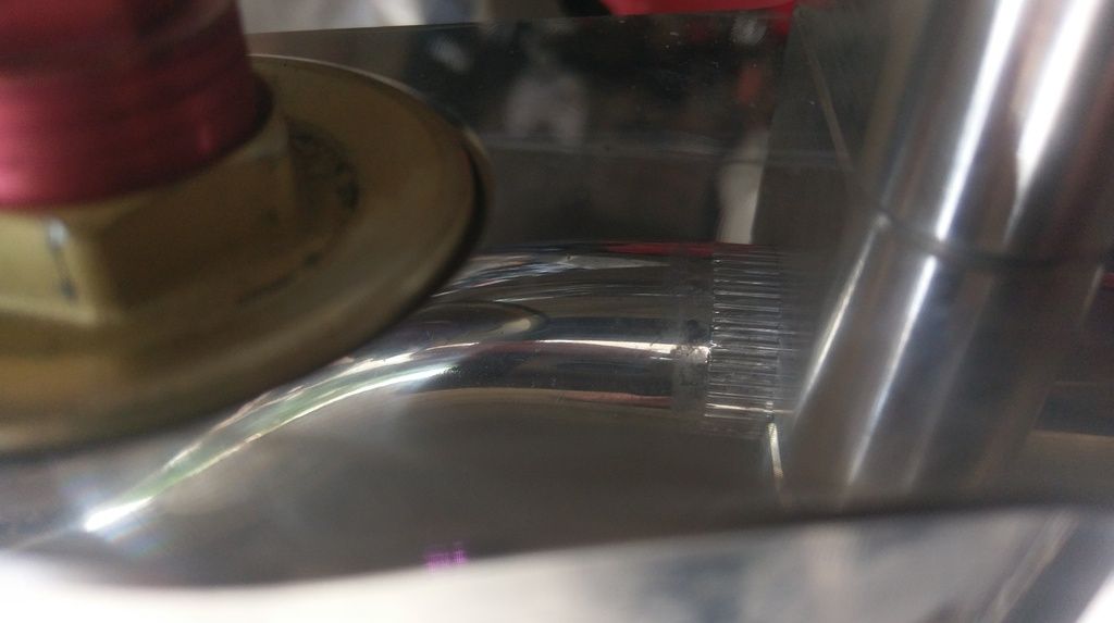

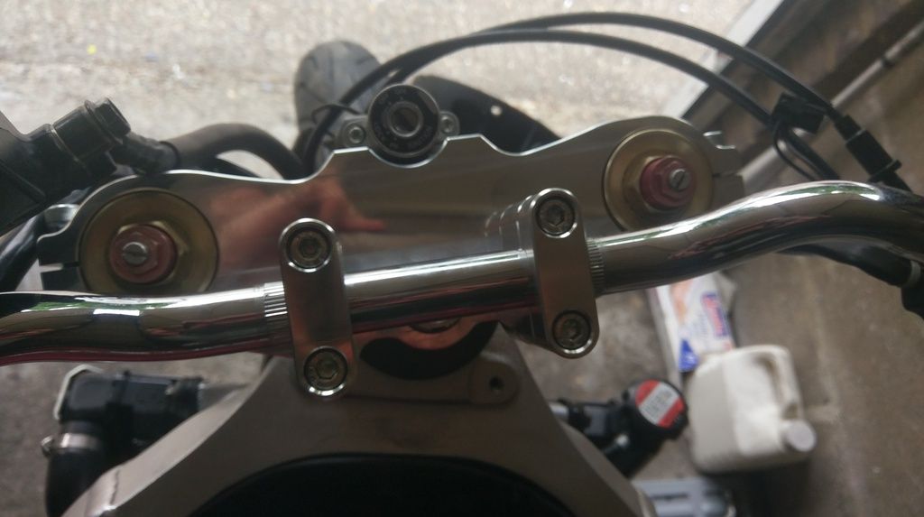

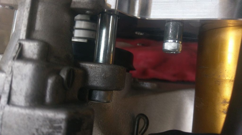

It was few months since we last talked. I am slowly collecting all the parts needed for swap while I am finishing resto build on my other bike. We parted out discussing china top clamps and lost functionality of steering lock with the swap.
While selecting clamp I had this idea I want to bring under your collective peer check. I selected clamp that is symmetrical with intention of flipping it up side down to be able to mount ignition switch on the right side.
Here are pictures of clamp I got:
This is a bottom up view:
Some minor tweaking would be needed, but in general what do you guys think?
