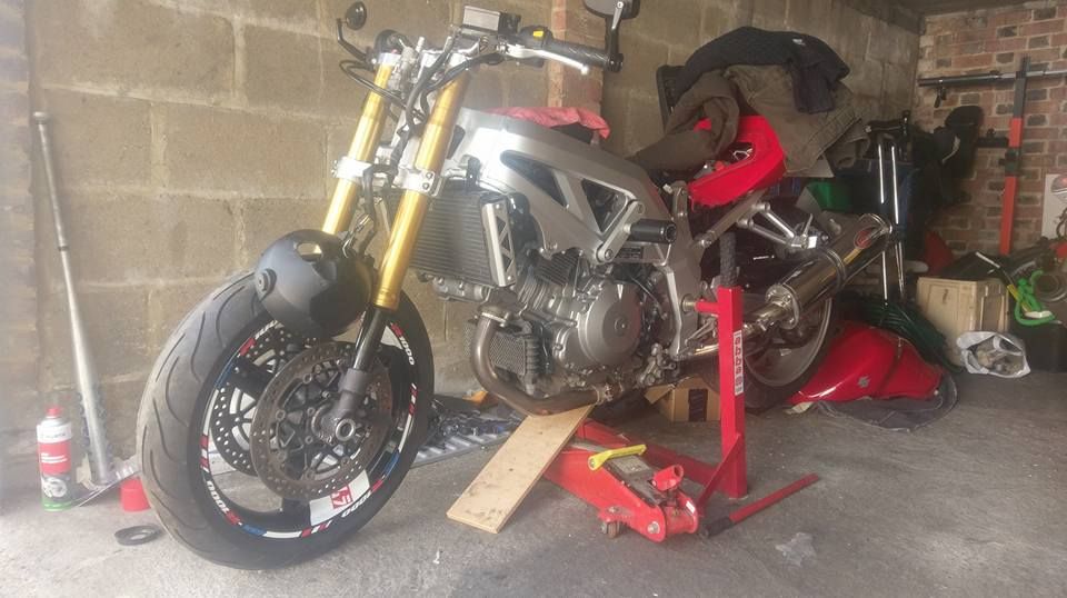

Hello all, hope you're well
I've got a K8 GSXR1000 front end lined up to put on my SV1000 (K4).
Am I right in thinking everything is bolt in, including the SV front wheel? I realise I need the front wheel spindle and lock nut from the GSXR.
Mine's an N model so I'll need to fettle about, getting the bars to fit and the clocks.
Let me know
Thanks

#887 ·
all balls conversion site will tell you if bearings are available. The other thing to think about is stem length. I can measure my GSXR stem for you this weekend :)
Otherwise it's just thinking how to bolt up headlight/indicators and so on. I just bought some clamps from ebay for 50-54mm forks
