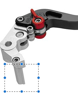

Discussion starter · #33 ·
Is your lever bent in the area shown in this box? I did a GSXR front end swap a few years ago and inadvertently bent my lever in this spot. It was bent towards the MC, so it never fully disengaged, causing pressure to build as I used the brakes all the way until a full lockup.
You were 100% correct- my brake lever was bent in this exact location and I can see how that would cause it to not disengage fully.
This is a serious problem and really demands the cause be known before rebuilding or going forward. The last thing you want to do is do some work and hope it is fixed.
You can tell if the return port in the master cyl is blocked by removing the caliper and use a C-clamp to retract the piston (just remove one caliper). When pushing in the piston you should be able to see the fluid level rise in the MC reservoir. If the piston won't budge, remove the brake lever from the MC and try again. If this allows the piston to move then %100 sure the lever is holding the MC return port closed. As mentioned, this can happen with a mismatched or damaged lever. This identical problem has been posted to SVR a few times.
If removing the lever does not free the system, try crack the banjo at the MC. If this allows the piston to retract then the MC return port itself is clogged.
