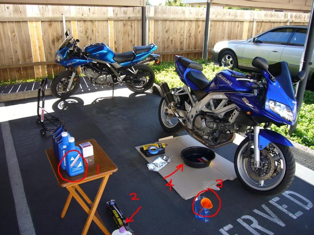

#14 · (Edited)
I actually enjoy doing the coolant on the SV.
Some basic tips...
- Use a deep pan (# 4) to drain, because the water/coolant will flow heavy, and splatter like crazy on a shallow pan.
- Using tinfoil, create a flat rectangular sheet, tape the top part just under the drain bolt, and have the end towards the drain pan. This will help minimize the mess when draining the fluid and flushing the coolant.
- Take off the radiator cap, and loosen the drain bolt, get ready, it will come out quickly. When it starts draining, use the palm of your hand to shield the liquid spray away from you and towards the tinfoil shield you made.
- Buy a gallon of distilled water (# 2) for flushing the coolant. After you remove the drain bolt and drain the coolant. Plug the hole with your finger, and add water to the radiator, remove your finger, drain until it stops, and tip the bike to the right to drain further until it stops. Repeat this step of filling, draining, and leaning until the water comes out clear, usually about 3 to 4 times.
- Drain the expansion tank. You will need to lift the tank, pull the rubber stopper off the expansion tank. Then on the right side of the bike, find the thin hose that connects the expansion tank to the radiator, it's held on by a spring type clip. Guide the hose around the frame and into your drain pan. Gravity should drain the expansion tank. Flush the expansion tank with some distilled water. When done, reconnect hose to radiator.
- Buy Honda HPD premixed 50/50 coolant (#1). It's $5 a liter, ready to go, you will need two bottles.
- Torque the drain bolt to 10-11 ft-lbs (don't forget the crush washer), add new coolant slowly until it reaches the fill neck. Tip the bike to the right for a moment, the coolant will "burp". Fill more coolant again until it reaches the neck, tip bike again to the right until it burps. This will take 3-4 burps until it won't burp anymore.
- Start engine without the cap on the radiator. It will burp further on it's own, keep adding coolant. Idle until about 150 degrees. Top off coolant, tighten cap, and fill expansion tank to the full mark.
- Ride the bike, make sure the thermostat is working, go at least 10 miles. Park and let cool, the coolant level will settle down in the expansion tank, top off one more time to the top mark, that should be it.
- To make adding fluid and flushing easier, use a long funnel and cup (#3), especially if you have a S model.
