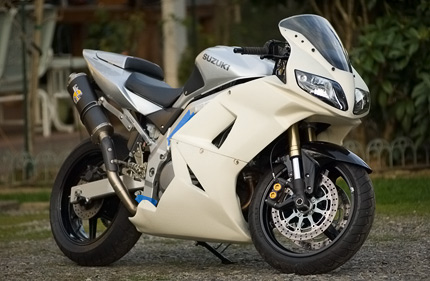

In addition to the handlebar conversion, I think my plan is going to be to start making a bunch of carbon fiber parts! I want to start by making the small plastic covers below the fuel tank (I see that someone makes those, but would probably be good to practice with) and a rear hugger based on an existing design, but with the chain guard part much shorter (I really don't like the look of the chain guard and I always wear boots). Along with these, finally I would like to emulate the idea of the Sharkskinz fairings, but in carbon, like this:
