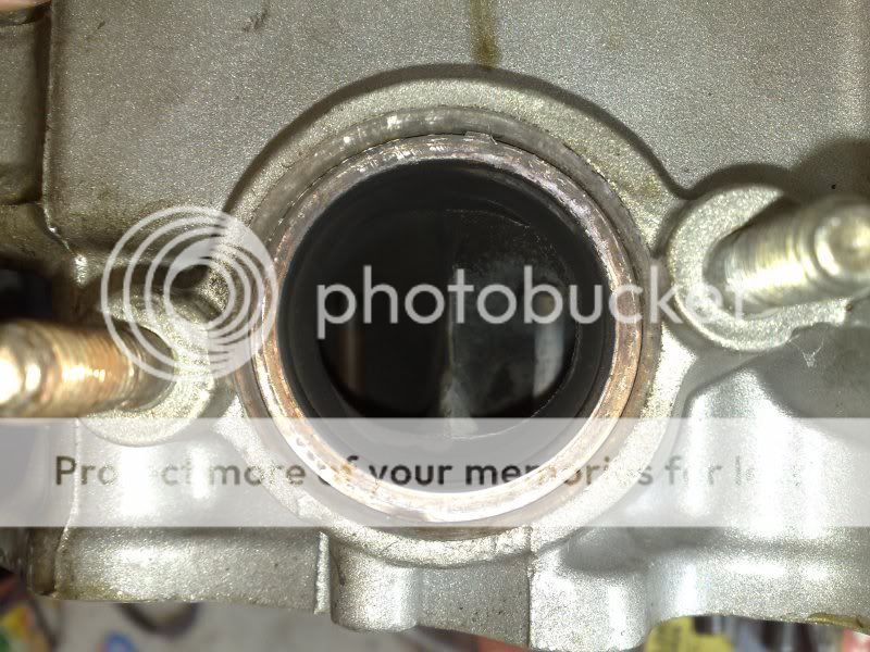

Basically I'm asking this due to a discussion on Korider.com. We were reviewing some pictures of a GT650 motor that has been torn down with 10,000km on the motor. Looking through the exhaust port you can see the each valve stem hanging in the pic and a good portion of the port. The GT650 uses a system called an AIS, which is exactly the same as the PAIR system. Since the GT650 is just coming out this year with Fuel Injection and I have been told that the AIS uses a single vacuum solenoid with a sensor connected to the ECU and two hoses to each cylinder, assuming its similar to the PAIR system on the FI SV's. The carb'd GT's use a dual solenoid system and the AIS is only dropped into one exhaust port, not both.
In the pictures, the AIS goes into the right side port. So basically the left side port looks fine, kind of sooty but fine. The right side port has a white look to it, a bit cleaner but with an ashy residue in the port. So the AIS is injecting the air into the right port, burning the excess fuel in the pipe. Obviously the air is on that side so it's coming out leaner. But if the popping is being caused by the extra air causing a lean state, wouldn't that also raise the EGT. If my theory is right, this would obviously raise the EGT because its burning excess fuel as it exits the ports. So the white on the right port is obviously an indication of higher temps, since leaning out will cause white residue. So basically, if the EGT is raised on the right port more than the left port than the right side valve stem is going to be hotter which would cause it to fatigue faster than the left. Basically, if the material used to make that valve isn't quite as good as Suzuki's the valve will wear faster and eventually break.
