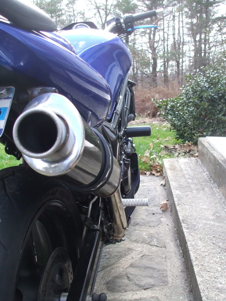

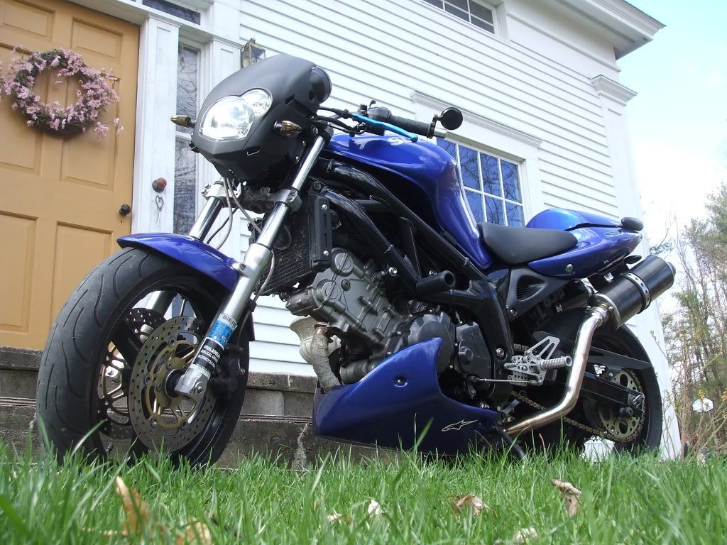

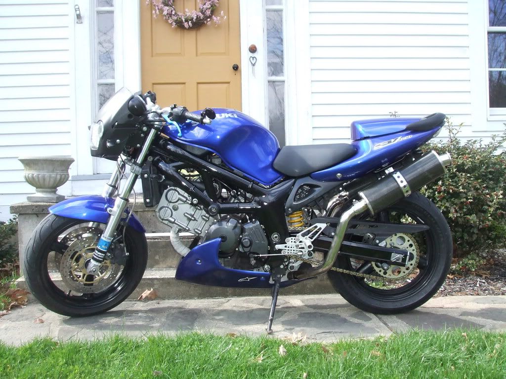

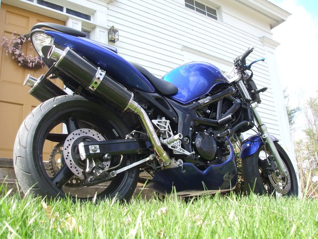

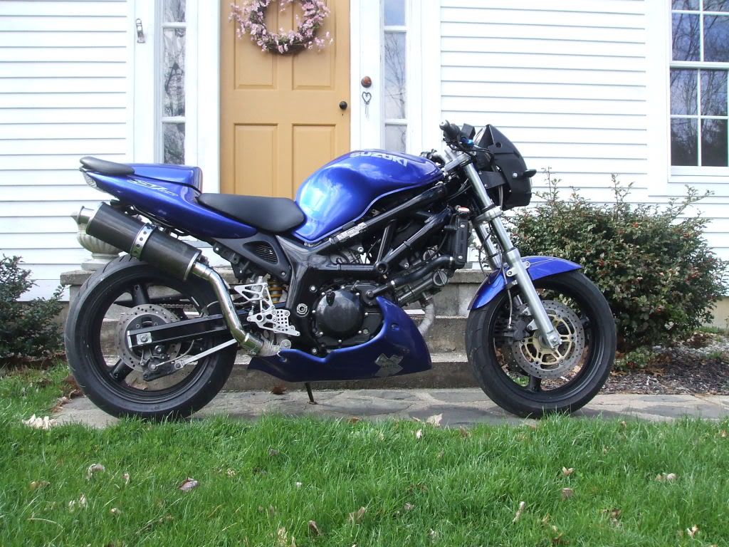

Well, after spending 9:00am to about 5:00pm in the garage on friday, and doing little things here and there, here is how she sits:
Still have a few things I want to do when I'm done with school for the year and get some $$ flowing. But this is how it is for now, I'm very happy with how it turned out! ;D

a dual exhaust on a 650? does that do anything for performance? I'm a n00b, not questioning you, but expressing curiousity.
Otherwise, nice work!

I likey...looks great....how about painting the rear brake support black as well

Thanks for the replies! Thought about doing the triples and fork legs, but I want to do a GSXR front end soon, so I held off.
My grab bar is special...it's the low more aerodynamic version :D
As for the Rens...the power seems to have increased for sure. I just had a ART Carbon slip on before, but now with the full system (sort of a 2 into 1 into 2) it seems to be a lot more responsive down low and pulls a tad harder through all RPM's. It's jetted and de-snorkeled.
Suspension isn't stock though. Front has .80kg race tech springs and 17w fork oil. Shock is off of a 636, with a SV spring (636 spring is way too stiff for me.)
