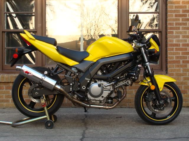

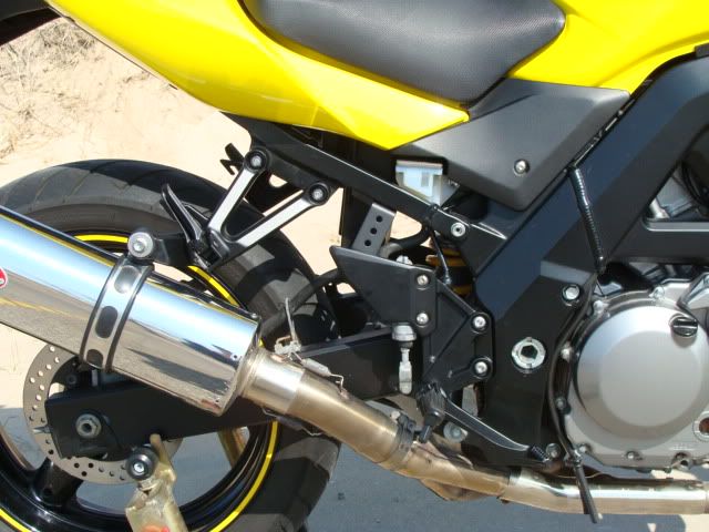

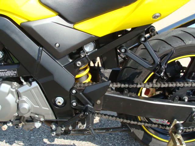

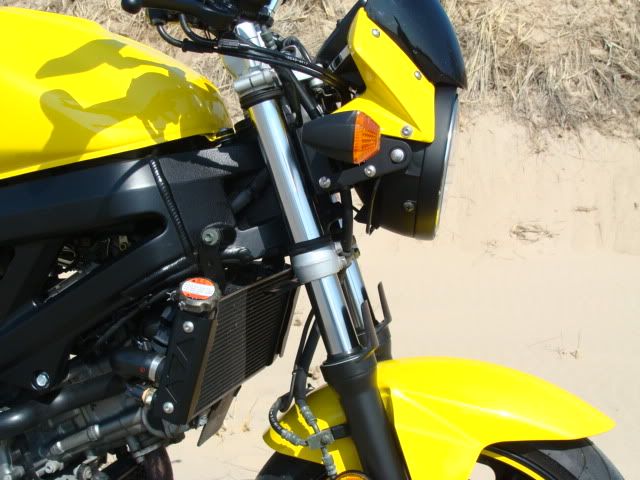

Sonic springs, 20 wt oil, GSXR 1000 shock swap, powdercoating of misc silver bracketry.
Before:
After:

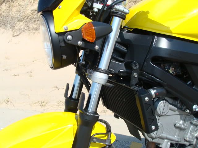

Headlight ring, headlight ears, and radiator shrouds

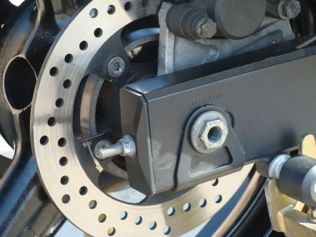

Chain adjuster plates and swingarm ends

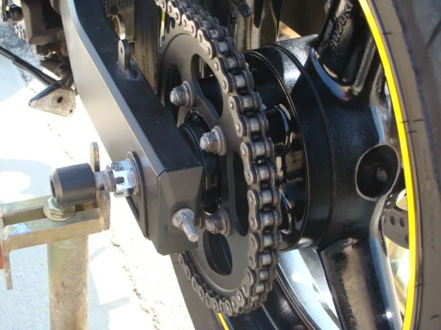

Sprocket and sprocket carrier
Oh, and I sprayed the fork tubes flat black to match.

Wow. That looks SO much better. I sometimes wonder what the manufacturers are thinking when it comes to their paint schemes. It's not like it costs more money to make it look good. Could I ask what you used to paint your fork legs? I would do the same to mine in a heartbeat if there is a good spray that will hold up. Or did you have them powdered? Great job.
381 Posts
Discussion Starter · #16 ·
I used Rusto Painter's Touch Flat Black. Sanded the tubes w/ some fine grit sand paper, to make them pourous. Then I put about 10 coats. Looks great, matches the frame/powdercoat pretty well. We'll see how it stands up to the test of time.
