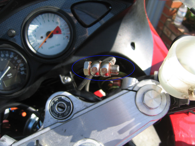

Yea it is. I picked up a mityvac and used it tonight. It worked pretty well except keeping the seal was a bit of a pain. Helped to have a second set of hands there to keep the fluid full. The stainless steel lines generally connect at the reservoir and run straight to the caliper. They just use an extended bolt so that both lines can connect:
