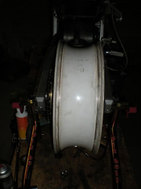

Fitted my 5.5" Marvic Penta magnesium wheel to the bike. It took a little machining of the cush drive along with 17mm axle adapters/spacers, to get the wheel centered. I also had to machine the caliper bracket to line it up, but I'm planning to make a complete new bracket so that is a little stronger and it stays lined up when the wheel is off.
