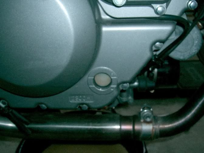

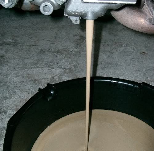

Hi SexYonMySV, How did your oil get like that?!
Wasn't really a goal. Had a track day.....didn't notice anything strange. The bike sat for a month...then I fired her up for this lovely VA weather and my coolant light came on. When I checked the coolant.....it was gone:eek:
I'll take the valve covers off next weekend...then the heads....ect....as I search for the issue. The engine sounds perfectly normal. So I'm hoping that it's a gasket or a freeze plug.

I'll pull her apart and take pictures. In the event that this happens to someone else.
Sexy, check your side gasket cover since the coolant is already gone and the oil is changed. There is a rubber seal under the water pump you should check just in case. It those are in tact, then dive into the heads.
