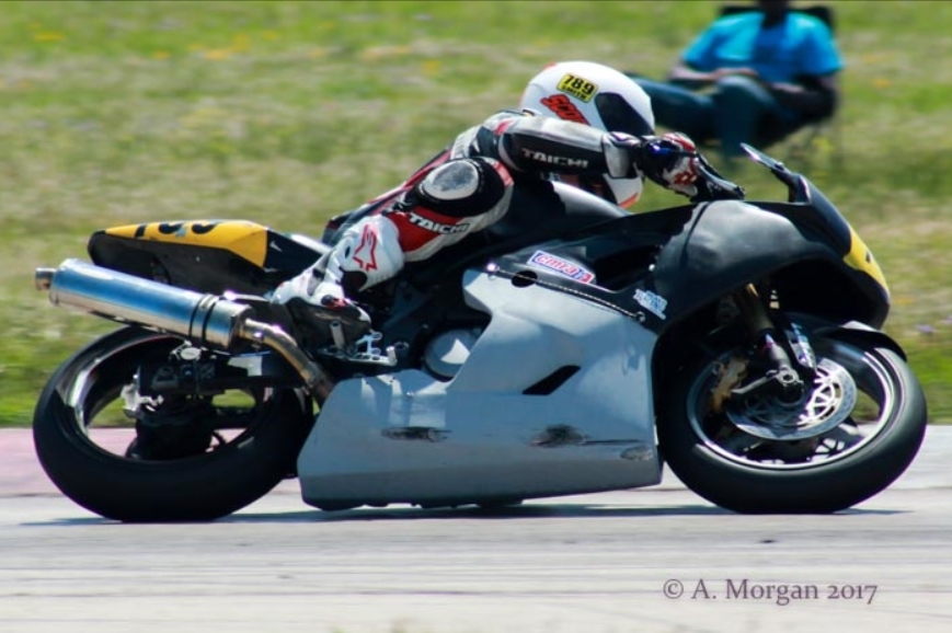

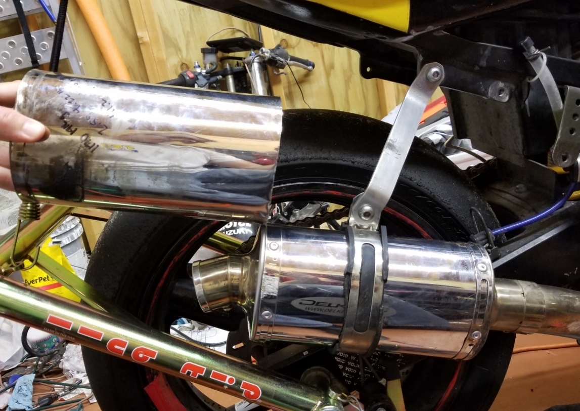

At the last race of our race weekend, my exhaust was barely hanging on by just the exhaust bracket and all rivets were broken. After a quick rivet job I made it back in time for the start, but from pit lane. Someone pointed out that the homemade bracket was too far forward putting a lot of leveraged force on the base of the exhaust. Decided to move the bracket to the rear mounting hole and for good measure, cut the exhaust down to just over half of the length, from 16" to about 7-3/4". More importantly is the side benefit of a little weight loss, over a 1/3 of the canister weight. For the benefit of US and Euro readers to keep you from having to convert, the weight loss is:
pre - 1916 grams / 4.22 pounds / 67.6 oz
post - 1170 grams / 2.58 pounds / 41.2 oz
loss - 746 grams / 1.64 pounds / 26.4 oz - 39%

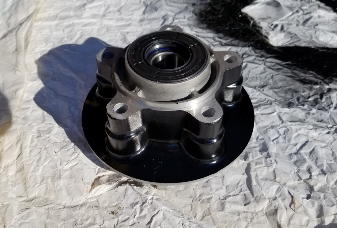

Also painted the sprocket hub black and the wheels white (no pic).
Before pic
After pic:
Hub:
