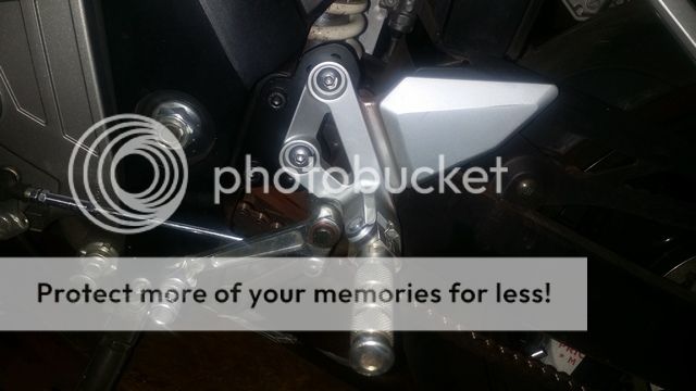

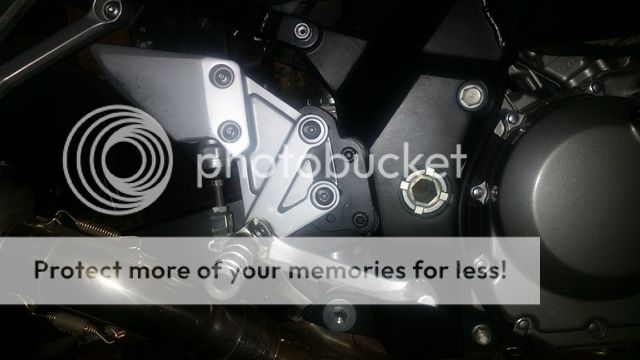

After removing the factory rear set I used my digital calipers to measure the hole spacing. I knew I wanted to go at least 1 up and 1 back. Then after drilling the first 2 holes I began marking the extra holes at a spacing slightly under 1/2 inch center to center around it. The holes were drilled then tapped with a M8x1.25 tap to match the hardware for the bike.
Then we cut them out on the band saw
After some grinding and modifying I painted it to match the bike frame. I forgot to take another picture after this, but I added more holes for more adjustment before installing.
Then I took a piece of aluminum tubing and cut it to 4 different lengths. Drilled the middle of the tubing with a #8 (5.055mm) drill bit and threaded the tube with a M6x1.0 tap. Then cut the threaded end of a grade 10 bolt off and threaded it to the appropriate length tube for the adjustment holes selected. And use jam nuts to lock it all together.
