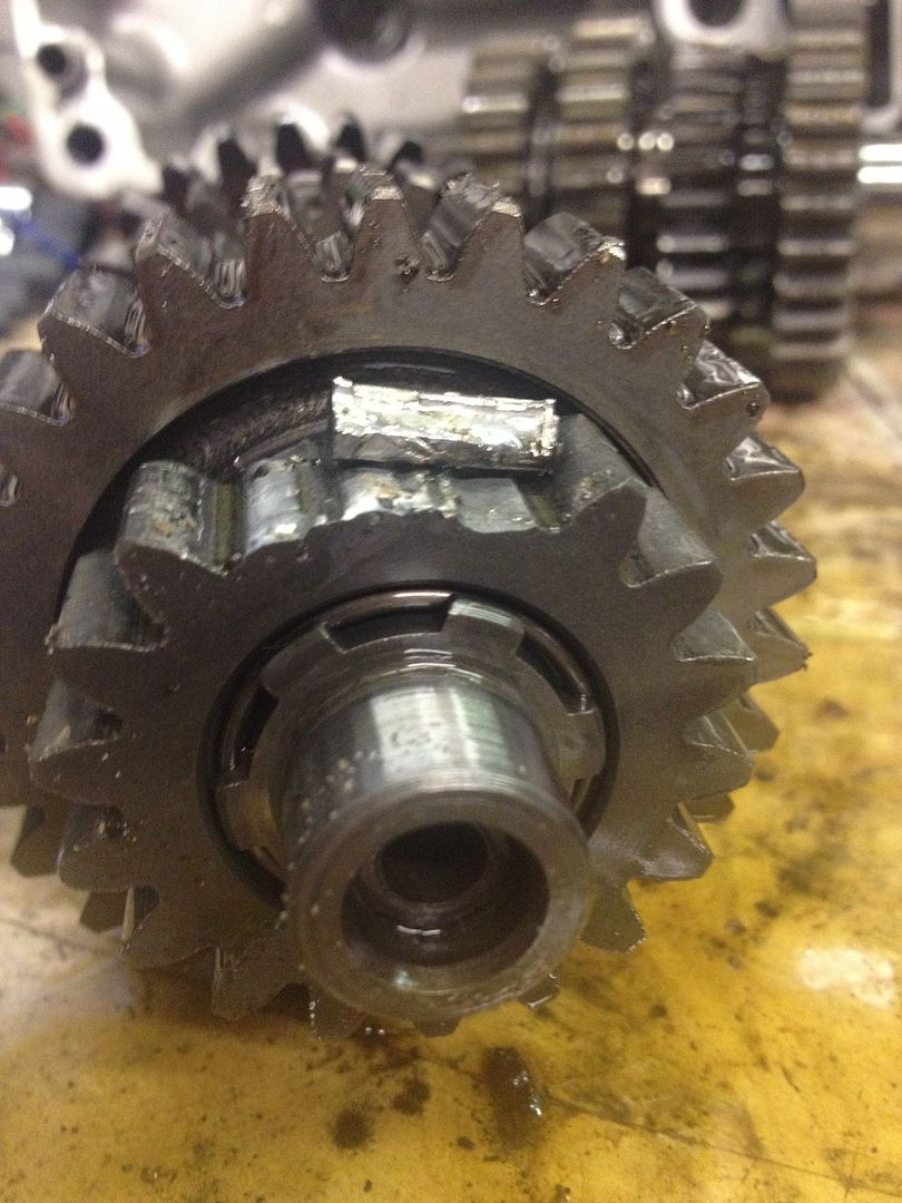

hey recoilrob.....that was my motor...and thats what i call #roblems....all i did was shift into 2nd gear going about 15-20 leaving class nothing crazy compared to other times....... the chain popped off... bunched on the front sprocket...and when that happened she locked up and shut off.

Been looking at that damage picture a bit, and am puzzled by the two worn down teeth to the left of the clean broken one. If I had to guess, it would be that the clean and shiny nubs had been broken for quite a while and had been shined up by contact...then when the chain snapped it shocked the last one which broke off clean. Would be interesting to see the mating gear on the other shaft.:) Forgive me....I just LOVE looking at stuff that has Given the Ultimate Sacrifice.
