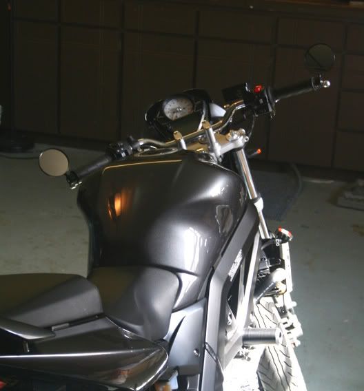

Ok here's the pics as promised...please excuse the crappy quality as my camera is toast. I guess I know what I'm getting myself for X-mas!
First the DougZ spools
Custom radiator cap!
Just some general photos
As I said, my apologies for the crappy quality but you get the idea!
