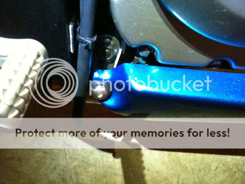

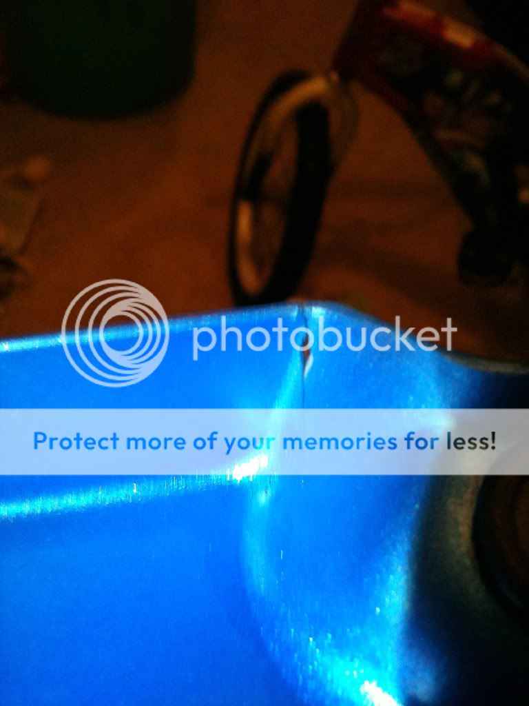

So I had a small crack in my fairing for a little while and just now found time to fix it. Note that I am no mechanic and this is my first time "Plastic Welding". Sorry for the cell phone pics, that was all I have.

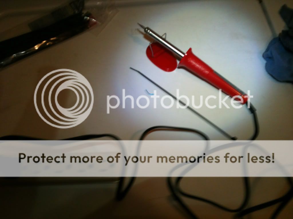

Tools:
Soldering Iron
Zip tie
Tools from bike tool kit
Nail polish
Goal: Repair the crack in the fairing.
Plan: Take fairing off for easier access to the crack. Repair using a soldering iron and a zip tie. Touch up with nail polish. Then replace Fairing.
So here is my starting point.
So I started by taking the fairing off. Not as hard as I thought it would be. Now here she is as naked as she will ever get.
Next I took the fairing to my "work" table. Here is my tools
Here is my starting point

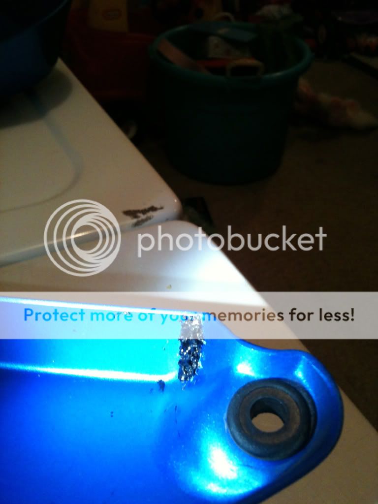

So I took it slow. Melted the zip tie onto the crack from bottom to top starting with melting along the crack then quickly filling it in with the zip tie. Then filled in gaps I missed. Probably would be better if I had a flat tip on the iron instead of the point, but I only had. At the end I had a glob of plastic. Not pretty, but it is on the inside, so no big deal :)
The aftermath
Next I touched up the out side with a little nail polish I stole from my wife's stash. Shh don't tell :) . I didn't want to spend a lot of money for such a small area that was basically out of site.

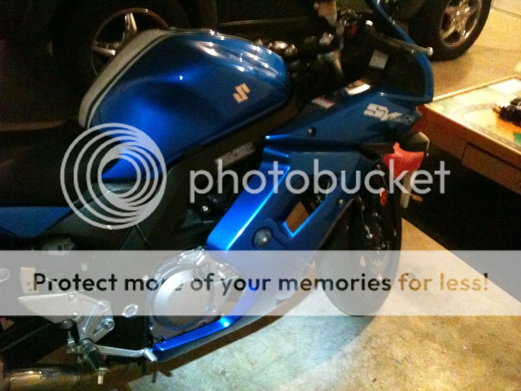

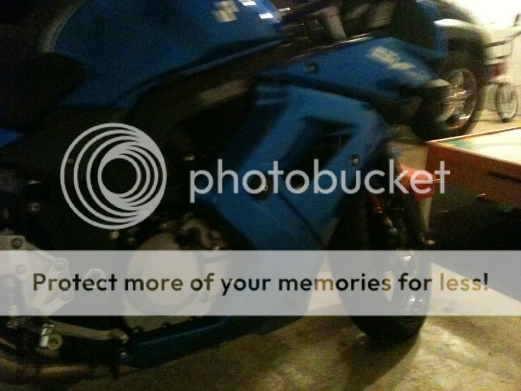

Next I put the fairing back on. This took a bit to get back on. Those plastic fasteners are a pain. But here is the final results
up close
Hopefully I did well enough for it to hold.

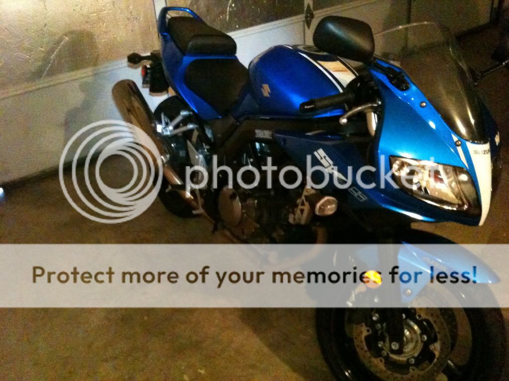

Yesterday I Got me a 99 naked and swapped over my new tires and all good parts from my totaled out 2002 S!
ALL Brake parts
Tires and wheels
Kickstand springs
Foot brake springs
Quick Release seat and tanks bolts
Yoshi Exhaust
Gas tank cap
Tool kit
Fender Eliminator
I'm sure there is more but its ready for the junk yard to pick up Monday afternoon for the price they paid for it.
