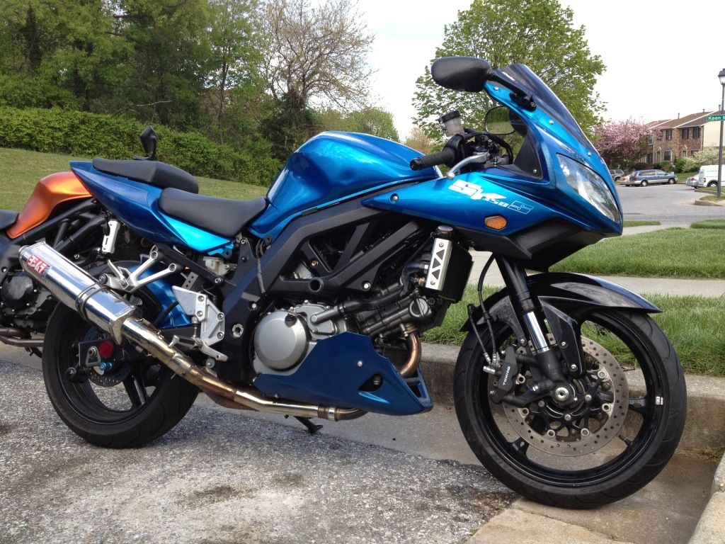

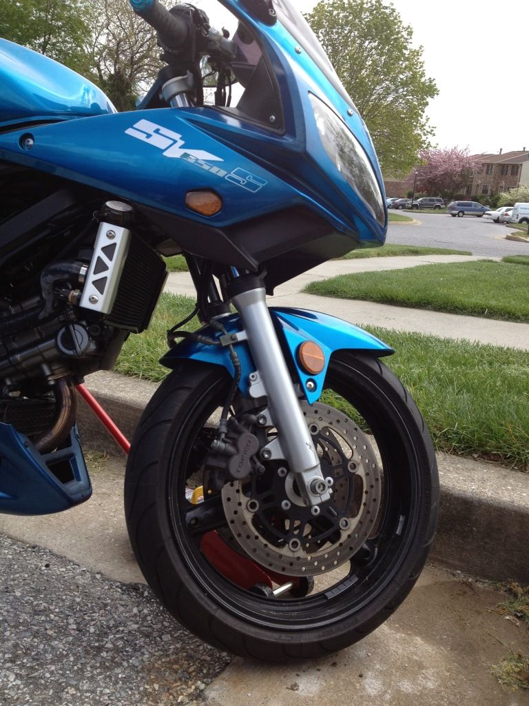

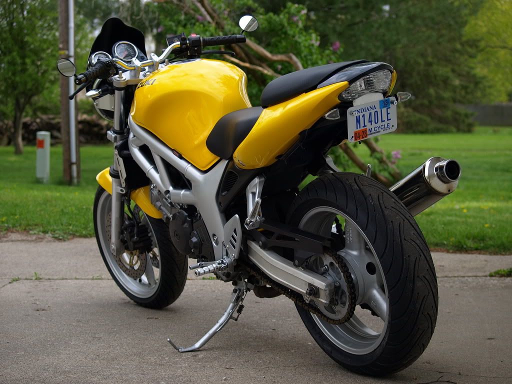

went from stock front end:
to:
to not stock:

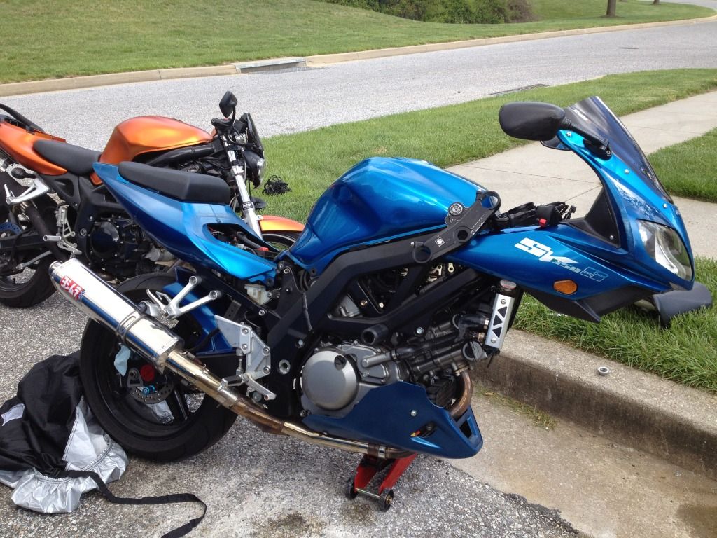

How are you supporting that with just a floor jack??
magicsauce!!! ;) :p
well, not having a garage, i had to figure out some near-comical balancing acts... then i figured out which ones were stable. :rock:
with jackstand supporting/lifting just behind oil filter with kickstand down, one can easily rock the bike back and forth shifting weight from forward to rear. it naturally is front-heavy so when the forks (or even just the wheel) is taken off, the center of gravity shifts to make it rear-heavy. 3 point of contact are rear wheel, kickstand, and jack. it was surprisingly stable actually.
