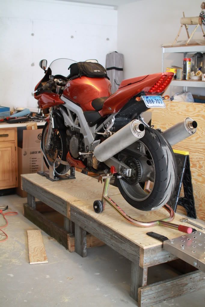

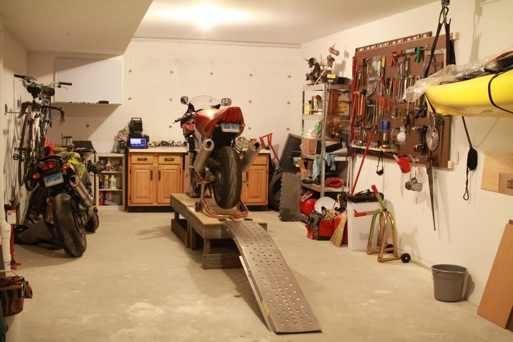

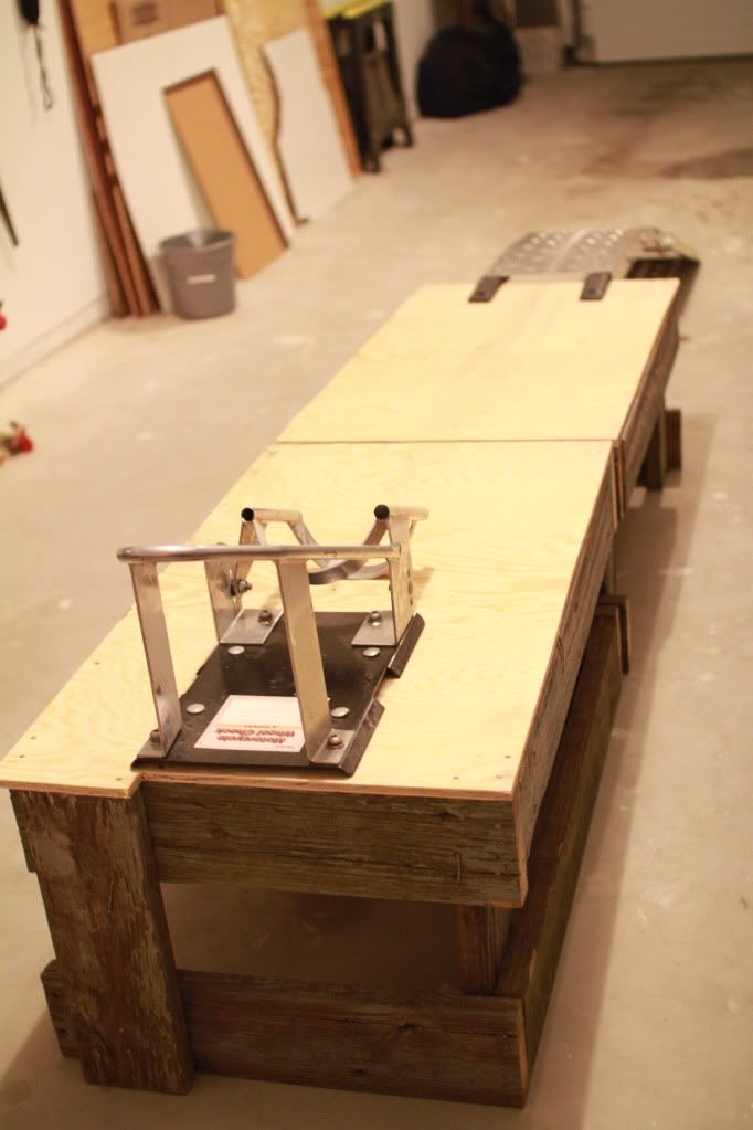

Built a motorcycle table for the garage. No more crouching down to work on the bike. Total cost = $0. I found the 2x6's out in the woods and left them in the garage for a few weeks to dry, the plywood was from a failed project, and I had the wheel chock already from a plywood insert for my truck to haul 2 bikes in the bed.
Nice table.

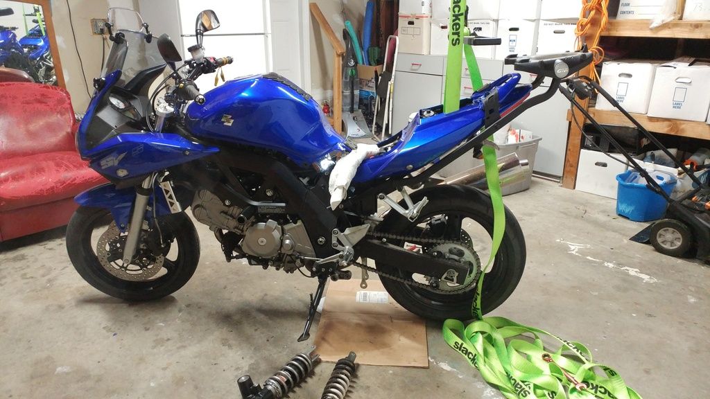

Took off my forks and installed a pair of Ricoh Intiminators. Hardest part was cutting the spacers. I'm only a hack at bike wrenching but I have a lot of tools and other mechanical experience. I thought I was just gonna whip out my copper plumbing cutter but it was just a little too small and made the spacer slightly oval enough to want to spiral. (If you've done a lot of copper sweating you will know what I mean.) Fussed with a horizontal band saw for a bit trying to get the little sucker to stay square to the blade and dressed it up on the belt sander. All good, just took longer than expected.
Wish I could get out and ride to try them out but now its dark and rainy.

It stopped dumping long enough for me to get out for a short ride with the Intiminators. First thing I noticed was no clattering coming from my aftermarket fairing as I started out on the dirt road I live on. No clack as I hit the speed bumps going to the country market. The stock suspension is weird. Soft and harsh at the same time. It unnerved me. I'm 145lbs in gear so I didn't think I needed springs or anything. Bike feels much more "right" now.

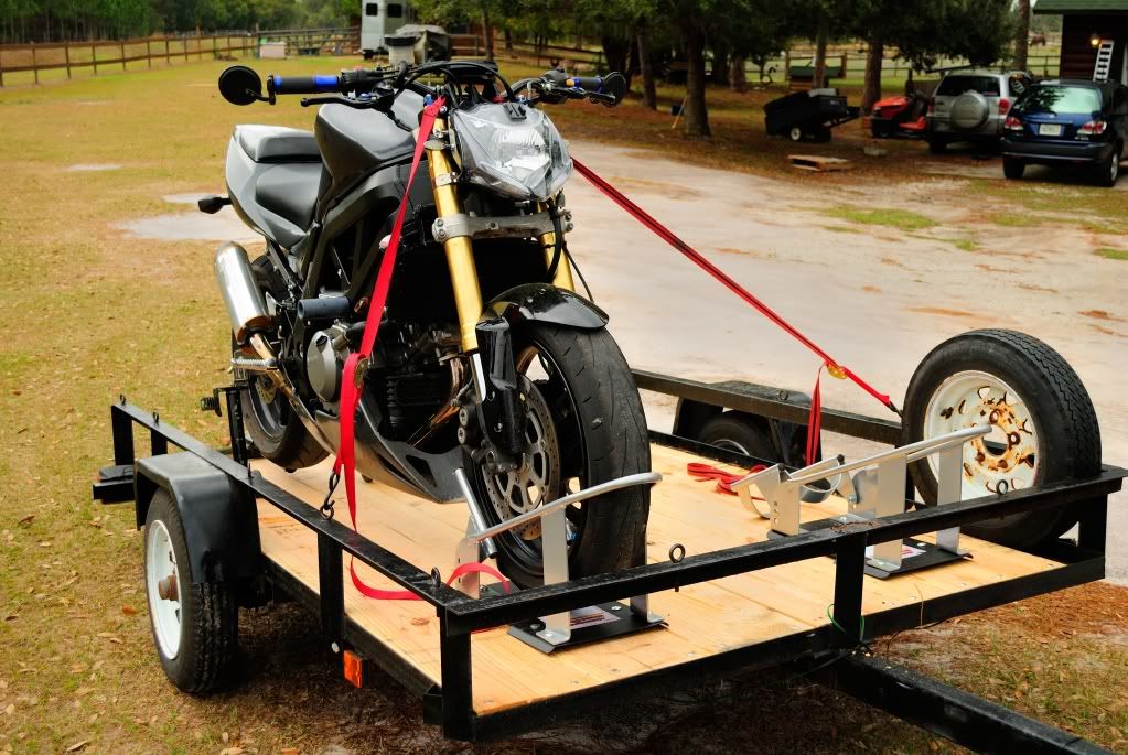

Well not to, but for the SV (and Mattman912's SV come march 23rd):
Hooked up the ol' 200$ 5x8 trailer with a new floor and HF wheel chocks that were on sale for 25$ a piece
