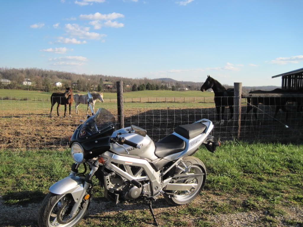

Popped in the battery. Drained the excess oil from the winter fill. Wiped it down with handy-wipes while the engine idled. (started up first try and ran smooooth ;D)
Since I also got a new tire on Connie's bicycle, we can now expect 3 weeks of rain. (which starts today. :( )

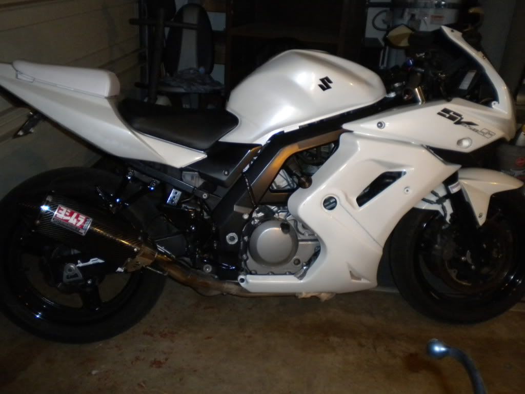

Swapped from drag bars to bikemaster superbike bars. New levers. New clutch lever perch. New clutch cable. New iridium plugs. Checked valve clearance. Serviced the K&N air filter. Checked drive chain slack. Road it for an hour to make sure I hadn't ruined it.
Roughly 7 hours including the test ride. I feel like I really know everything I should about her. Still need to do a TPS adjustment and rectify the clutch switch bypass I discovered today.
I'm going to sleep like a man without a worry.
