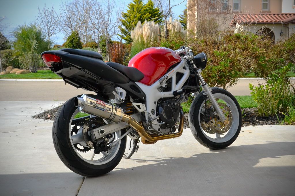

Tried on the new tank that wife gave me for my birthday ;D

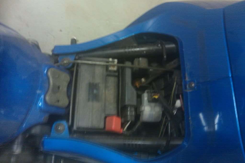

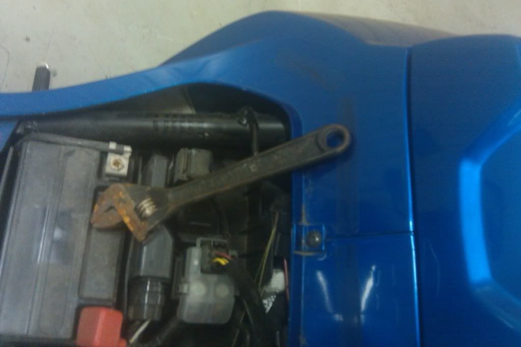

Replaced my brake lines with Galfer SS brake lines. Installed new brake res from Vanzuki that eliminated the line running inside the tail. Also added a spring and catch at the rear master from Vanzuki. Link to website if you are interested. http://vanzuki.com/blank.html
Also installed new rear sets from Blair @ SVRacingparts. Took the bike for a test ride and absolutely love these rear sets.
And last but not least I put my new undertail and taillight in. For some reason it's not lining up right. I have to take it back apart and try to figure it out, but I'm running out of daylight.
Also, yes I know my bike is dirty. All the damn snow is melting and turned my alley into a mud pit. Don't worry, it got cleaned (as well as the garage) after I took the pictures.

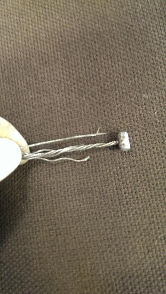

It started on a ride yesterday. Somewhere around the top off blood mountain I felt a pop that came from my clutch lever. I lost about half my lever sweep and it was a hard pull. I took the bike home and found that three or four strands on the clutch cable at the lever had come loose. Lucky I had a spare ready to go in.
So today I pulled the old cable and the clutch release mechanism.
http://i145.photobucket.com/albums/r227/tylergreyday/IMG_20140310_175836_zpsdapce44u.jpg

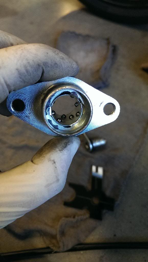

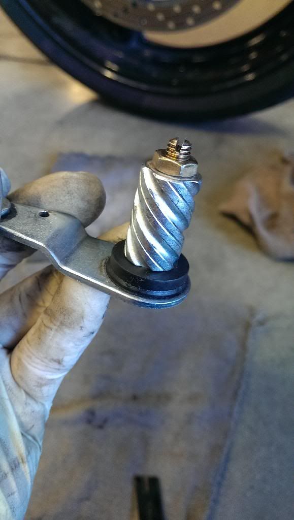

And cleane the release.
http://i145.photobucket.com/albums/r227/tylergreyday/IMG_20140310_175308_zpstxntwvho.jpg
http://i145.photobucket.com/albums/r227/tylergreyday/IMG_20140310_175216_zpshk6fth30.jpg
Lubed it all back and adjusted everything by the manual and using that little nifty clutch adjustment template. It feels soooo very smooth now!
