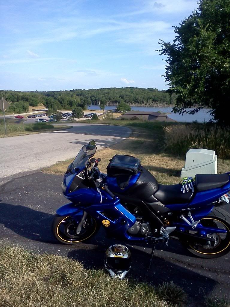

I don't care. I have a build thread that I guess I could copy into here, or people could just go look at it to see what I've done to my sv over the past year. Today I rode it and that's that. If it has to be item related, I took it off of my brand new SVRP stands before the ride :p
