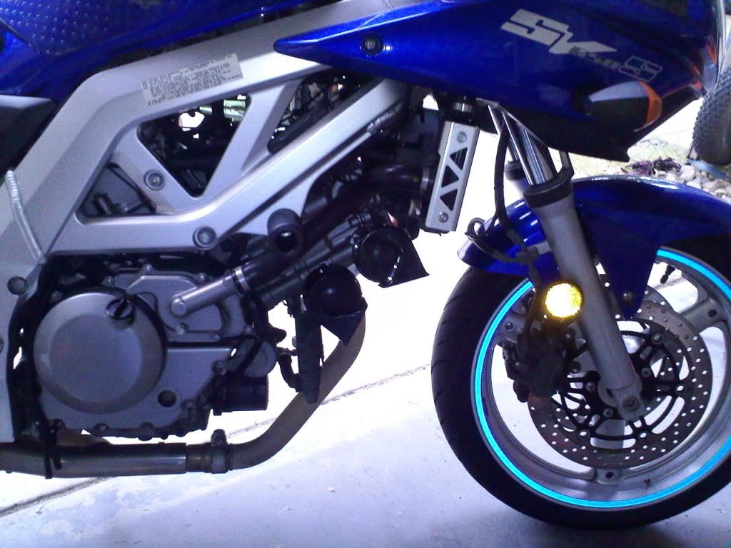

Fabbed and test-mounted a bracket to hold my pair of Stebel TM80 Magnum horns I just got. Found a nice place on the right side of the engine behind the radiator and above the oil cooler. Was trying to figure out a way to hide them in my fairing but I couldn't figure out how to get the bottom off and how to mount the horns. Also started looking for a place to put my SVR stickers I got today...woohoo!
Whoa... you put TWO Stebels on there?!?!? That things gonna sound like a freight train! :D Cool.
Yeah, I love em! I spray painted the bracket this morning and mounted the horns to it tonight and made all the horn connections too. Zip-tied the wiring to the back of the bracket and now I'm just waiting for a day I get off early enough to open up my bike and install the relay onto my cat5 harness and hook it up to my stock horn connection.
I couldn't resist...I gave it a couple test honks in the garage with my 12v drill battery. My family heard it and laughed cuz it was so loud and asked me to come in the house and honk it a couple times...lol. Methinks that the next time someone changes lanes into me, they will definitely learn that I am there...lol
BTW...I got the pair at hornsplusauto dot com for $20 plus shipping...way better than the $40 + shipping everywhere else. Got em in a week.
