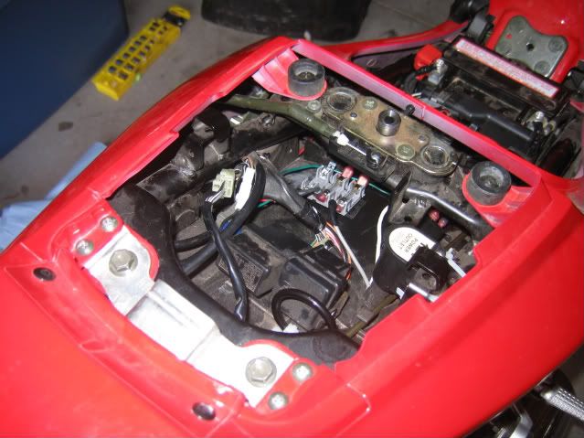

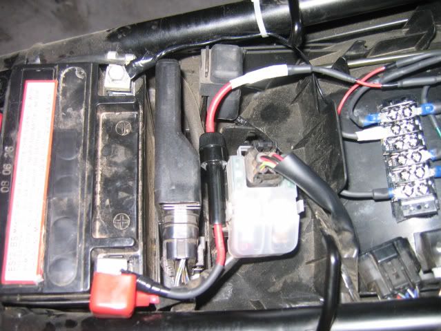

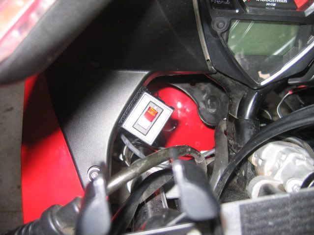

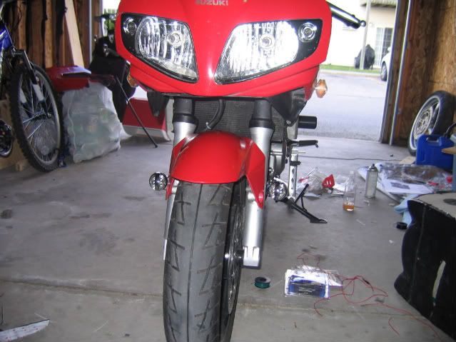

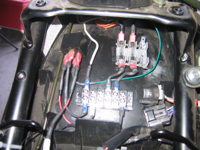

Installed a distribution block and relay per canyonchasers write up, only I added a fuse block to it. Also wired up some driving lights to where the front reflectors used to mount. The relay allows the power to be on only when the key is one. Took me about half a day to do it, but I'm pretty happy with it. The only thing I'm not sure about is the switch mounting spot. If anyone has any ideas that don't require me to cut big holes in my fairing let me know.
Zach
The obligatory Pics ;D
The distribution block, relay, and fuse block are held down with adhesive backed Velcro.
There is a 20A fuse connecting the distribution block to the battery and 5A fuses connecting the distribution to my cig plug and to my driving lights.
With the plastics back on
The view from the trunk and yes I can fit my hand in there to replace the fuses.

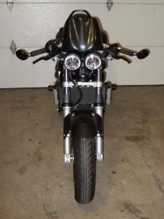

Front view of the new lights.
The switch mounting location. I like the spot, just not the way it's mounted and I'd like to find a waterproof switch for it.
