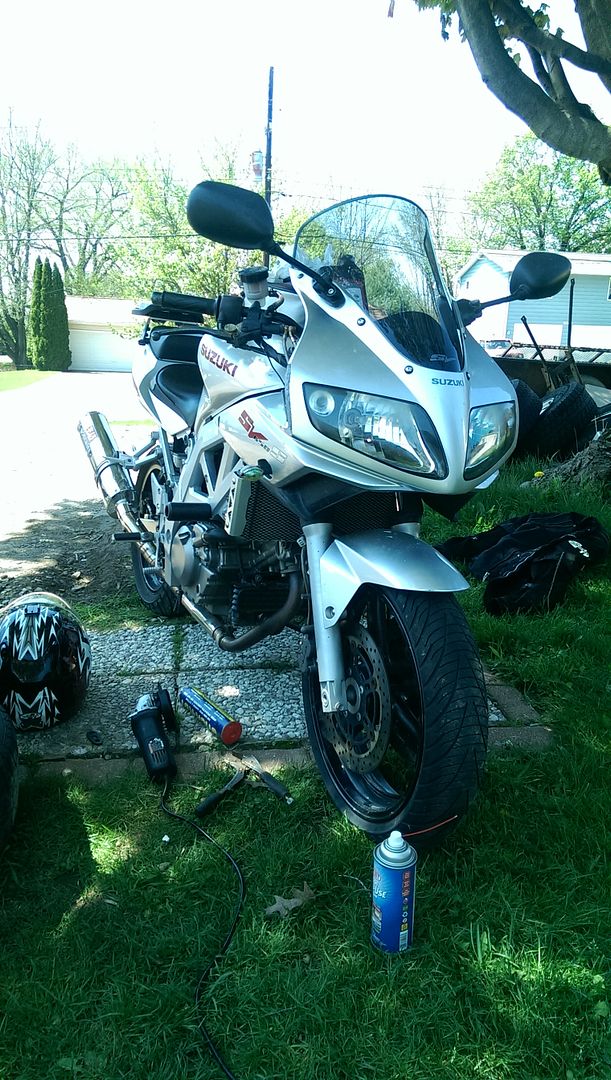

Today, I pulled her out of the garage for the first ride of the season. Started by checking and adjusting tire pressure, I then did a quick check over everything, looking for loose fasteners or anything out of place, checked the oil, lubed the chain and loaded the tank bag with some basic tools and zip ties, just in case, then went out for a nice long ride. About 52 degrees, sunny and did 160 miles through some decent country roads, including about a mile or two of dirt road so we could look at a camp for sale. Was a great day!

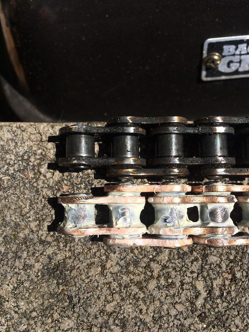

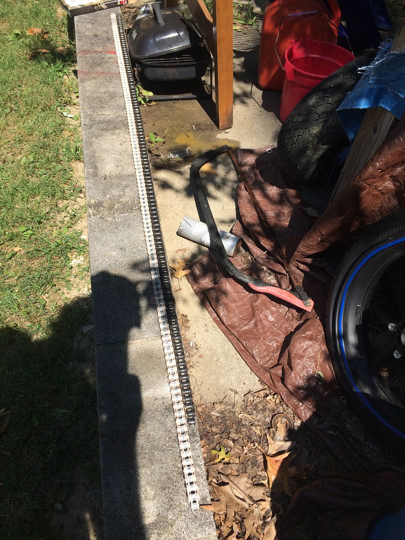

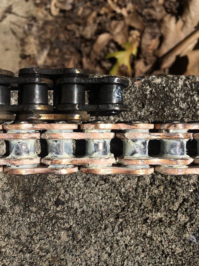

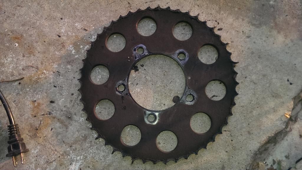

Yesterday I cut down and cleaned my chain while it was off the bike. A couple months ago I did a stupid move and had the bike running in gear while lubing the chain and hit the kill switch before putting it on neutral... It sheared half the teeth on my 47 tooth rear sprocket so I swapped in the stock sprocket and havebeen riding with a sloppy chain till now.
How did hitting the kill switch shear teeth on your sprocket?
The wheel and tire were spinning at probably 15-20 mph and hitting the kill switch stopped everything immediately. The rotating mass of the wheel, tire and chain snapped off the tips of the teeth. It was a hard anodized aluminum sprocket so I'm sure that played a big part in it since the aluminum isn't nearly as strong as steel.

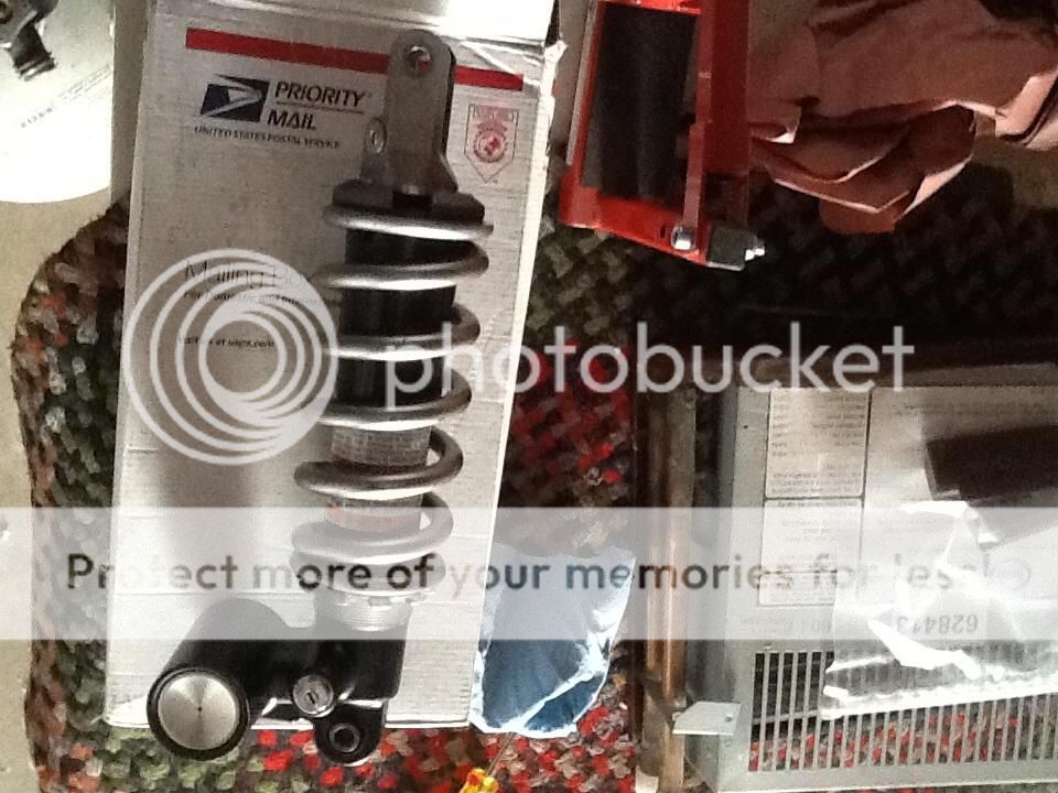

This afternoon and evening, I took out the stock rear shock and pooped in an 06/07 zx10r shock. Woke on there, I pulled the wheel and degreased as much grime as possible then put it all back together, set the sag and went for a short test ride. I didn't notice a huge difference yet but I only rode a couple miles.

This is what the rear sprocket looks like after the aforementioned mishap -

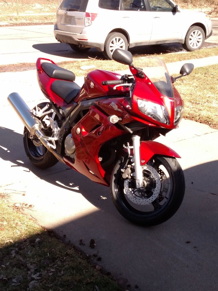

I checked your pressures and then pulled it out of the garage and hit it with some rubbing compound and wax to shine the paint up again. I had my 2-1/2 year old little boy helping me and he loved it!

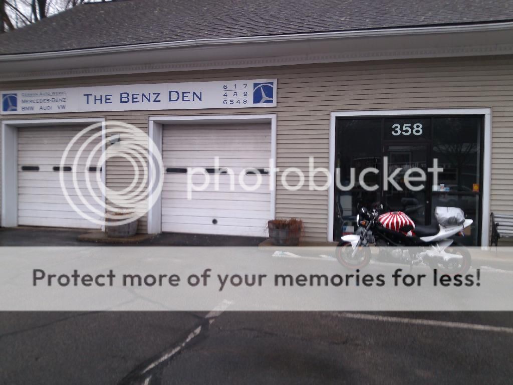

Got it inspected. It's been a couple years since I took the time to take it in for annual inspection. This is the first season in quite awhile that it's looking like I can ride a little bit.
Come on summertime!
