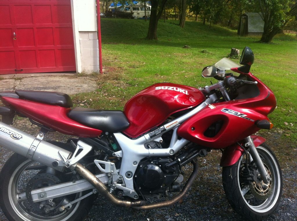

I bought this 01 SV650S March of 2012 after my younger brother had bought it and laid it over. He wanted to sell it on craigslist for $1500, I told him I would be right back. A quick trip to the bank and the SV was all mine.
This is how it looked when I got it
Ran great, some busted plastics but all in all a good deal. I knew eventually I wanted to fix the plastics, I just didn't realize how much of a pain it is to find 1 gen plastics in decent condition.
