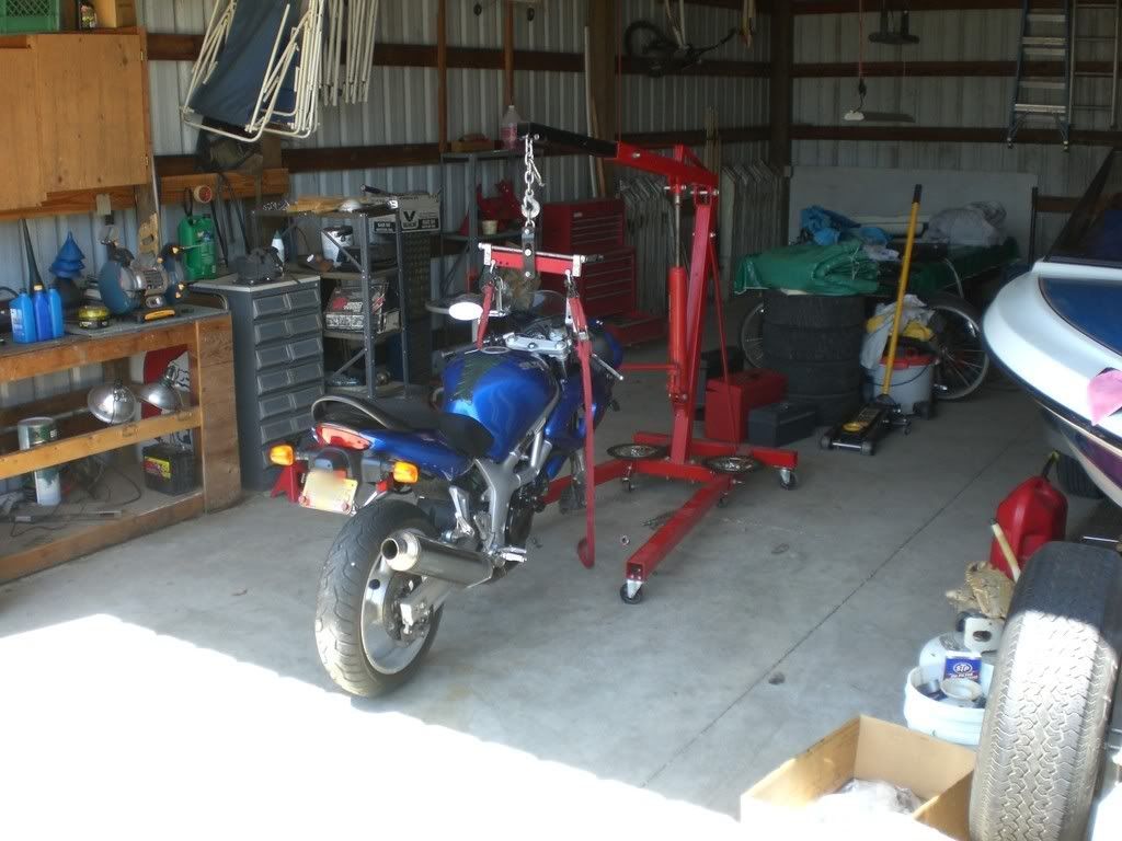

How can I suspend the front?
This is how I usually do it...
Can you work those straps to the lower triple and suspend? Or the headstock?
The weight of the bike on the front wheel might be the limiter here, paralellogramming the forks to the headstock creating too much pressure or friction to remove without suspending it.
That was a pic from a long time ago. The bike is together. I'm just fixing/replacing/and changing some parts on it.
Its got the front wheel on it now. But thats usually how I suspend it.

Even a floor jack and some wood under the engine, just to alleviate the weight from the wheel/forks. Give it a try.
Yeah, I'll definitely give that a try. Thanks!
