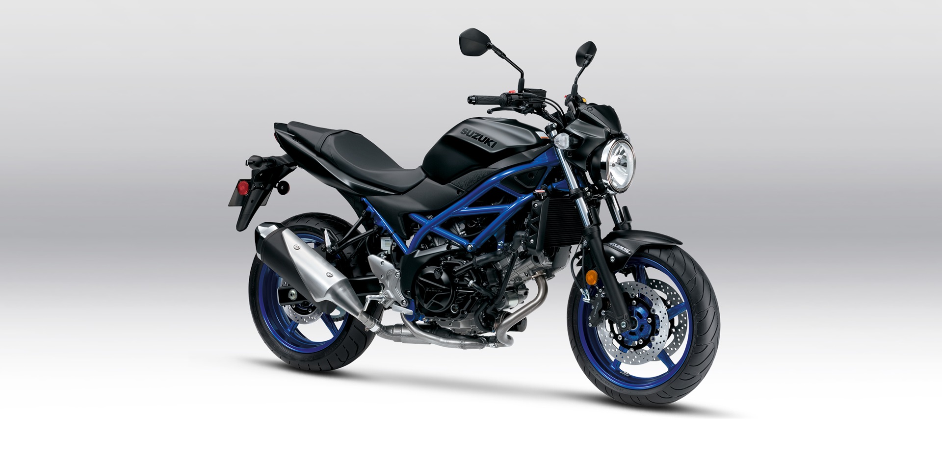

The stock rear fender doesn’t look too bad. The original owner didn’t keep it? You could look around and see if you can find someone else that fitted a tail tidy, and is willing to part with their stock fender.
And I wonder how those ‘hugger’ fenders work? The tire is catching grit from the road surface and flinging it into the air. A bit late by the time it hits the hugger in underneath… 🤔
