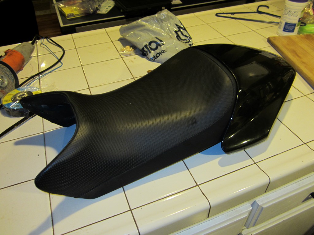

Next on the list of mods is fitting a Monster seat. I got it off CL for a song, just need to make a subframe to hold it. The seat:

thoughts? it'll fit a little closer to the tank, this is just a quick mockup and it's hard to squeeze it to the tank for a mockup
