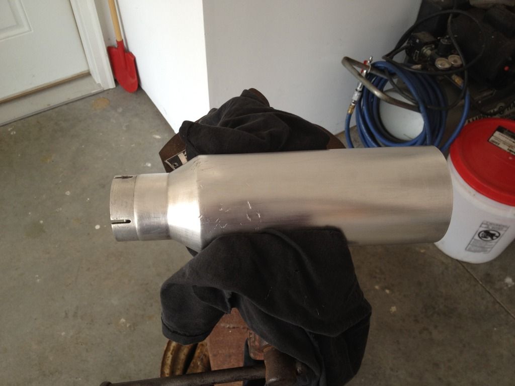

After cutting and beginning the cleanup of the scratches on the can with steel wool. You can see some of the deeper ones at the front near the jaw of the vise, luckily it is on what will the bottom of the can.

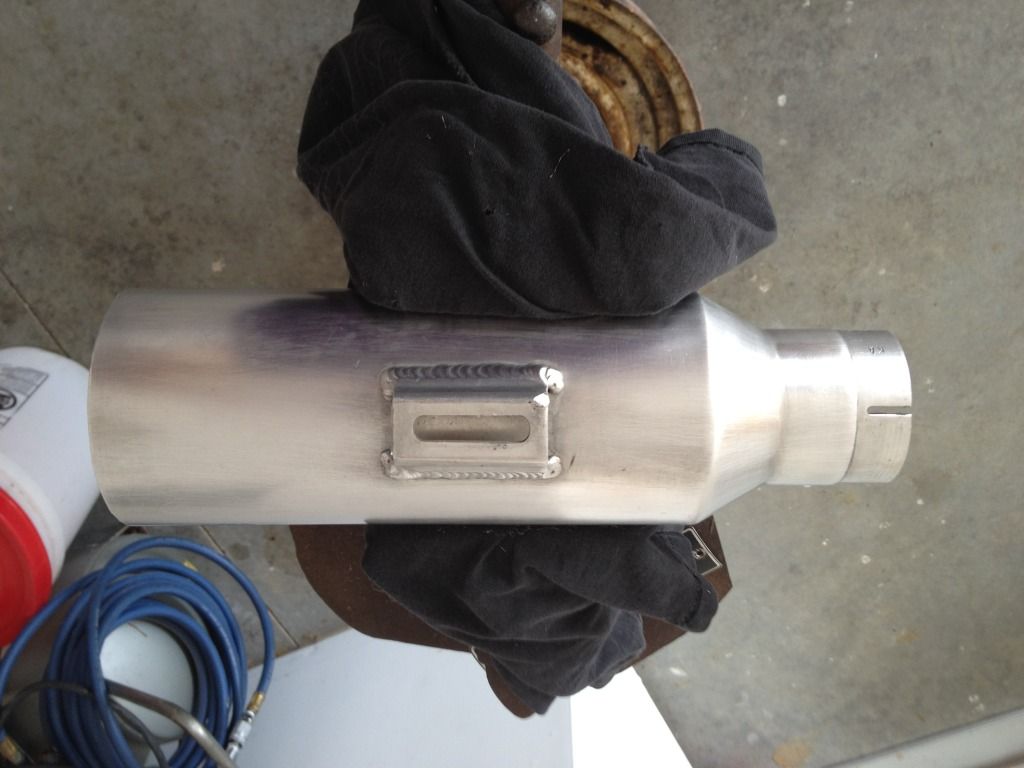

More cleanup with #2 steel wool. Good view of the mounting bracket that will be on the backside of the can facing the bike, parallel to the swingarm (give or take).

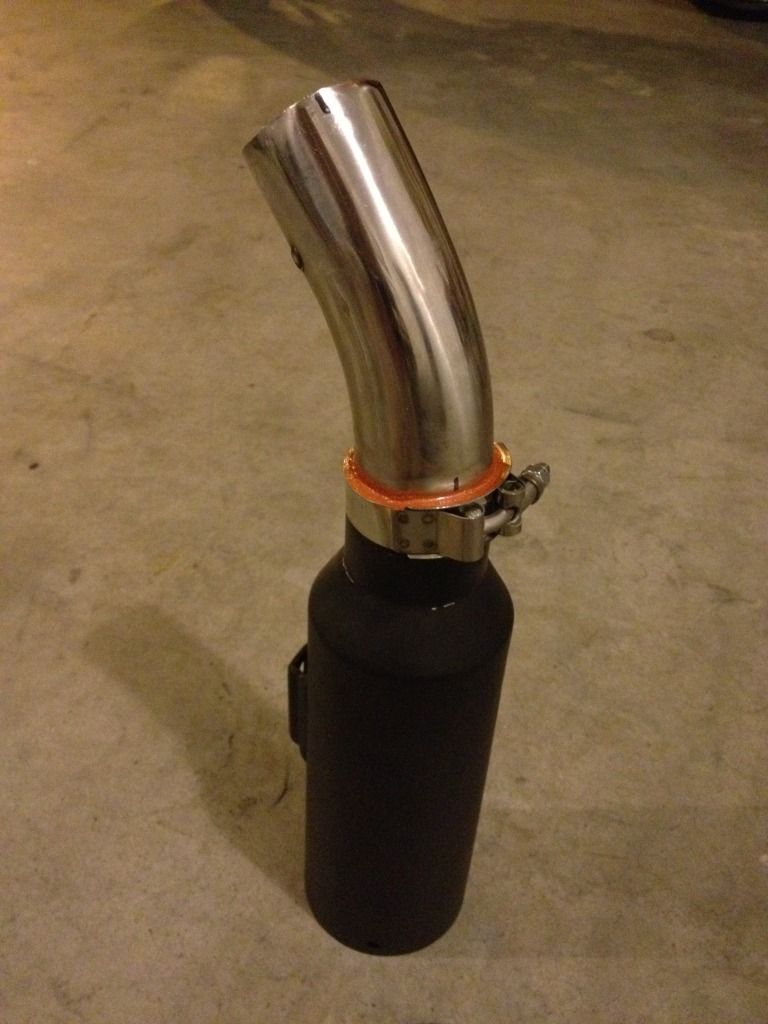

So I mounted the mid-pipe with the Holeshot clamp and duct taped the can to it to see what angle I wanted and honestly to see if this was hideous and a total waste of time or if the ideas in my head weren't completely crazy.. This was the low angle.
This was the high angle that I ultimately liked better. I feel like it flows more with the tail section of the bike and the subframe.

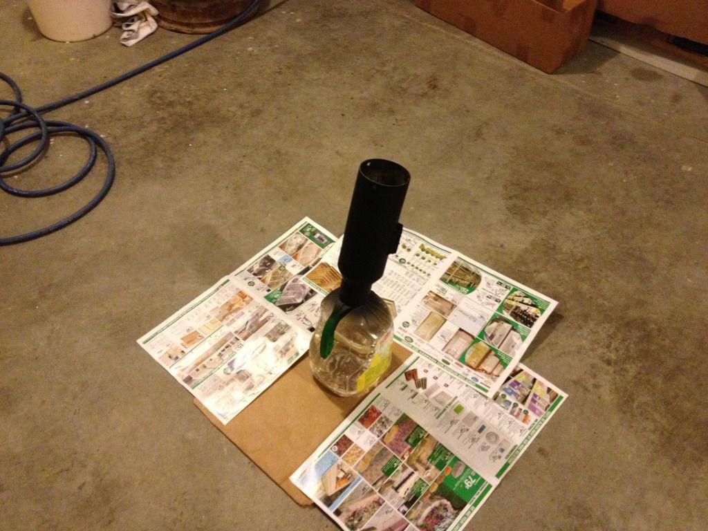

My paint booth. Ha! I honestly wish I wouldn't have painted it now until the entire mounting was done but in my usual fashion I got way ahead of myself and hurried. Oh well nothing steel wool, sand paper, and a fresh coat of krylon cant fix.

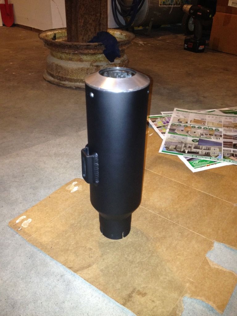

With the end cap installed to see what the polished tip on the black can looked like. Copycat of my Holeshot, so this is quite typical of how creative I am..
And to back up a step, this is the end cap after cleanup and polishing. I would say it turned out quite well.

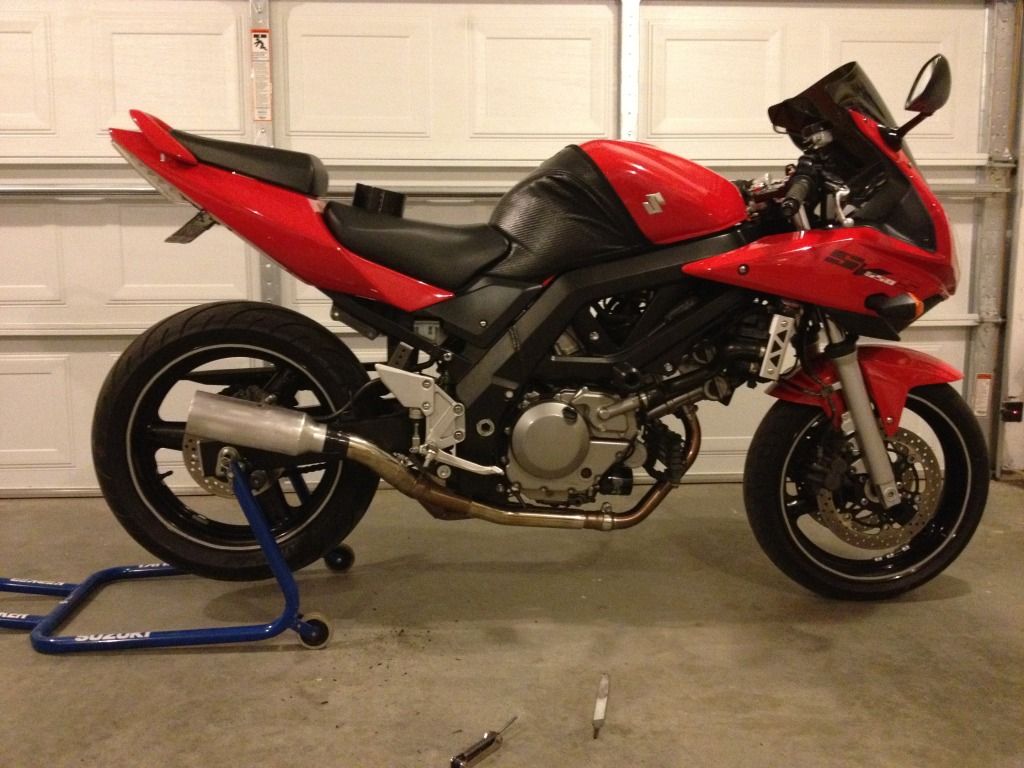

Pulled out in the drive to get some natural light on it. I am happy with how it is coming together. The clamps I got are HUGE but seal amazingly, I will flip and rotate them so that HUGE part will be hidden. I am going to repaint the can and try satin black this time, and build a bracket to mount from the passenger peg mounting tab to the back of the can. It is extremely solid as is, those clamps are amazing, but it needs a proper hanger or it will end up with the same fate as previously on the Seca..
