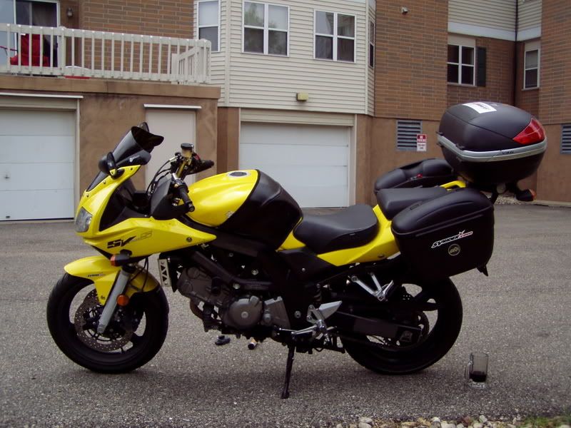

I am trying to decide whether to convert my 2004 SV650S to the naked's handlebar setup or go with Convertibars. I have not seen installed Convertibars for real and haven't found installed photos on the Forum. Does anyone have photos of Convertibars on a Gen II?
I doubt that the side-view photo on the Convertibar site conveys the normal visual impression. It is a straight-on shot taken from about the same height as the clamps. I wonder what a side-view looks from a normal standing position at the side at the fairing.
Any photo(s) you can post would be greatly appreciated. Thanks for your help.

Nice pic. They look really angled out. Thanx for the info on the pinch bolt. I wish I could sit on a bike with some. I figured I might make a tiny scratch in them after measuring to know where I like them up and down. I don't have any yet, but I'm probably gonna bite the built to make a long trip this summer.

Actually, your photo above is about right. The only thing is your left handguard is blocking the view of the Convertibar left clamp. Maybe a shot from a little further forward and angled back diagonally or with your clipons turned to the left would show the clamp. I really appreciate it.

Ranger do you have the convertibars all the way up and back? the reason I ask is I was wondering if you hand guards bumped into your fairing. I have the hand guards on with the fairing and I contact a little on both sides, was wondering if I put on the convertibars if I would have clearance to full lock? thanks a ton.

David, yes, the clamps have to be turned at least 90* out to get the handguards not to make contact. When I moved the bars for a track day in September the handguards had to come off because they were full forward and down. In the up and back, full clearance, the CB comes closer to hitting the windshield than the handguards hitting the plastics.

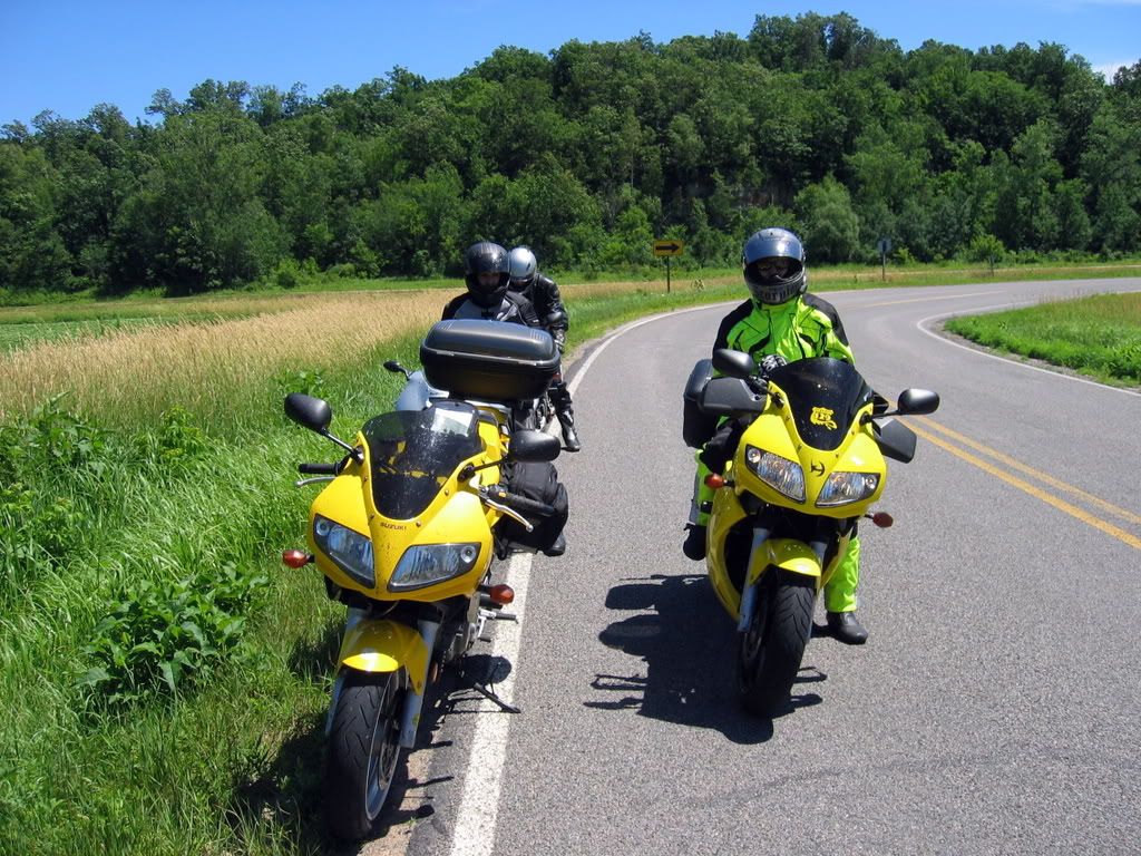

I'm pretty sure this photo has convertibars in it.
