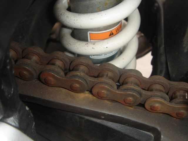

Ok newb first post, bought my SV650S last week. Stupid question maybe but I saw that the chain has some rust and was wondering if I just had to get it lubed or need to replace the whole thing. I think I have to replace because they are too rusty?
It has only 1800 miles on it and it's an 05.
Thanks!

Have you cleaned it, lubed it? Does it bind at all? If it moves freely and doesn't bind it might be alright. I would personally replace it if you have the $$.
6,503 Posts
Check it for tight spots, as mentioned above, and then check stretch.
Put the bike in gear and roll forward to put tension on the chain. Count 21 pins and measure along them. Roll the bike forward and check another section. If the distance along 21 pins is over 12 1/2" (wear limit is 12.57") then it's time to replace.
If it's not worn out and doesn't have any binding spots, then clean it with kerosene (or lamp oil, same thing but less smelly) and an old tooth brush. You won't get all the rust off, but don't worry about that. Once it's reasonably clean wipe it down and spray it with chain wax. Maxima is a good brand, there are others.
The chain is permanently greased, the grease is held in the rollers and pins with O-rings. Chain wax is adequate to lubricate the side plates and the outsides of the rollers.

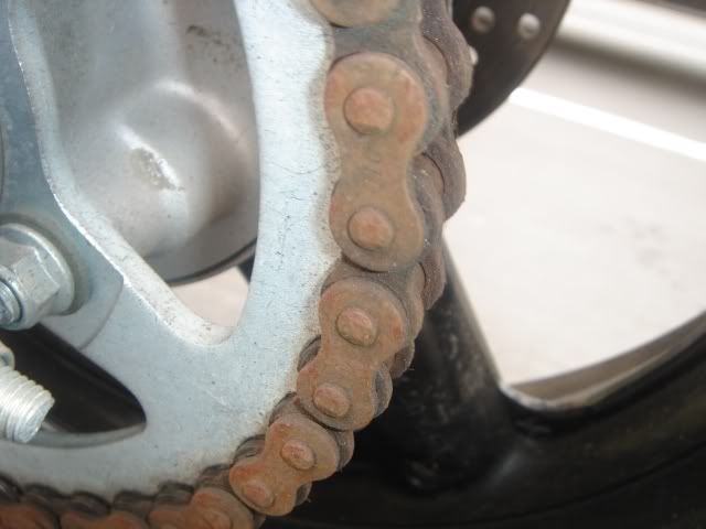

Ditto what the others have said. Additionally, it doesn't look like the chain is centered on the sprocket. It looks like it might actually be rubbing on the inside of the left side links.

...it doesn't look like the chain is centered on the sprocket. It looks like it might actually be rubbing on the inside of the left side links.
On which one of the pictures do you see that, on the first picture it looks like the placing is normal? Thanks for the advice.
3,872 Posts
you can look at the wear spots on the chain itself (rollers? bearings? not sure what to call them...?) i am looking at the third picture. the side closest to the viewer is smooth and looks worn, while the far side has some surface rust and has not been around the teeth of the sprocket.
I see what you mean, how do I fix that? (well I'm not knowledgeable enough, have to probably bring it to the dealer I think..)
The 1st and 3rd pictures
It could simply be that the chain isn't running straight. That is corrected by adjusting the two bolts that stick out of the back of the swingarm. Be careful messing with those since they also adjust how tight/loose your chain is. The alignment marks on the swingarm are known to be off from one side to the next. The easiest method is to simply get a piece of string and measure from the axle to the swingarm pivot. Both side should be the same (or really close).
