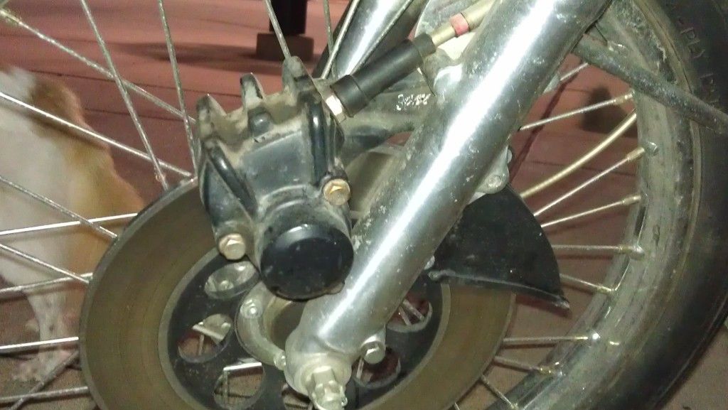

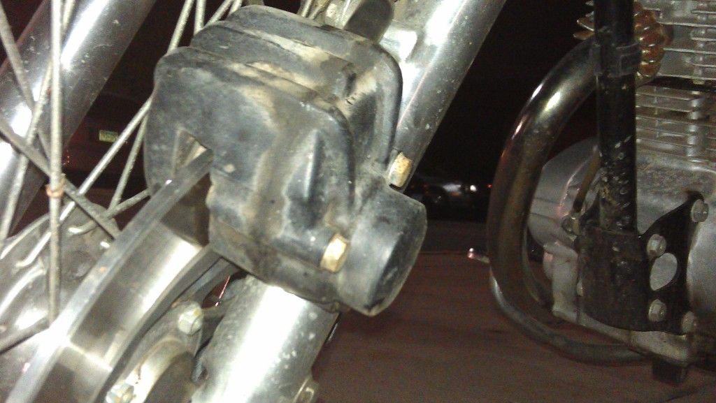

My wife recently expressed interest in learning how to ride, so we borrowed a fun little 1970 something Honda CB125 from her brother. It will be a good first riding experience, and seems to be in good working order except that the front brake seems really stiff (nearly unusable). I have ridden this bike in years past and know it was not always that way.
My question is; what would be the best way to go about fixing the stiff brake?? I am no stranger to working on my bikes, but I have not worked on a brake system that uses a wire rather than a master cylinder. I would like some advice before I just take some tools to it lol.

Well, I think I'd start by making sure the cable and the lever are not binding/seized, and then move on to the caliper.

I imagine (though I really have no clue) that it works similarly to rear brake calipers on a car that have the parking brake built-in. The cable causes the piston to unscrew, giving you the clamping force.
2,999 Posts
I'd start by pulling the brake lever, clean & grease the pivot and the fitting on the end of the cable that attaches to the lever. The cable probably needs a good lube too, but you'd want to make sure none of that lube finds its way to the pads/rotor, so I guess if it were me, I'd look online to find out how to disassemble that caliper & service it, so that I could lube the cable while it's detached from the caliper.

I'd unbolt the caliper and pull the lever. The pad should move easily when you do it, and the caliper looks like it should slide side to side so make sure that is free. Once you are satisfied that it is moving as it should you are left with the friction surfaces not doing what they are supposed to do. Sandpaper is your friend on the pads and Scotchbrite (or the like) on the disc. Scrub them both to remove the glazing and they should work as well as they are going to. Remember the old bikes did NOT have brakes even remotely as good as our modern versions. I have fond memories of CB100's and 125's. They are indestructible motorcycles if there ever was one.:)

I'd take a look at the cable and make sure its lubed and the point where it contacts the lever well greased. With the caliper, you can remove the three outside bolts and that cover will come off so you can take a look at the guts of the caliper. You can then see if there is anything preventing it from moving smoothly.

Following some of the great suggestions I received I went ahead and opened up the casing on the break caliper. Well, to my mild surprise there was a great abundance of rust covering everything. After giving the internals a health blast of PB Blaster I started looking around. Apparently, there are two wheels that turn when depressing the brake lever. The first wheel is attached to the brake cable, and turns when pulling the brake lever. The second locks into the front of the first wheel, but when turned it screws in and puts pressure on the back of the brake pad.
I took about 3 hours, and with the help of PB Blaster worked the wheels in the brake caliper free from being frozen almost solid to having fairly free movement.
