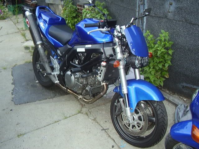

Originally it looked like this.

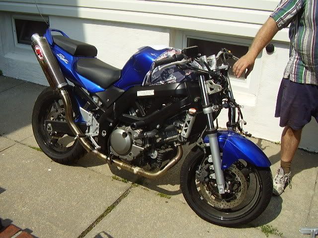

Then on a sunny July day, someone blew a stop sign. I went through the guy's window. The glass cut the left side of my neck open, cut the nerves that go down to my shoulder and arm. The cartilage in my throat was fractured, they needed to cut a hole in my neck and connected a tube so I can breath. While at the hospital I had no intention of getting back on the bike. When I was released, the Doc told me my left arm would be paralyzed for life.
Eventually I got the bike back from the towing place. Bent forks some scrapes and bent shifter. I realised sitting home wasn't doing anything for me so I started repairing the bike to resell(the other guy's insurance was giving me a hard time).

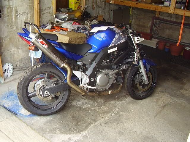

Here's a pic of the M4 exhaust on the bike. If you notice, it doesn't fit flush with the undertail. Personally I like it at that angle and how it's above the seat. The pipe was for the wrong year.

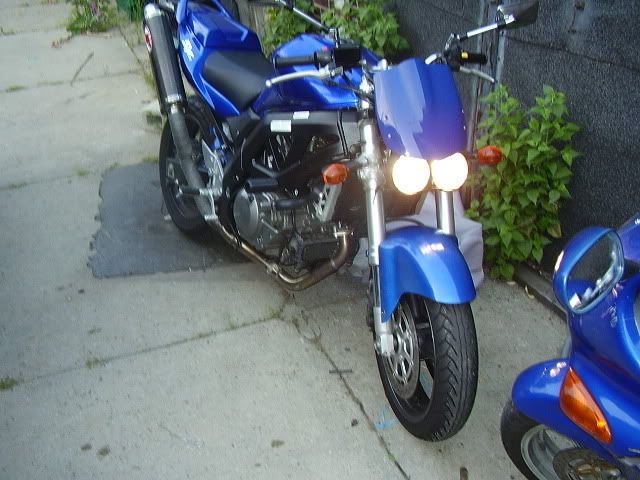

I got my hands on an SRAD front end. I always had the Buell headlights, bought them the same day I got the bike. I don't like round lights. After 3 days, the SRAD was on and I zip tied the Buell headlights and fly screen. This is when I started to think if I should ride again. Workin on the thing was more like therapy.
Admit it, you gotta love the clear tape holding the signals.
Anyway, later that day, I took it out for a ride to test everything out.
http://www.youtube.com/watch?v=UUj3Fe2t6uE

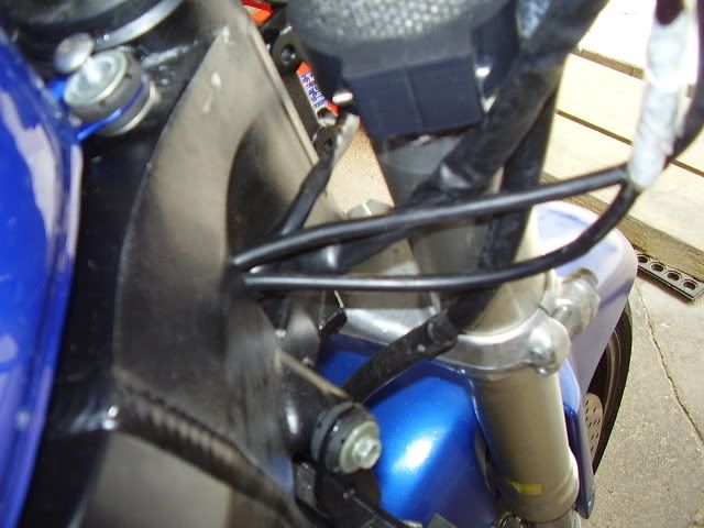

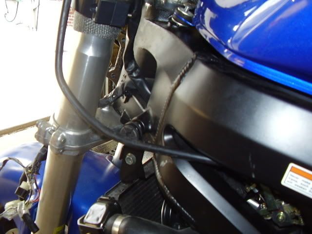

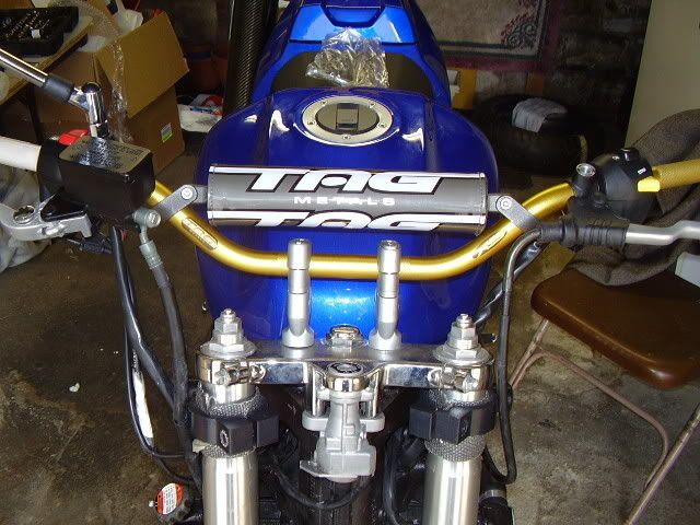

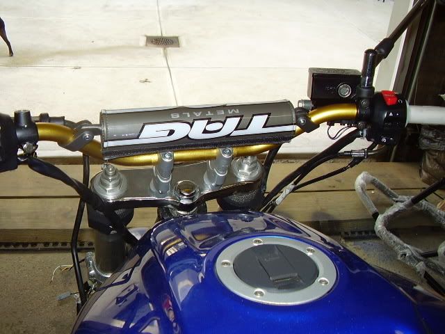

Eventually I got a Tag X5 handlebars and some riser extensions. All the wiring wouldn't reach the new position so after some advice I re-routed the lines.
I took apart the bike, I'll take pics this weekend with a newspaper. I tried fixing the dent in the tank with "Dent King". It's definately a pain in the ass and doesn't work.

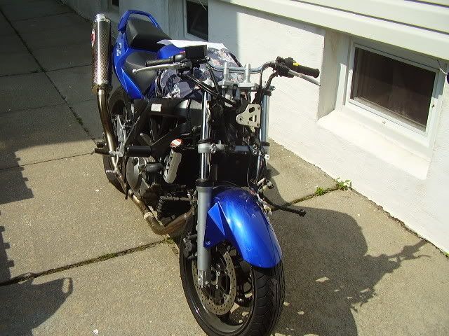

took some pics today with a paper to prove the work wasn't done years ago and these aren't stored pics....
The bike up on stands with the tubes off.

When I do ride this thing, I'm going to see how the handle bars feel. They look too tall with the flyscreen, I may take off the extender plates on the risers.

connected my Acewell,
here's the wiring diagram for the SV650
cut the part of the wiring harness that attached to the stock guages.
Seperated the wires and kept the shop manual for the SV so I know what wires connects to what.
Made a bracket with a piece of alluminum I had laying around from the previous owner of the house.(Tip: never throw anything out cause you'll never know when you can use it.) I attached one end to the pinch bolt of the top triple and bent the piece and bolted the acewell unit to the other end.
Side view
Top view
**** pit view (all the wiring is in that black box you see behind the flyscreen yo, cause I like my **** neat son.
So then I started to look at the flyscreen and asking myself if it was missing something. The flyscreen was a good idea, but didn't look right with the rest of the bike. It was a silver in color and had the silver forks, but something was still missing. I thought of that creepy guy that painted while he smoked pot. Bob Ross... what would he do? He'd paint a lil tree over here, so maybe the front of the bike needed some more silver to enhance the look.
Before adding a tree....
I had some mesh I bought so I can make a grill for my car, that never happened. Then I thought of all the grills I seen made for the SV650. I've also read them being $70 and 70 bux being a great price[sarcasm]. They must be smokin some of that old school crack. $7 for a sheet that was 3x5 feet from the nat'l hardware store did me right.

Took a pic of the undertail, everything looks crooked, it's the angling since I had to squat down under a loft in the garage. The new 180 rear tire along with 5.5 rim from a 95gsxr1100 back there.
Next on the plans..
-get the washer installed, align the rear wheel
-change the oil and oil filter
-put on the belly pan
-get inspection and suspension checked out
-make a new bracket where the exhaust sits under the side of the tail as opposed to way above.
-put on the flushmount signals in the rear and remove the 636 signals that's on the rear now.
-get the exhaust cams swapped out and put in another that will increase compression in the engine.
-get the ECU remapped to compensate for the new camshafts.

I corrected the position of hi-mount M4 exhaust,
connected all the flush mounts for the rear,
dremeled the tabs off the fender eliminator,
removed and replaced the stock pegs with race pegs(that way my sneakers won't slip).
Adjusted the flyscreen.
I RODE to poop boys so I can get my own mityvac so I can install DougZ's rez delete. Put that on.
Now the only thing is to make brackets for my bellypan(I lost the orig) and change the cams.
I'll post picks tomorrow, I'm goin to my girl's to hangout.

Here are some pics I took. I need help picking the best 4 shots showing 4 profiles:
front
rear
lt side
rt side
I'm leaning toward the east river shots. They were taken in the afternoon with the sun infront of me, I will go back tomorrow morning when the sun will be behind me.
EAST RIVER- Brooklyn Side
Sun facing me, radiator just looks crooked cause of the grill and my angle.
This one I got on the other side and took the shot with the sun behind me, but no skyline
Sun behind me
Wall near by I went to the Vespa wall, but that has ben painted over many moons ago.
Sun is facing the wall
I tried to get Brooklyn in there, but it left the bike too far and you can't see the diamond plate undertail.
BatCave
By a beer dist.
This was in the afternoon a few days ago with the sun facing the wall
These are photos proving the build as of today, completion of the buildoff. Some of the photos came too ****** and I'll be returning to one of the spots for better lighting.
For those that think I'm doing anything else to the bike, please, if you see anything different on the bike from these pics with the pics that I will post for the final, inform the mods and I will gladly accept a disqualification.
Again, these are pics to show that I am done and nothing new will be done to the bike.
Thank you for taking the time for looking through my buildoff.
