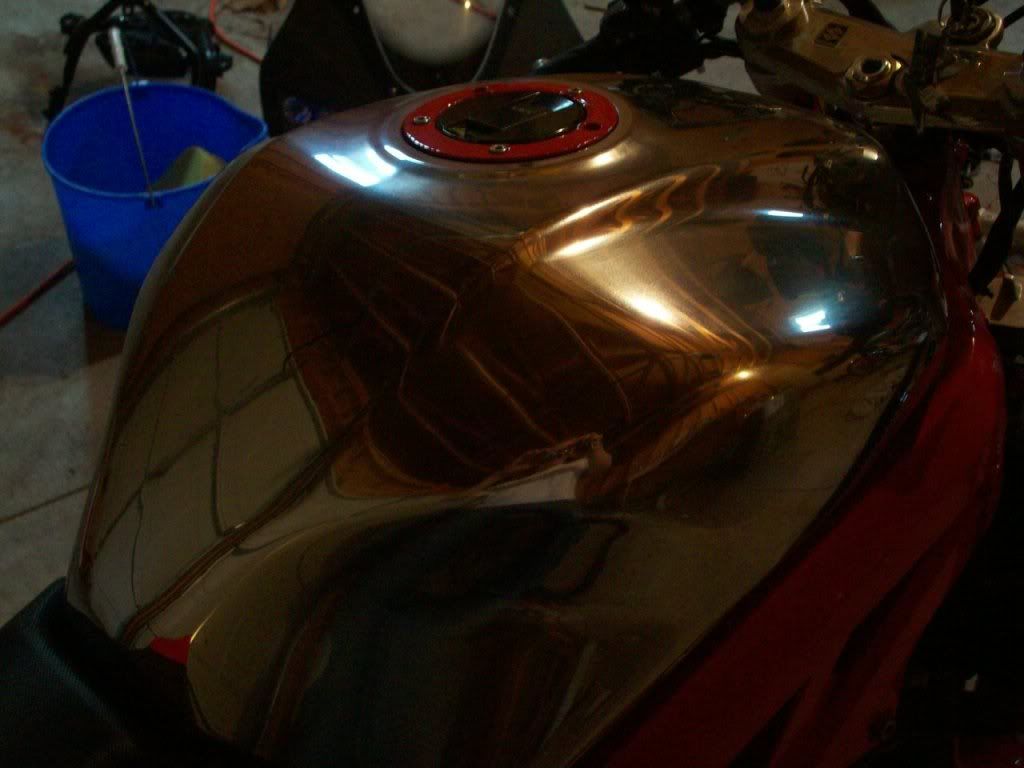

This tank was painted white when I got the bike, and it was originally copper. I used flat black primer for awhile:
Before:
After a bit of sanding you can see the layers:
Ewwww:
Getting closer:
Just a few more small things and it'll be done. If anybody else has done this, post some photos!!!!

What grits did you use? Did you use a rubbing compound then polishing? What did you use for clear?
Grits: 150, 220, 400, 600, 800, 1000, 1500, 2000
I used Mothers Mag Aluminum Polish, then used Engine Enamel rattle can for the clear coat. Not because the tank will get hot, but because the high heat clear doesn't dull like the normal stuff. Also, it seems thinner and doesn't get surface bubbles on it. You can't even tell it's on there.

I really don't think you will see a difference with a grit above 1500 unless you get a magnifying glass.

Believe it or not, you can tell a difference in the sharpness of the reflection with the 2000 grit. The 800 and 1000 grit just makes it a little easier going from one to the other. I like the 800 because it gets rid of a lot of the tiny scratches made by the lower grits before you get to the fine stuff.

K thanks. Guess I'll be getting some more sandpaper then.
How big a difference do you think adding a rubbing compound step will be on aluminum?
You know, I couldn't say. I've never tried anything but Mag Aluminum polish on all my polishing projects. I'd be interested to find out, though! I may have to pick some up and give it a shot.
