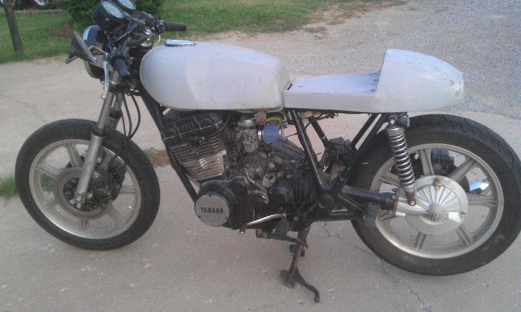

Well, I needed a summer project and I've found one.
It's a 77 Yamaha XS750. Three cylinder's of fury! I picked it up on CL for a decent price. Its mostly done.. sorta. The engine has been rebuilt. It's got clubmans on it. Has a fiberglass cafe racer tail. and overall doesn't seem that bad.
It starts hard. But once it's warm it goes alright. Feels like it's running a bit rich.
The end of the exhaust is off of a GS1100, and doesn't sound that terrible. It's no M4 or whatever you fellas fancy, but Its not terrible.
The back of the frame looks like It's been chopped. All of the electrics are under the seat, and the battery is under the tail. The electric start even works:rock:
A general list of what I plan on doing.
1. Tune the carbs.
2. Put rubber mounts underneath the tail. It vibrates something fierce now.
3. Make a seat.
4. Put on a tail light. I've got one. Just need to wire it in and get it mounted.
5. Fix the turn signals. They don't tick. just constant on.
6. Cut away a bit of the tail. It's close enough to the tire where it's been rubbed at least once. The tiremarks on the bottom are kind of an indicator.
7. Licence plate bracket/light.
8. Put the fender back on. after it gets painted
9. Paint the whole shebang.
10. Cut the exhaust tip off, so it isn't pointing up.
11. Follow Domiken's rust removal guide. (before painting) It's kinda gunky in there.
Possible goal, put on some sort of rear hugger. fender.
Then Sell it before I have to move again. Or if I fall in love with it (doubtful) I'll bring it up north with me.

First thing I did tonight was get it started. After a few minutes of cranking I remember I had turned the fuel off the Night before :facepalm:
after I got it running I took it for a slightly less than legal ride. (no tail/brake light or licence plate) Got it up to an indicated 70, which felt ambitious. I'll check it with a gps after I get a light and plate on there.
Then I took off the passenger pegs. I figured they weren't going to be used anymore so off they came.
Now I'm downloading a manual and making a hardware store run tomorrow in the AM for some nuts and bolts.
