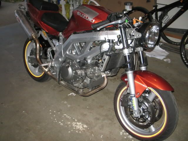

Which would be more aptly titled, what I am doing to my sv since nobody loves it or wants it but me. Long story short I lowsided into the gravel at a trackday last year. The bike got some decent gravel rash on the paintjob, and I listed it for dirt cheap in the classifieds try to get rid of it and buy a supermoto or a liter bike. Unfortunately, all that succeeded in doing was attracting dirt bags who would low ball me to ridiculous amounts, even though the only damage was cosmetic.
Anywho I plan to convert this bike into a race bike, but also have an easy system in place where I can swap it back to street trim.

Well not much progress so far, I took off all my rotors and brought them to a machine shop to get bead blasted. Still waiting on them before I can get my bike out for a test ride. Also waiting on my new brakes (brembo MC, vesrah pads) to come in the mail.
Here's a shot of the bike as it sits now, with the spare tank I bought off a racer. Just wanted your guys opinion on how the white looks with the silver frame, I was debating painting all my street bodywork white. Other color suggestions are welcome. The track bodywork is going to be copper btw.
2,804 Posts
so your poor and jewish...something doesn't fit well lol
It looks nice with the silver frame....gonna look way better with all of the plastics white
606 Posts
I like the white with silver frame. The black with white has been done.
