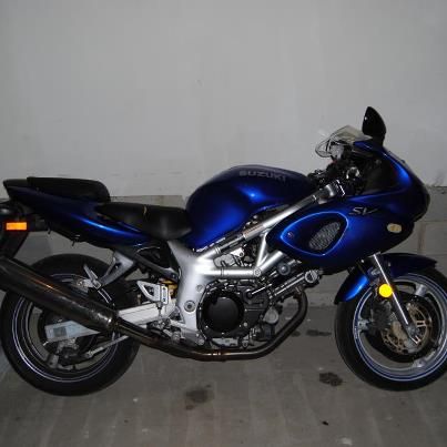

How's it going guys? I'm Justin and I just bought my first bike last week. It's an 02 sv650s. Has some scuffs in the plastics, and the speedo isn't working, but it's fun! So far I've ordered up the relay under the seat and the speed rotor to hopefully remedy that speedo issue. Plans for it are pretty simple, slip on exhaust, undertail, and full fairings. I Guess I'll be updating it's progress here. -Justin
