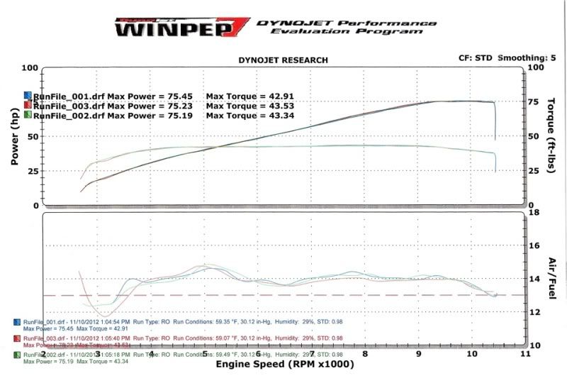

Hey all, i just did 3 pulls for $65 at ECS in NY, great guys.
I was impressed with my results. I realize its a nice cool day but have a look at my results and tell me what you think? Stephen there said I'm running lean and I would see little better results with a larger MJ. This is standard non corrected, non SAE on dyno jet 250.
75.23 HP - 43.53TQ
152.5 MJ
Cam swap
Desnokeled OEM filter
Shorty slip-on

Yup like TC said...Main Jets.
I'm actually running a little lean based on my A/F ratio.
Anyone have a pair of 155 size MJ lying around they don't need?
I could trade you for a set of 152.5 or 150's.
