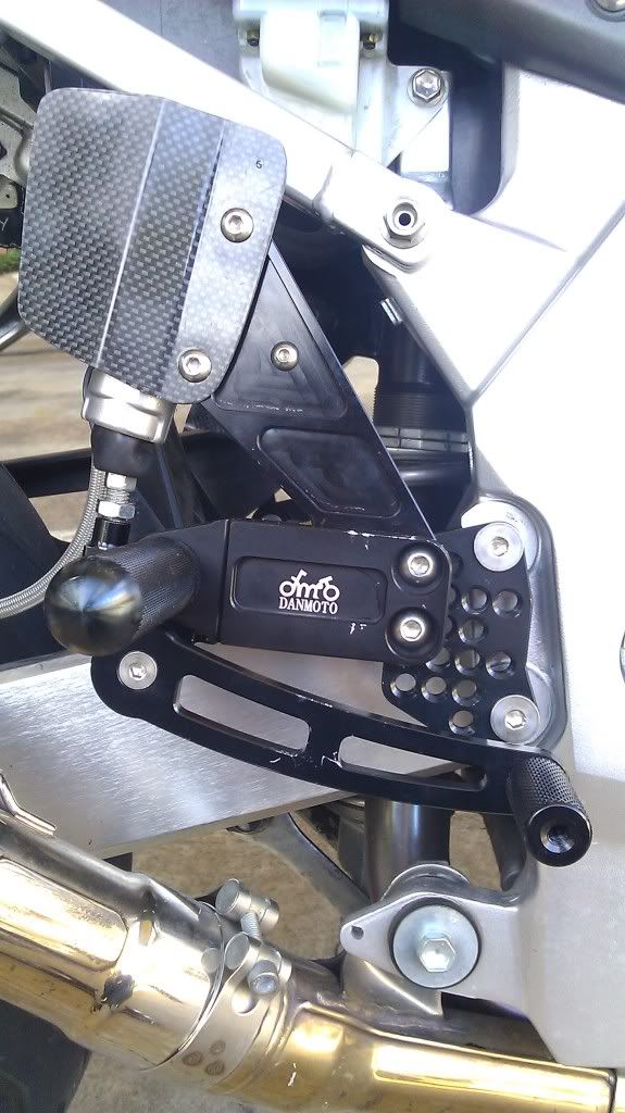

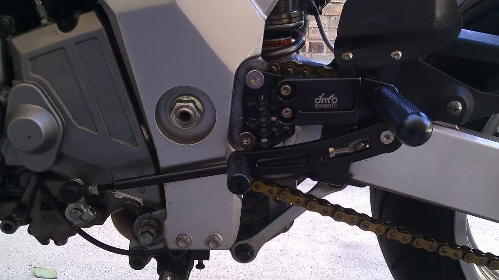

Hey guys I just installed my rearsets and as with most rearsets there is no return spring. I understand that people say that the return spring is not necessary, but my rear brake is dragging pretty hard (I rebled the rear). I feel that I probably messed up the adjustment for the Ubracket area.
Right now when I press the lever down, it does not return. For those of you with aftermarket rearsets help! I had to pull over yesterday being a dummy and taking it out thinking all was fine and dandy. Luckily I had the old rearset and re-installed it.
Right Side:
Left Side:

I fiddled with it and I'm taking the lazy and secure way out lol If installed properly I know it should take care of the return, but right now I would feel more confident with the spring from woodcraft. That was a quick snap of what I took. What the plunger looks like now actually is normal, but the return is still iffy. I'll semi contribute it to the rearset for now since the master cylinder does a weird shift. Apparently I missed a screw when thread locking.

See if you can find/make a clevis with an offset hole. I've seen plenty of them mounted offset that have worn the mcyl piston and/or bore down by running like that.
I'm not 100% sure, but I think it's a mismatch, like it's a GSXR rear set or something similar. Absolute easiest way to fix it is to ask the rear set manufacturer if they have a right hand pedal/lever with a larger distance between the pivot at the peg and the mcyl clevis pin hole... only needs another 5mm or so.
