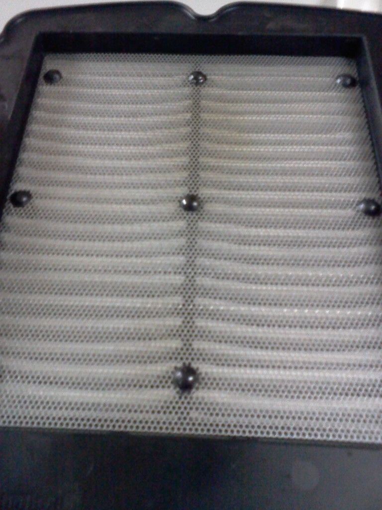

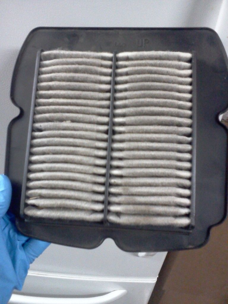

Just wondering because it looks okay to me, and I can't imagine it's been around for 21k miles.
Thanks
2,510 Posts
They last a pretty long time especially if you're not in desert dusty areas...
I'll take that as a yes. Well if it is the original part I am very impressed. It actually is quite dusty here. I'm guessing the PO replaced it with an OEM filter.
On a side note is there supposed to be a gasket on the cover? It looks like it should have one but mine doesn't. Either way, the inside was absolutely spotless. I was worried there would be oil everywhere or who knows, but yeah... spotless.
