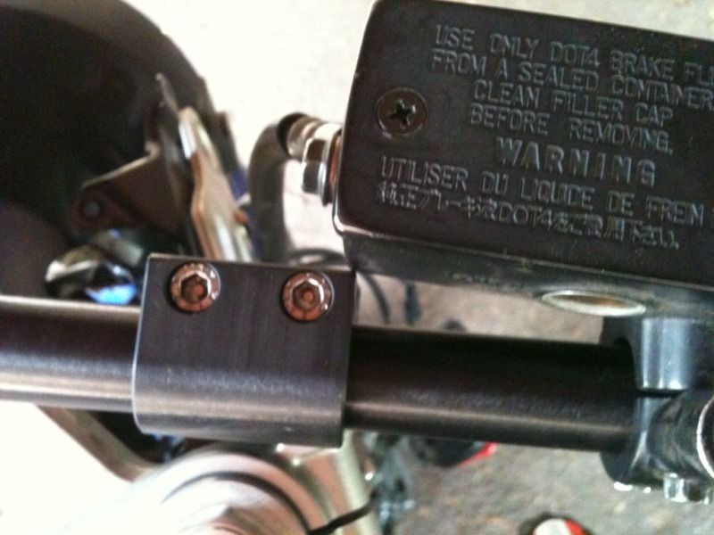

Im trying to install some SV Racing Parts 2.5" clip ons. Everything is going as planned, fitment and quality is excellent.
Except for one thing. I am installing these on my 2005 650N, with the "square box" MC. The MC hits the clip on clamp in all positions, and I dont know what to do!
I see someone has installed them on an N in the for sale thread, so I am obviously doing something wrong.

If you check out their site http://www.svracingparts.com/products/#ecwid:category=477663&mode=product&product=3033530 , they show that you need a $15 spacer for the N model. I haven't actually installed these bars, but I assume that this is what's causing your problem. Call Blair to confirm before you order.
*** Edit - Also noticed that you are using the "reverse mount" option that brings the bars further back. If you flip them to "standard" it looks like you'll have clearance. Meaning, flip the flat riser around to make the rounded side face the front of the bike. The reservoir would then only have to clear a thinner piece of metal. You may also be able to mount them "as is" on the back side of the fork tube, which accomplishes the same thing. Don't know how much this would affect turning radius or interference with the tank though.

I did purchase the N spacer, that simply pulls the bar away from the triple clamp bolt.
But, you are 100% right on the mounting. Flipped it, and the MC fits!
