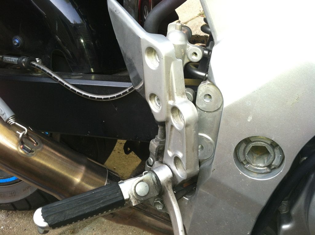

Old ones coming off

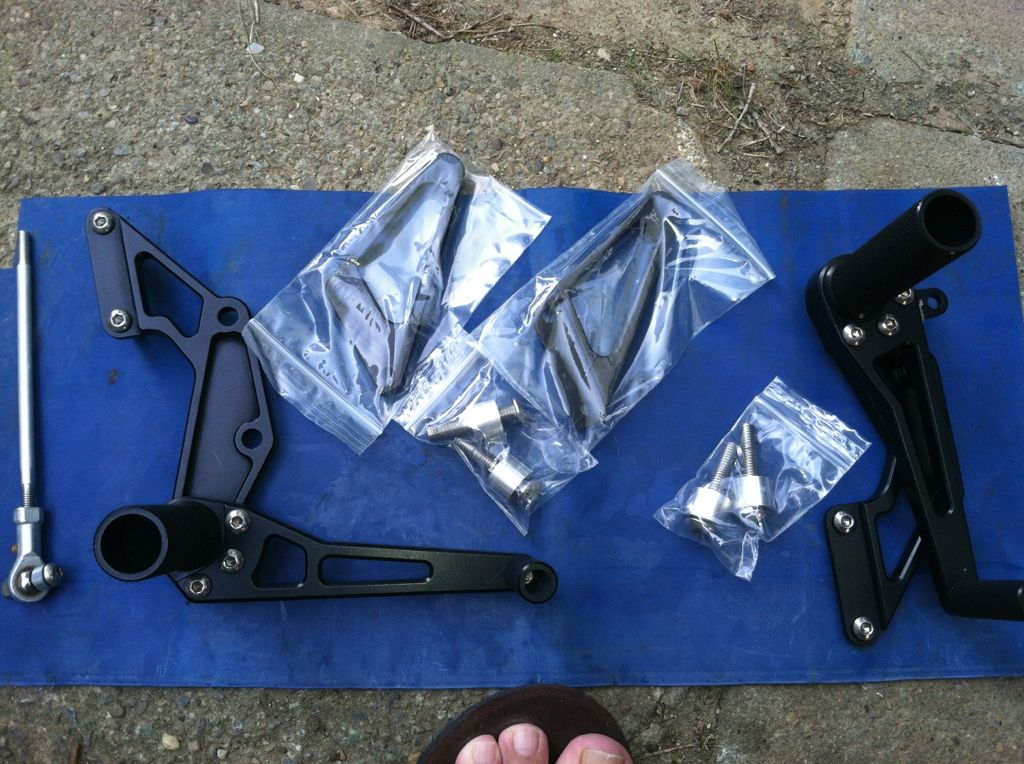

Here are the parts unpacked and laid out and partially assembled

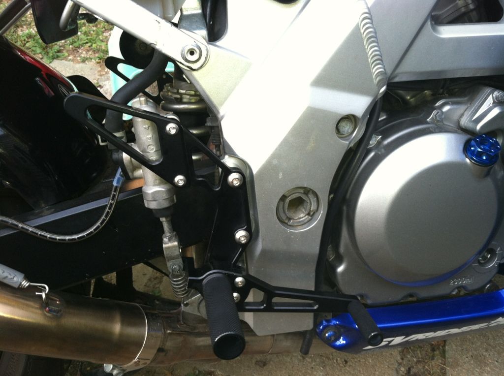

Brake side mounted. The stock main spring worked once stretched and opened up a bit

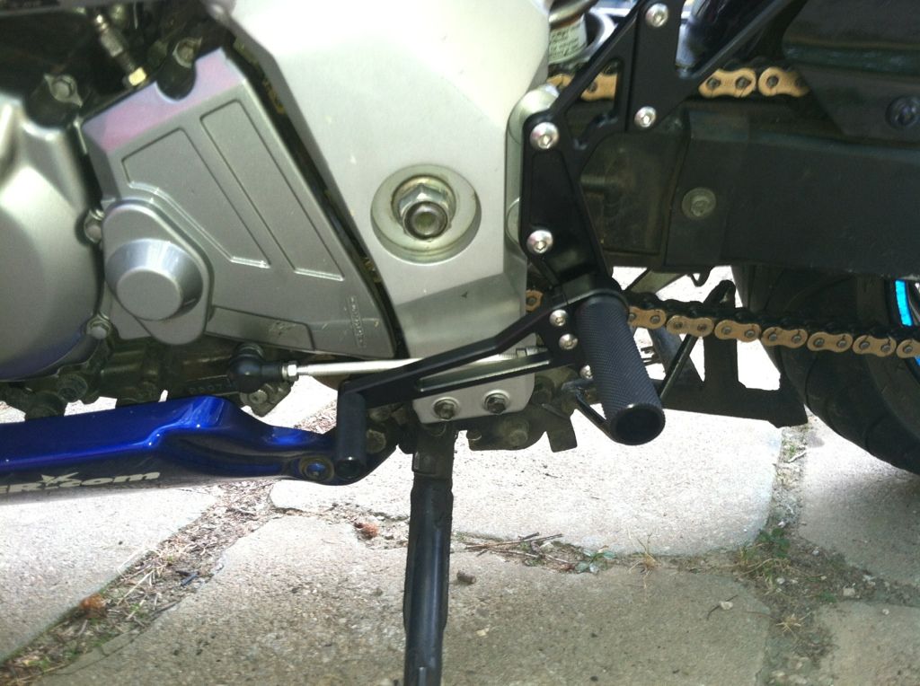

Shift side on. Note the lovely low position

-Kevin does wonderful work. Parts look great and the finish and packaging are top notch.
-I thought the amount of play between the needle bearings and the aluminum peg felt to be more than expected. I also wondered about longevity, as the steel bearings are against aluminum, not the best bearing surface. Dont know what other mfgs do, or what would improve it, outside of a steel sleeve over the load bearing area. (this is NOT a criticism. Just observations)
-Was worried about vibration as I am eliminating the rubber covered pegs
-Dimensionally the fit was perfect. Perhaps adding another small hole to allow the factory rear brake switch to be used? I have ordered a Vortex pressure switch.
-Bearings seemed lightly greased...I added a well spread glob of Phil Wood to each before final assembly, as well as a small dab of blue loctite to the pegs and mounts
-To get the position I wanted, Nuke figured out that the mount bracket with the adjustable holes would be eliminated altogether and the bracket would mount direct to the frame. Spcers were needed though to get the bracket out to the correct width. I think a small flat bracket would provide more support than two cylindrical spacers.
So after a 30 mile ride last night my feelings:
OH MY GOD. I swapped a 2006 motor into my SV last Winter and have NEVER been happy with the way it shifted since. I thought perhaps something was tweaked inside as the shifting was notchy and VERY hard to find neutral at times. The recent crash I had mangled the shifter side peg assembly and the shifting only felt worse.
This completely cures those ills. The bike shifts like a swiss watch. ALL energy put into the lever is transferred to the shaft. Wow is all i can say.
Love the grippy knurled pegs compared to rubbber. Feet stay put.
No vibration issues. In fact, I know it sounds impossible, but it feels smoother than before.
Position? These are in reality about 1/2" lower and 1/2" further forward than the stock 2003 naked pegs. I was amazed and what difference I felt in comfort and posture from such a small change (less than going to Buell pegs).
I am sold on these. The few little things I am wondering aloud about will sort themselves out as the miles pile up.
No rigidity issues due to the spacers either.
Thanks Kevin (Nucular) for getting these done for me. You did a great job and are highly skilled IMHO. I will provide updates here as time goes on.
