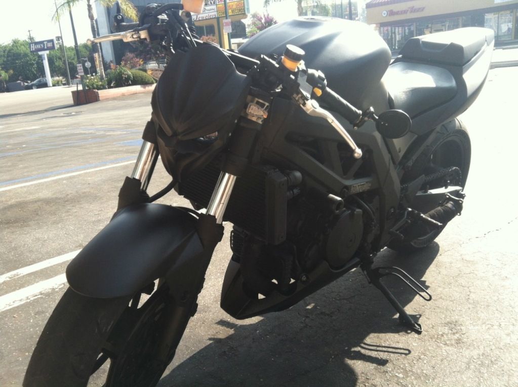

Hey guys I wanna shorten the mufflers on my sv1k all the way to the bracket. But here's the thing I want to keep the baffles, I don;t want to gut them out. I've been searching for a while and couldn't find a DIY thread that can help me! Sorry for posting this I know this has been discussed before but I can't seem to find the right info. btw here's my bike mufflers away from finished!

I would just cut it apart and weld it back together. You can keep the baffles in place just shorten all internals.
SICK bike by the way !!!!!

Not 100% sure what your referring too as the picture you have posted only shows the exhaust pipes and not the mufflers (cans). If you are wanting to shorten the pipes down to the brackets under the rear of the motor then grab a hacksaw and go for it. There are no baffles in the pipes themselves. If on the other hand you are wanting to shorten the mufflers (cans) then search because there are a heap of threads on how to do it.
I believe the "baffle" he is referring to is the core of the mufflers. You can shorten the entire muffler without eliminating the core but I just don't know by how much. I would imagine the easiest way to go that route would be as already mentioned: cut it open and weld it back together at the length you want.
