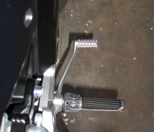

I got low on this one turn and felt scraping right where my shoe was, which freaked me out. I thought it was the foot peg but I guess it was my brake lever.
WTF? Is the stock rear brake lever supposed to be bent like this? I always thought it was just a litttle curved. Apparently, it is not good if it scrapes the ground while riding, so something must not be right.

The position of the brake lever is adjustable. If it is scraping before the pegs, you need to adjust it up (a lot).
Edit: now that there are pics....
That lever is WAY bent from a crash or something. It should run parallel to the bike/ perpendicular to the peg.

That looks EXACTLY like mine after I went down at 50mph when the deer hit me.
I bought a brand new one thinking that one would break when I tried to straighten it. I was lucky, it didn't. Here's what I did. I had an 18" piece of 3/4" galvanized pipe. I but the end of the pipe over the serrated part of the lever and VERY CAREFULLY AND SLOWLY applied even pressure which slowly bent the lever right back to stock shape. I wouldn't have done it without a spare to replace it but now that I know how it's done, I do it again. A new will cost upwards of $65 by the time you get it shipped.

I HAVE NEVER CRASHED nor abused my bike. AND I SWEAR my lever was crooked like that before. SO the question is HOW THE HELL DOES it get like this in the first place??

haha who is that? Sh1t. Now that i think of it.. I did get hit by a car while ago when lane splitting on the freeway. A car on my right turned left into me when I was beside him. But why whould the brake lever bend towards the car??

could be that the pedal got stuck under the car bumper or something and when the bike pulled away from the car it bent... funny that you say you've never crashed and then you mention you were hit by a car. The bike didn't go down when you got hit? awesome balance :)

I didn't consider it to be an accident.;D The guy pretty much just pushed me into the next lane. But yeah, I don't see how it would bend toward the car. Nothing ever got hooked on the guy's car. i am sure the footpeg would hit the car before the leer anyway, it sticks out much more.
Hmm .. thanks for the photo comparison eddiemon. DEFINATELY not normal. LOL.

But yeah back to the MYSTERY of a bent brake lever. It obviously got shaved because of the weird bend it has. But how does something like this happen. Only thing i could think of is sabotage: someone got a long pipe, used leverage, and bent that shizzle. ???
