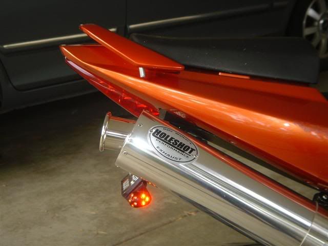

I've got a Hamicad FE with a Holeshot high mount. I made some brackets to fit behind the license plate and attached Watsen Designs mini LED blinkers to the brackets. To fill the old turn signal holes in the FE, I put in some u-bolts and use them to hook my bungee net. It works out great and I didn't have to drill into the fairing or FE. I have pictures at work and can post or email them tomorrow.

Here are some pics...
Right side view, left side is exactly the same.
Looking behind the license plate.  Each signal is mounted to its own bracket.
