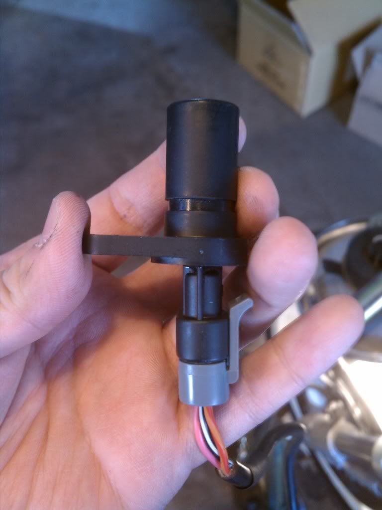

i am looking for the electrical size of the sensor i need to do my gsxr swap. i have found tons of different sensors and not real sure what i am looking for. also i have found the magnets for the rotors already but not sure how many i need, I am guessing it depends on the sensor. Most people say 4, but the one done in moto mag has 8?? Any info would help Thanks

The sensor I used was from a KTM 610 that I found for sale on eBay.
The sensor was pretty low profile and sealed from water and grime.
I have no idea if other sensors from KTM would work, I just know that this one did and I only know that because I tried it and it worked.
(I mostly based this off of the fact that it had the same number of wires. Trial and error works sometimes!!)

I have a 2003 SV650S with a 2003 GSXR front end. I'm assuming I need the Cherry Hall Effect Sensor, 4 magents, and then just build myself a bracket to mount the sensor. Then space the magents evenly apart so they pass through the magnetic field of the sensor. Would I need a speedo healer or is there a way around that? And would I need 8 magents or not? Thanks for all the help guys!
#100 ·
You need 4 magnets and a speedo healer is not required.

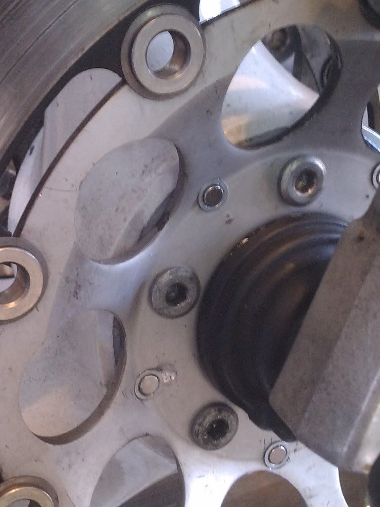

I have one thing left to do to finish off my winter project and get my bike back on the road...and it's this.
Did everything by the book (AFAIK), but my speedometer still reads zero when I give the wheel a good spin. Any suggestions on where I went wrong or what to check? Is there any way to even check that the sensor works? (I know very little about electrical, but I've already read the threads on here related to do this mod.)
I've done this with the bracket I've mocked up in the photos below (ignore the strangely placed lock washers). I've also done this holding the sensor as close to the magnets as possible. The magnets are oriented so that they are pulled toward the sensor, and you can definitely feel the magnets pass by.
Any advice would be appreciated. I'm dying to get my bike roadworthy again.
Aaaand, pictures:
Wired up per instructions.. (black-pink, blue-black/white, brown-orange/red)
8 magnets evenly spaced in rotor buttons..
Bracket..

Have you got the magnets facing the right way ? They should be oriented so they're attracted to the sensor.
#118 ·
I thought of this too. But, with a hard spin up on front/rear stands, that should be enough right?
Two easy tests:
1. There should be ~12v from orange/red to back/white.
2. Voltage on Pink should drop from 5v down to 0v when the hall sensor triggers. If voltage on Pink does not change, try holding the magnet closer to the sensor or reverse magnet polarity. There are many styles of hall sensors, some trigger on North, some South, some both (bipolar), and some can trigger off bolts/gears.

Thanks for the input, fellas.
Took the bike down the block, and it still wasn't reading.
I didn't want to wait for my multimeter to show up, so I just took my time and rewired it to make sure it was done properly. Also used some longer bolts to close the gap between the sensor and the magnets.
Presto! My speedo works. It was either the wiring or spacing; didn't change the number of magnets or their polarity.
I know the info is out there, but this is what worked for me:
- 8 magnets, evenly spaced in rotor buttons (with the magnets attracted to the sensor)
- for mounting: 2 M6.0 x 30 mm bolts; a few M6 nuts for spacers; 1 piece of lexan plastic for bracket
*EDIT* I've since changed the configuration of the nuts. The locknut is now behind the bracket, and it's all locktited.

Just finished hooking everything up and took it for a spin around the block. It was reading 80 when I was only going like 15 at the most. I'm using 4 magnets with the sensor most people are using and I wired it up with the corresponding colors. What could be causing this? Should I use 8 magnets instead of 4?
#165 ·
That's bizarre, I'd expect that if you actually needed 8 magnets, but were using only 4, then you'd be reading half speed as the wheel would need to rotate twice to get the 8 pulses.
however, if you need only 4 magnets, have the sensor too close and it's getting extra pulses from empty rivets or any other ferrous material crossing it's path, maybe it would read double or more.
What year bike do you have, what front wheel do you have, and what is the spacing between the rotor rivets and the sensor ?
Can you post a pic ?
#169 ·
You know, that bracket is really long and will be vibrating and wobbling. That's probably the issue.
Put the sensor in a similar position to the pic below and use a 5mm space to the magnets.
